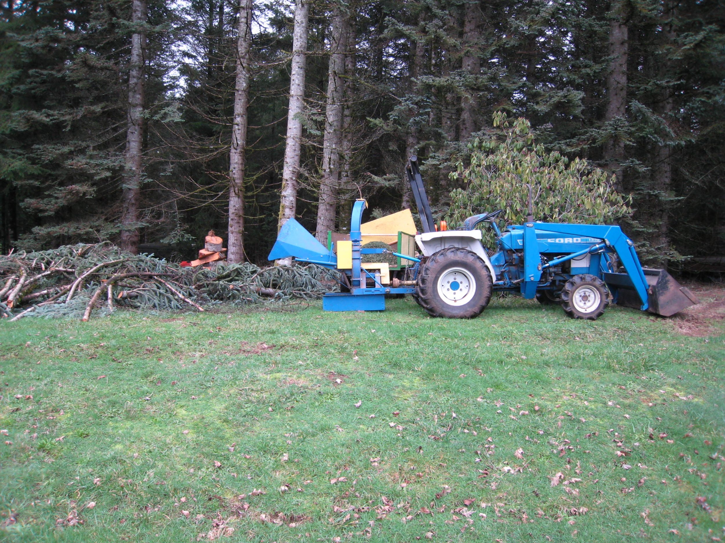

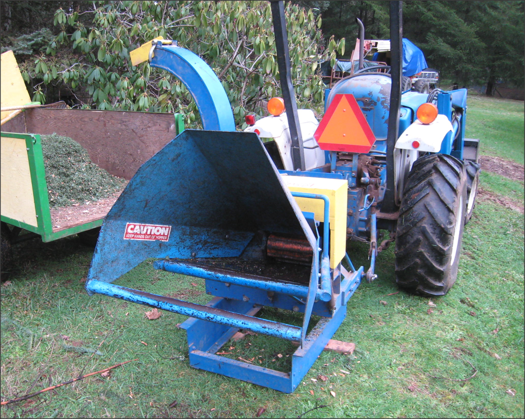

I bought used S&R ProChip about 25 years ago (no longer in business) and was just using it yesterday for fir branches.
It's a perfect match for my needs & my small (19 HP) tractor and based on my use there is no way I would buy a PTO chipper without feeder!
S&R has a mechanical drive feed which is OK, but it lacks feed roller speed adjusting unlike current chippers with hydraulic drive feeders have.
I like the Woodland Mills models features like easy opening access for service etc.
