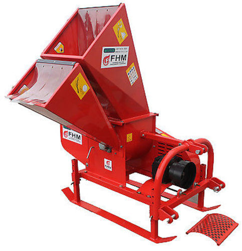

well, thanks all for all the great responses. I pulled the order trigger today on a 3" PTO Chipper/Shredder that's very similar in design to the Wallenstein BXM32 as far as blade/hammer/drum design, difference is hopper design, from what I can tell. http://www.value-leader.com/3dia-wood-chipper-1dia-shedder-cat-i-3pt-16hp-rated-fh-eco19/

Since most of my use is smaller stuff similar to what the video is running, I felt this unit would fit my needs well. Like many, anything big enough to burn in a pit or fireplace gets used that way, so I only deal with the trash left from limb'ing out trees or what falls on the ground that can't be burned.

Nice unit. However, I recommend getting a full face shield combined with ear muffs PLUS gloves that go up to near your elbow. Otherwise, you can chip naked, as I do. I also recommend getting some heater hose and cutting it up one sit to slip over the lips of all your chutes. Saves wrists and arms from being jammed against the almost sharp metal around the chutes as stuff is dragged in.
I collect leaves from the silly town people who just put them out for collection in bags. One of the leave bags had a hand pruner left in it that I somehow didn't catch when I picked up a double handful of leaves. Well, my McKissic TPH122 spit the pruner back at me. Luckily, not much damage but taught me a lesson re need for face shield and long gloves.
Love my TPH122. Its chutes are separate vs. what you have, but the shredder chute is more convenient for dribbling the leaves into it that what you have. Yours is better for chipping.
The Mac is so easy to work on. Have rotated the hammers several times. It's about a 15 minute job vs. what used to be hours on a TroyBilt that I had before it. One of the 4 bearings isn't zerk greased. That dried up and all but disappeared. It was easy to replace. You can pretty much easily disassemble the whole unit quite easily if needed. Have taken the chipper blade out 3 or 4 times and had it sharpened at a shop while I ran on a spare blade. Easy to do if you have the right allen wrench for your socket.
