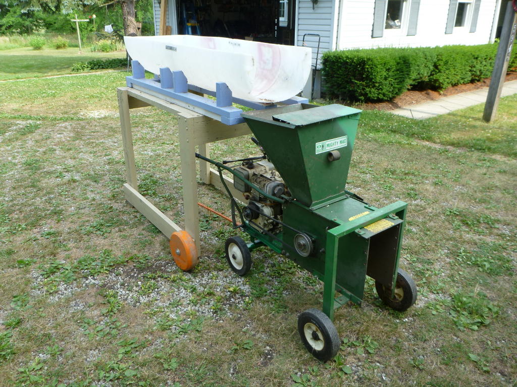

For what's it's worth... My 1984 MacKissic Mighty Mac 12p (7 hp) has served me well. Originally a "wheel barrow" type I later added front wheels and a tongue so I could pull it around with my garden tractor. Had a couple of cracks in the body to weld up. Chipper blade re-sharpened several times, replaced once. Replaced the hammers last year. Redesigned the axle at the discharge to get the axle out of the way of my shovel when clearing the shreddings. The large funnel is great for shoving in leaves as they go straight into the hammer mill. I consider making an infeed hopper almost a necessity. I load it up and feed the machine by hand which avoids clogs or overloading. The hopper shown is wide enough for my front loader to fill so saving a lot of work but still works great for filling by hand. For me, being able to fill hopper with the front loader beats having the shredder on the PTO. I will say that this machine is loud, vibrates and is potentially dangerous (probably typical of shredders) but I've chopped up all types of nasty organic material and chipped many a branch. I use a 1 lnch screen or a bar screen for most things and sometimes no screen for wet clumpy leaves that tend to clog.
Ken Louisville, Oh
If I go with a stationary unit, this will definitely be considered, thanks Ken M for taking the time to show your improvements.
