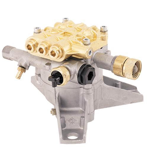

This is the picture from the sears web site for the Craftsman Pump Saver. Can anyone explain what I'm seeing in this picture and how it works?
