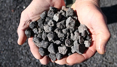

I'm still looking at what is available. The coal ash cinders I use now vary in size from fly ash up to 1/2'.

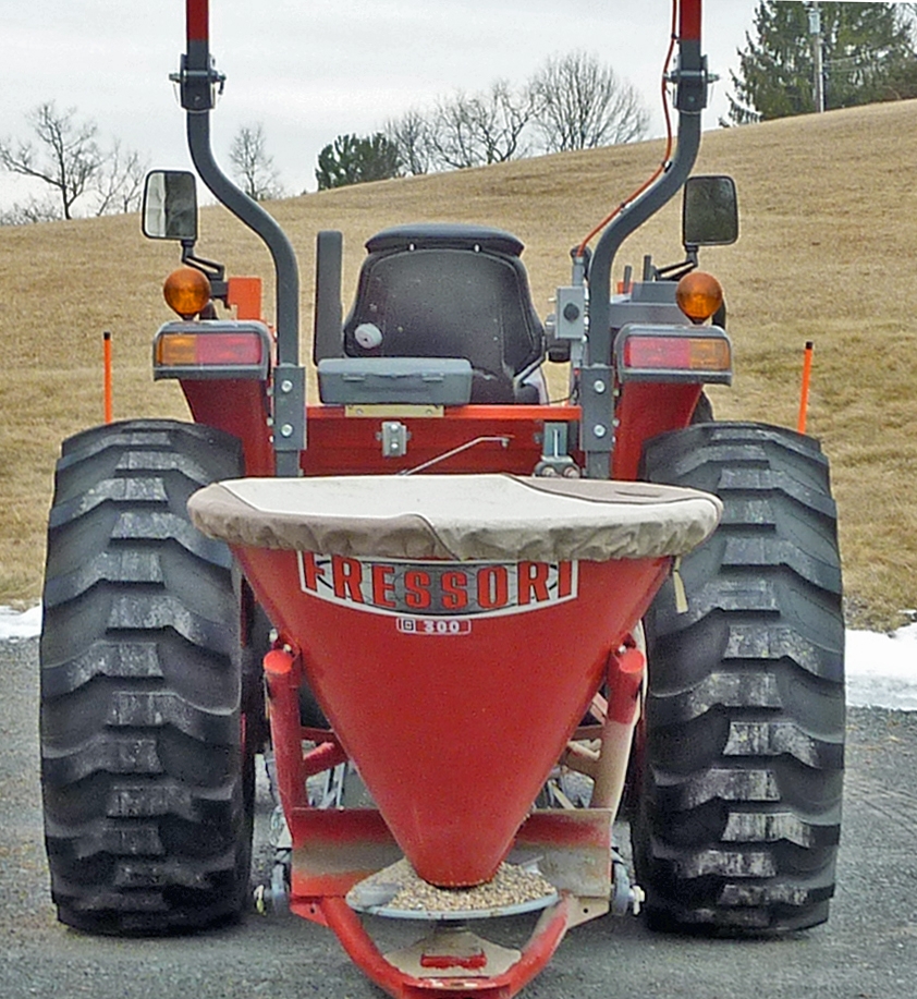

You can see the spreader in my avatar picture but here's a better view:
I'm also concerned about weight. The 3pt will lift over a ton but I'm not sure about the weight limit on the ag spreader. It's designed for seed & fertilizer, not heavy material.
I've been using a spreader of that design for almost 10 years for gravel antiskid with no issues. It should be fine. You can get or make a limiter for the spreading disk to confine it from being thrown so far.

To limit the spread pattern, I spin it with a hydraulic motor instead of the PTO. That way. I can control the speed using a rear remote. I also removed 2 of the 4 cups from the spreader disk.
My biggest concern is the weight. The cone, filled with fine gravel, would weigh over 2000# I'm not sure the Fressori spreader is designed to handle that much weight.
IDK, I'd say fertilizer and Lime must be pretty close to the same density; I'd actually think it might be heavier, an 80# bag of fertilizer doesn't occupy a very large volume.
I've filled mine heaping full with antiskid with no issues.
