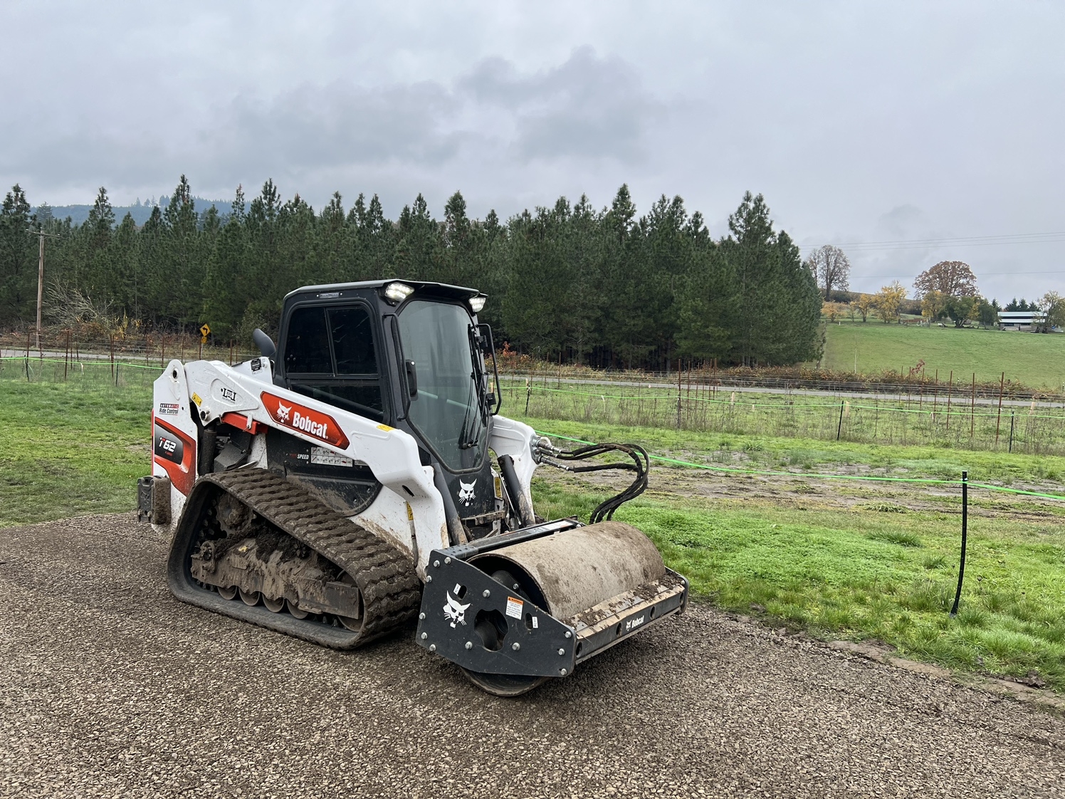

Over the years I’ve used a number of things to grade gravel roads. My go to now is my tracked skidsteer with a tilt tatch and typically my tooth bucket. This setup is heavy enough to break through the hard packed gravel as well as establish a crown on a formerly flat graded road. I have a landplane I use as well but the bulk of the work is done with the bucket. Once grade is set I lock it in place with a vibratory roller. I use this setup commercially but it’s been a game changer for grading.
