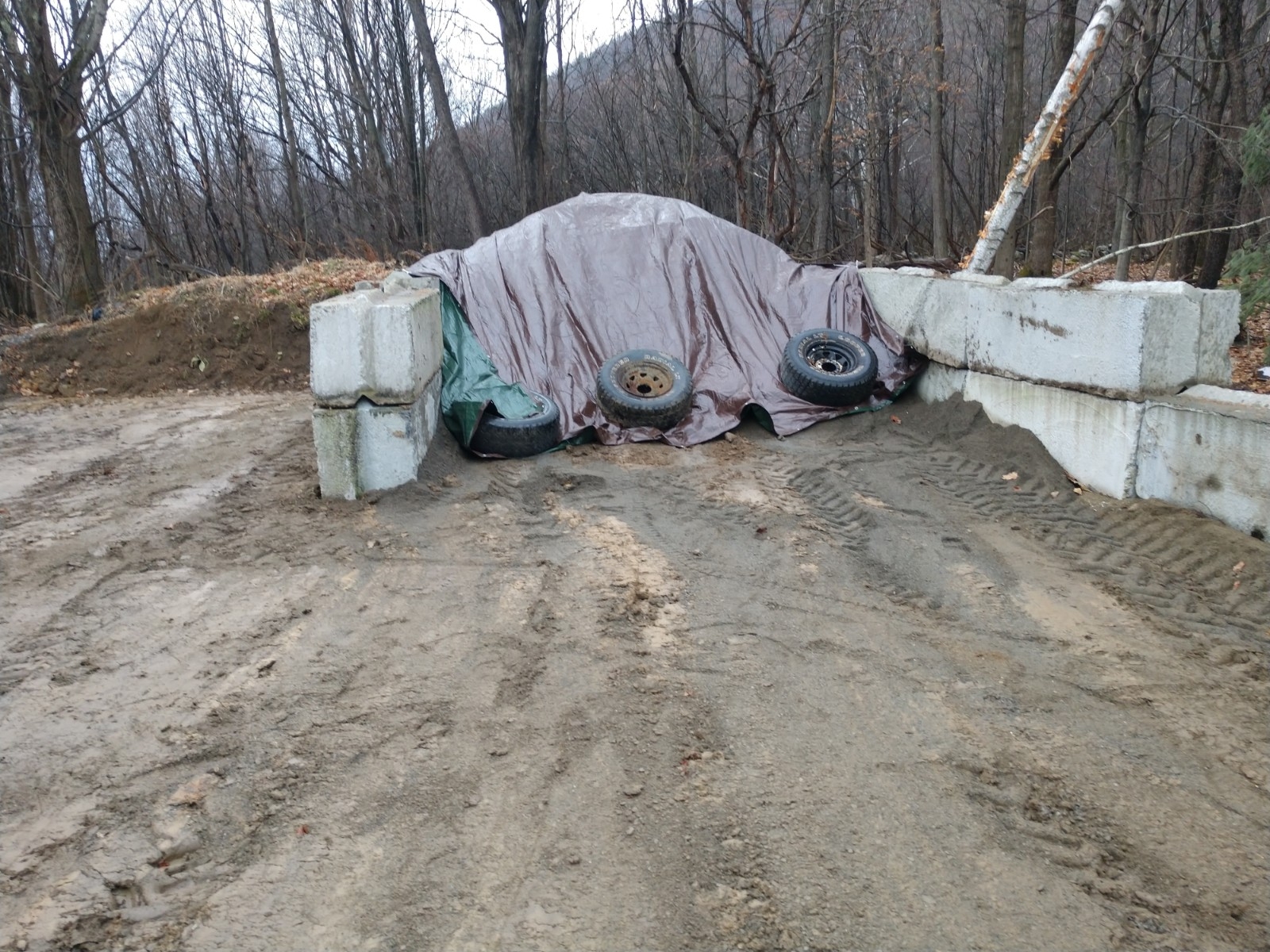

There are four property owners that share maintenance expenses on our 1.25 mile, very steep private road. We all share the plowing chores but I'm the only one with a spreader. Right now, two of us burn coal and I spread ash when the road gets slick. Yeah, I know, coal ash is considered toxic but we handle it as such using a cabbed tractor, masks, gloves and goggles. There have been no issues during the 40 years we've been using it.
The two of us with coal stoves are switching to heat pumps this year and the coal ash will no longer be available. In the past, I've experimented with various aggregates but they are expensive and difficult to store. If stored in a pile outdoors, it freezes up and gets covered with snow which makes tarp covers difficult to remove. After fighting to remove the cover, sand, cinders & fine gravel have to be broken up with a hammer. The chunks then get caught in the modified ag spreader I use. Mixing with calcium or rock salt helps but it's expensive and difficult to effectively mix with the aggregate.
Right now, we store the lightweight ash in 30 gal cans which are weather resistant and can be dumped into the spreader. Heavier aggregate needs to be loaded with a shovel. I know this doesn't sound like a big deal for many but the youngest property owner is 70 and the oldest is 85.
I realize this topic has been discussed many times but I keep hoping for some new ideas, tricks or equipment.
For those who maintain private roads, what aggregate do you use and how do you store & spread it?
In my area the highway department uses mostly fine crushed volcanic cinders or sand. If cinders aren’t available in your area, maybe consider crusher fines.

Since I live in Florida and haven’t had any ice problems since about 1982 in Ohio I’ll state this solution in the form of a question.
One of the smaller, old-fashioned side drop grain wagons could be filled with sand, cinders or any other suitable agent in the warm weather. The wagon could be easily covered to keep the contents, dry and easily offloaded and placed in the spreader.
Might be a possible to position the wagon, so the spreader could be filled directly from the wagon.
It would also be possible to dump the sand into the front end loader, bucket of a neighbors, tractor, and in turn dump it into the spreader. Without seeing the spreader, one might need to box in the front and loader bucket, so that it is narrowed enough to allow the sand to be dropped into the spreader without spilling. Or one of the stump digging buckets could dump directly into the spreader.
This would require some capital investment. But I think it would also minimize the manual labor required to keep your road open.

Right now, the plan is to use a storage container for the aggregate and load the AG spreader with the FEL bucket on my other tractor. I'll see if I can find a narrow SSQA bucket to make loading easier.

I'm still looking at what is available. The coal ash cinders I use now vary in size from fly ash up to 1/2'.
You can see the spreader in my avatar picture but here's a better view:
I'm also concerned about weight. The 3pt will lift over a ton but I'm not sure about the weight limit on the ag spreader. It's designed for seed & fertilizer, not heavy material.
   / Winter Maintenance on Slippery Private Roads #40
The smallest VICON or the HERD scoop spreader on the rear would work.
