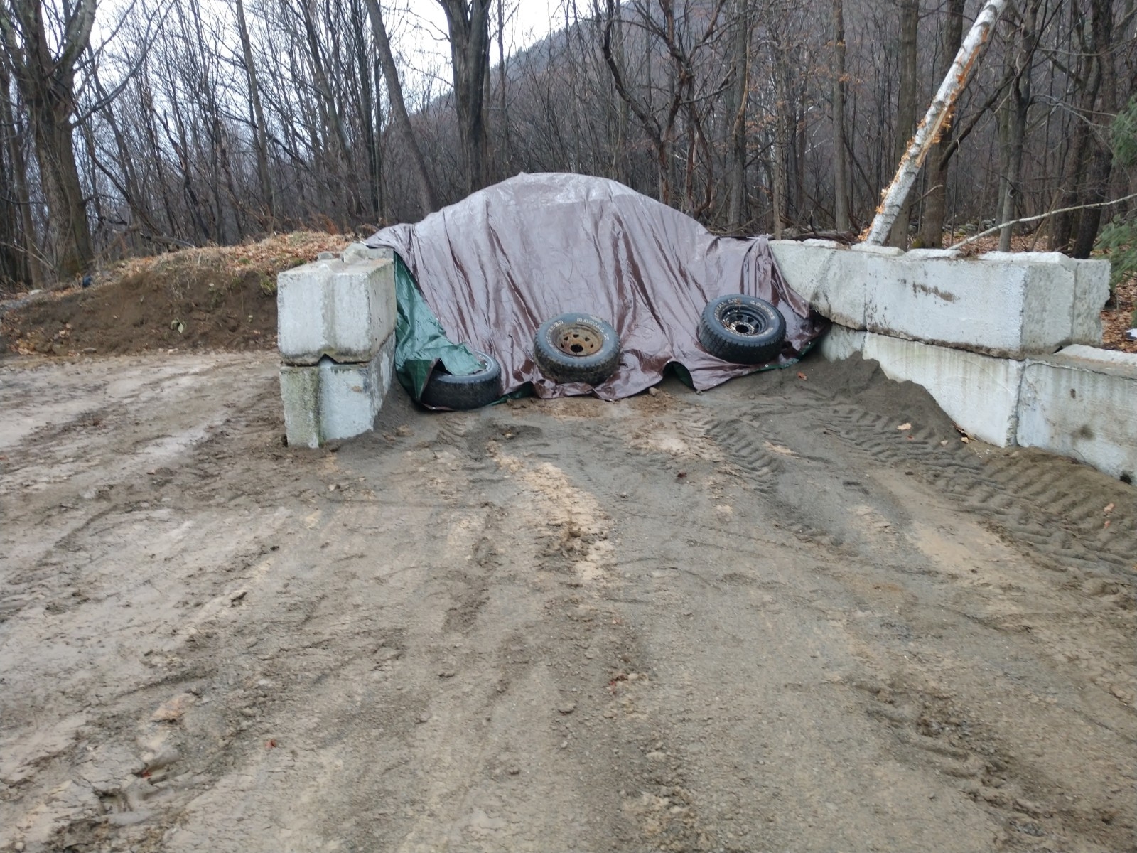

I buy a tri-axle of salted sand every couple of years, I have a bunker to store it in and I tarp it over.
This coming year I want to revamp it and make it a bit narrower then put one of the canvas garages on it.

Damn, Lou
You in some STEEP country.
