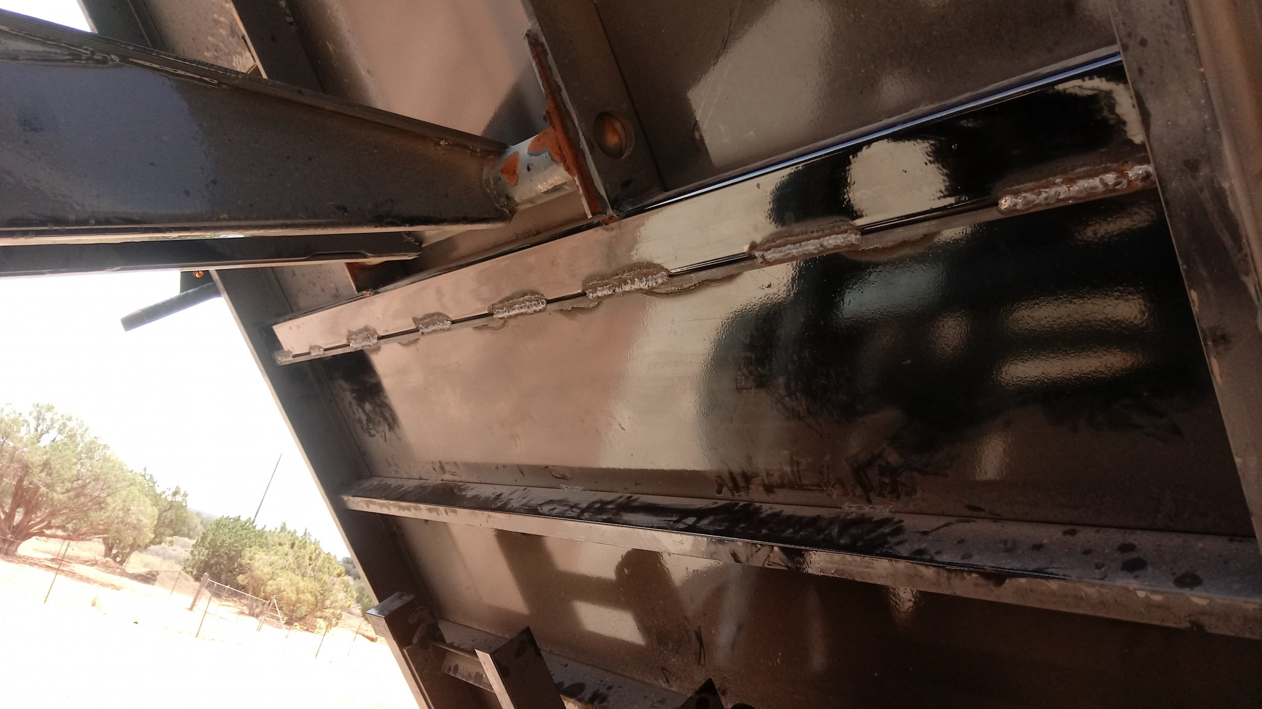

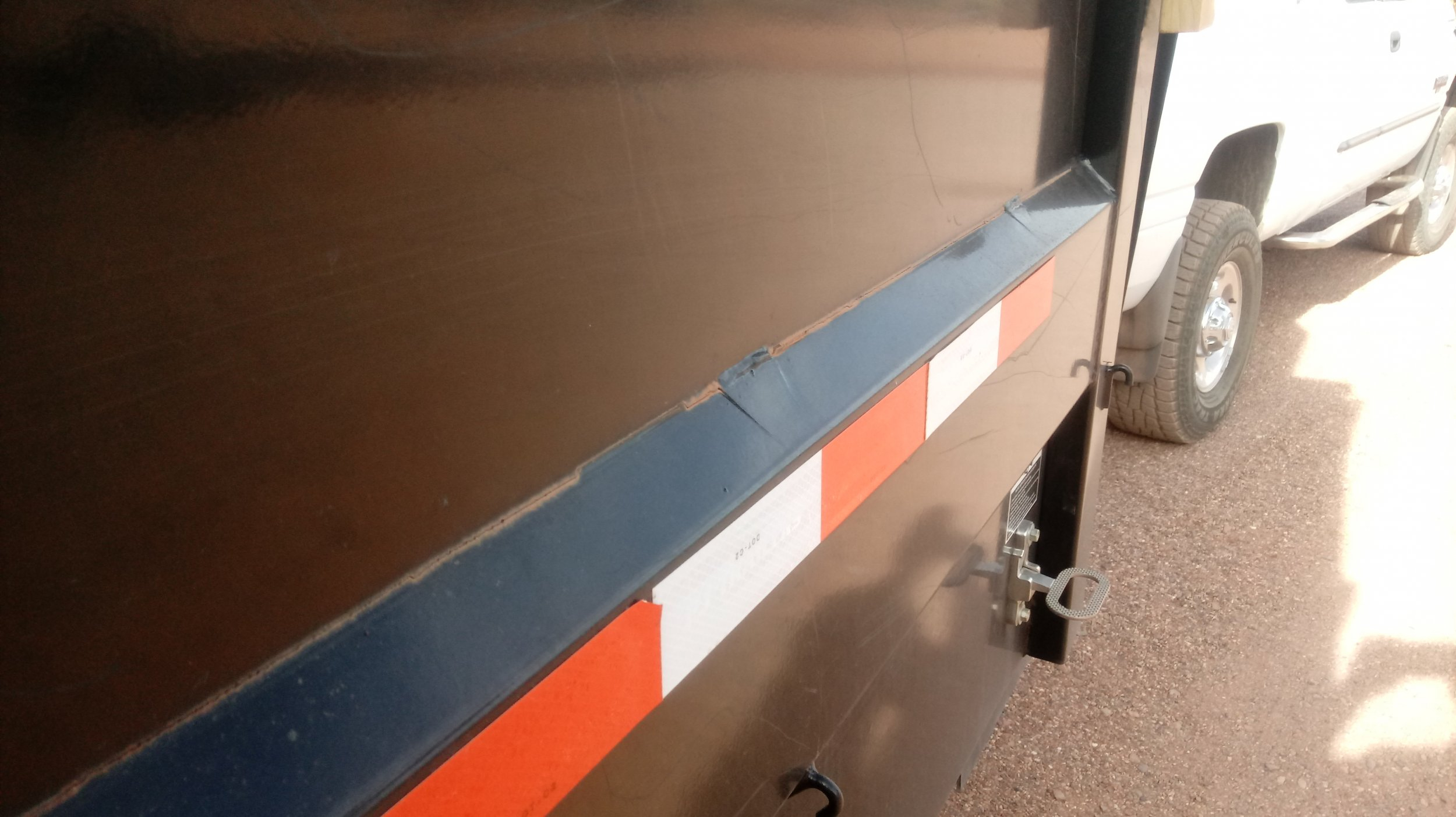

About 95% lol, there are always a few cons. Mine is the DE model, pre DER like you posted. The difference is the horizontal side stiffener. Mine is a weld on piece, the DER is built into the sides as a one piece. Mine has cracked by the welds, I will post a picture. Also, I don't like the jacks welded on inside of the tool box, the Load Trail is way better, with bolt on.

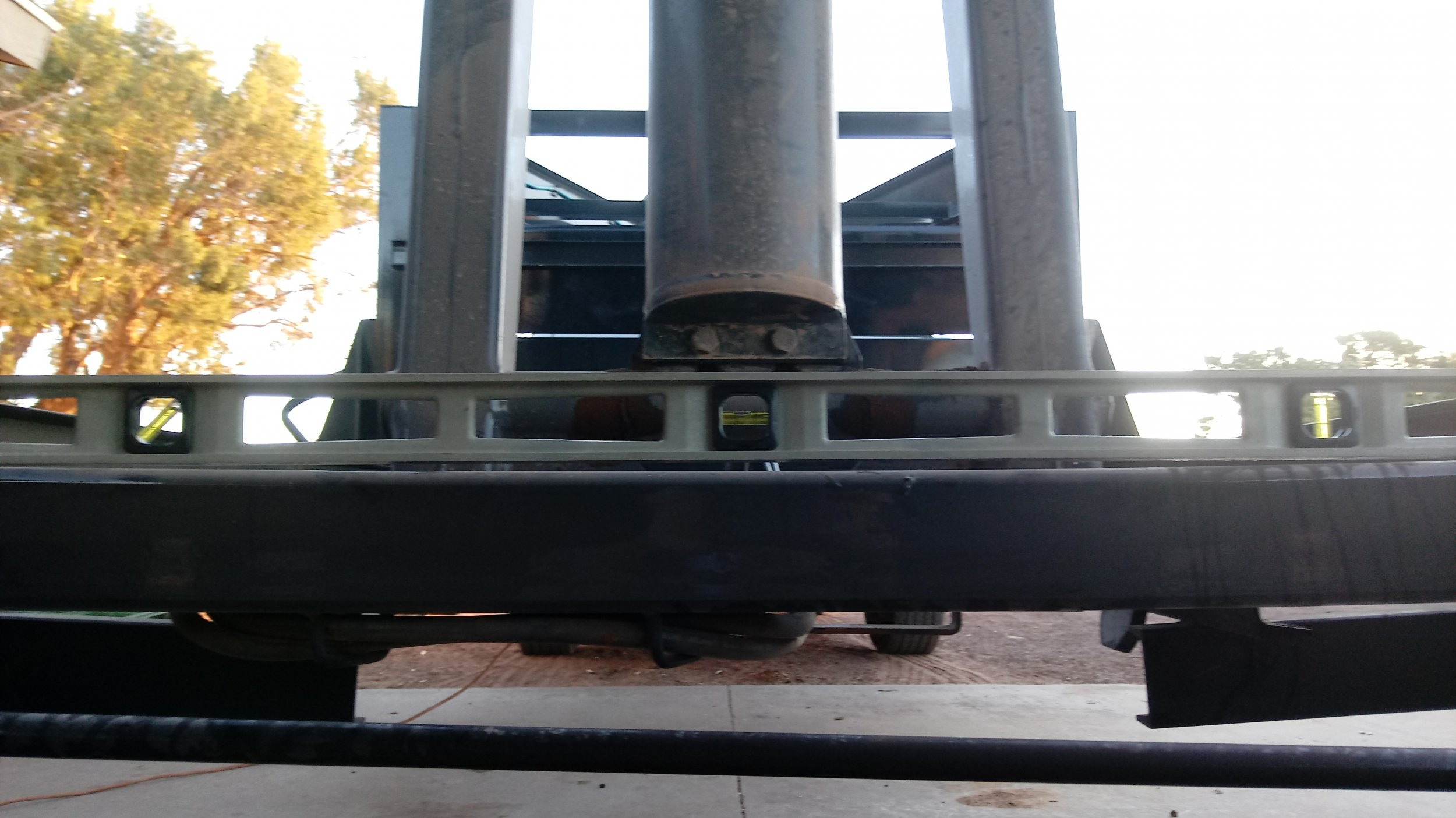

What I don't like about my Lamar is the lift is too far back, that makes it weak. The PJ has the lift about 2 feet farther forward. It will always dump, not so with the Lamar. I also had an issue with the bottom mount for the lift, it was weak also. I think they have fixed that. Those are the only issues I can think of, it is a good trailer in spite of that. Between the two you posted I would go with the PJ, only because of the tri axle 7's. I really like the looks of the Load Trail I posted. Picture of the bottom mount. They paid me to fix it. Also some cracks on the front of the bed, both sides.
   / Who owns a triple 7k axle equipped trailer? #36

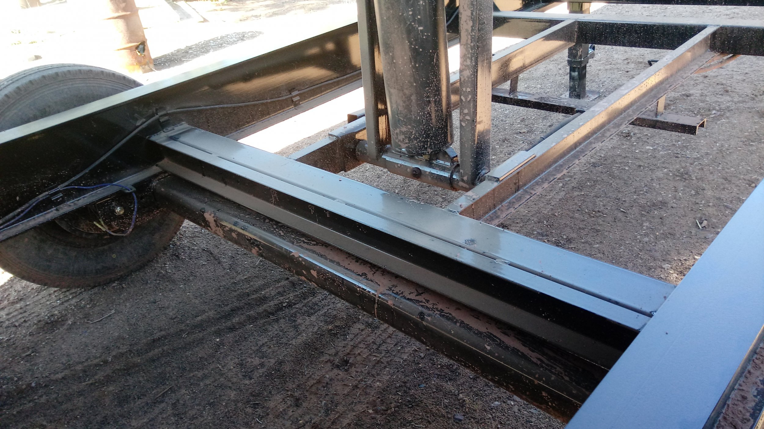

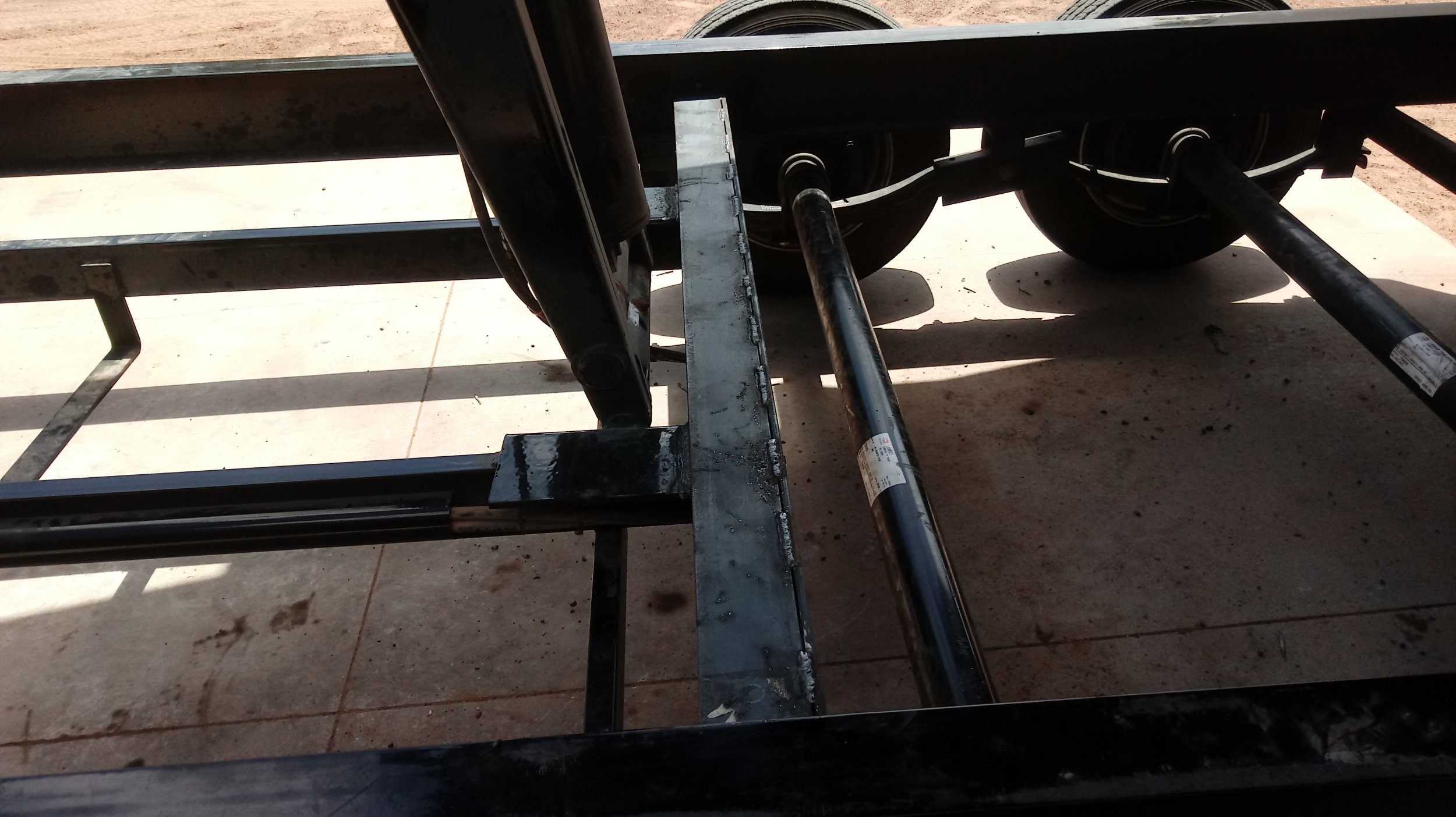

If the Lamar still has the lift centered in the bed, I would not buy another one. It needs to be where the PJ is. Here is my fix and a picture of the PJ mount, very similar. The Lamar is 3/16"x3.5", the PJ is 3/16" x 4" with a 4" channel back up.
PJ mount, first picture and the repair on the Lamar, top and bottom.
