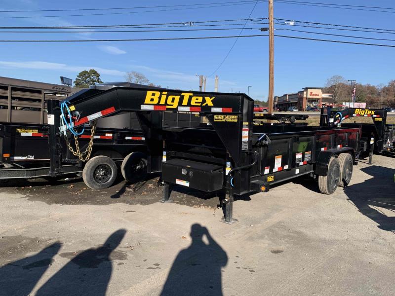

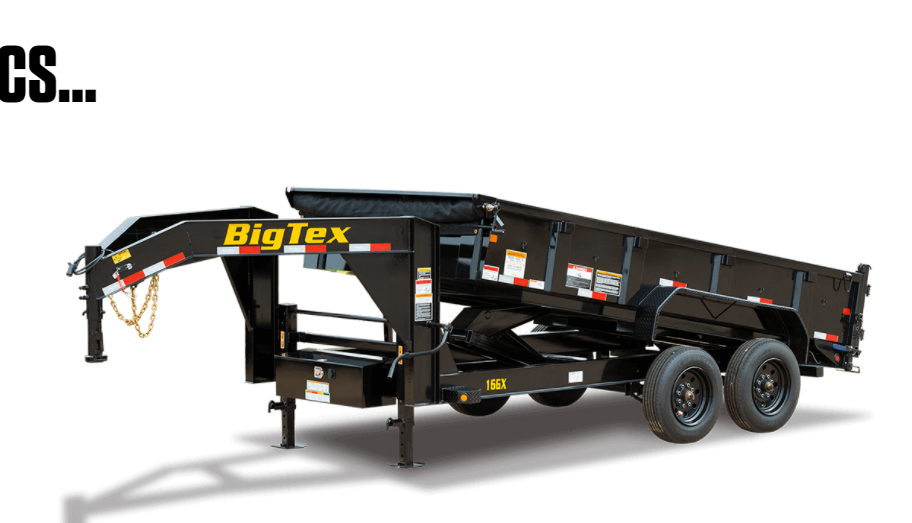

found one for $18,600

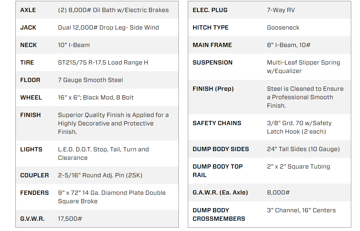

Just noticed the axles are a little light for what you want.
10k axles jump the price up to $22,700 ouch.

Bunch of those Big Tex’s around.
The problem with Big Tex is they use 10GA floor and 12GA sides.
I need 7GA so I can drop logs or rocky soil in without denting the floor.
Can’t find dual tandem with thick steel floor, low sides and 24,000 GVWR or more.
