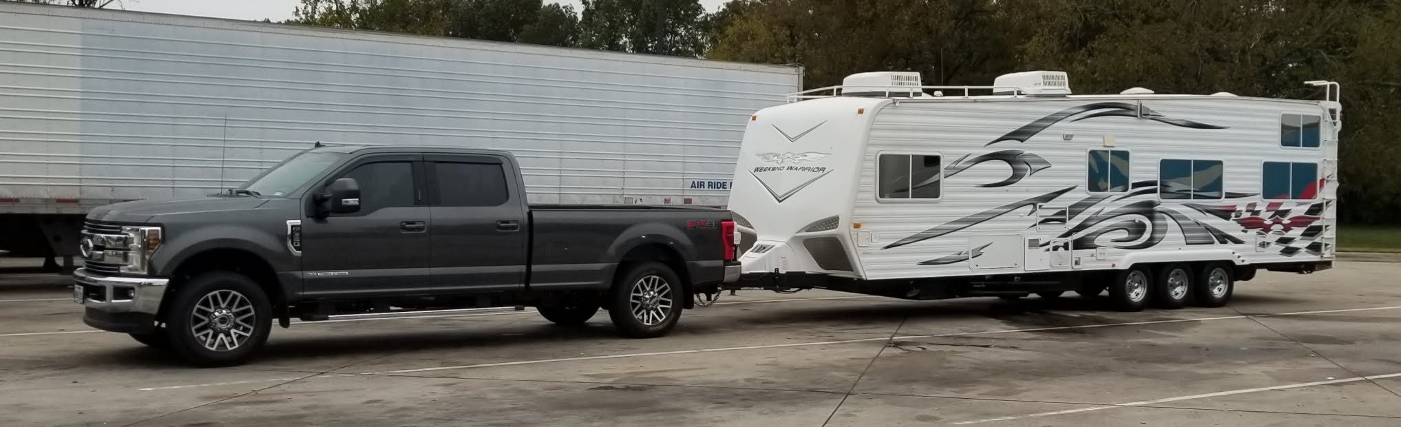

These trailers seem to get a bad rap for the front axle getting tore up on tight turns. Seems plausible if not handled correctly (turned too sharply, especially loaded).
Anyone own one? Any who does own one have issues with front axle?
If equipped with 14ply tires, any additional reasons to avoid triple 7’s?

I just got done servicing 2 dozen trailers at work and we only have 2 tri axles left. The bearings get loose faster and the tires wear drastically quicker. I even had to weld up a spring hanger on the back axle that tore off from side loading. I'd say they would be fine for lots of highway mileage but i'd steer clear if you're using them a bunch locally. If you really need the load capacity, i'd go for a 20k tandem axle with singles or a deckover with duals. Ive also been in the truck with a guy when our tri axle hydroseeder almost pushed the rear axle of the truck out sideways because he hit a some lose gravel turning on to a dirt road. They definitely want to go straight.

I don't have an issue with the tri-axle on our 30' Weekend Warrior Toy Hauler. It has 6k axles but has only weighed 15K at the most when loaded with provisions and the TJ. I don't turn very sharp with it though and it is very stable on the hiway.
