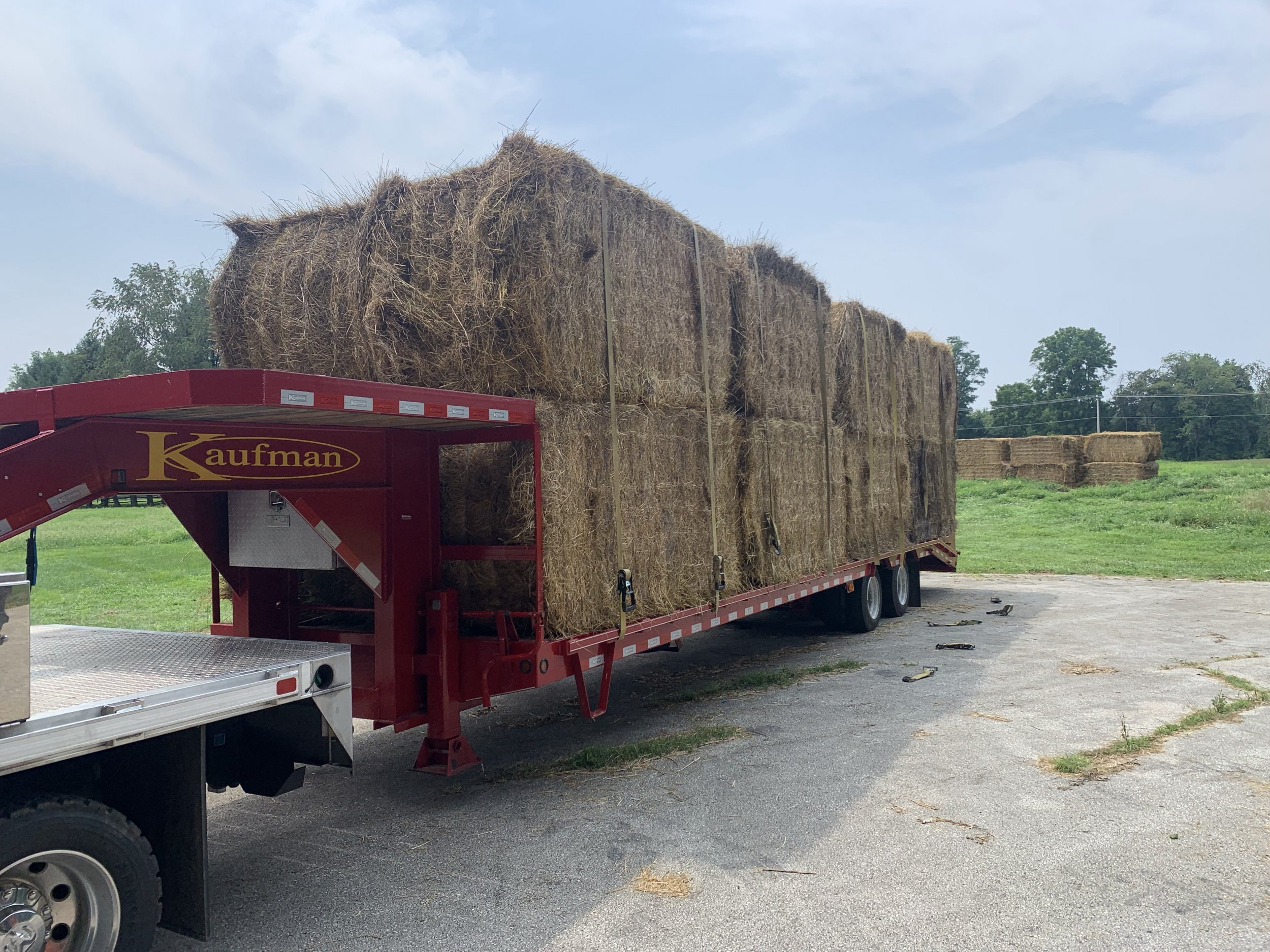

Are you hauling hay? Reason I ask is, my buddy hauls hay with a goose neck currently. He loads up to 17 round bales at a time and hauls them usually within 30 miles or less. Before the price of diesel went through the roof, he was considering one of the new type trailers that haul only about 10 bales, but when you get to where your delivering, you just pull a lever and they all roll off the side and you don't have to wait for someone to unload.
Yeah. Already have dual tandem hay trailer I’m satisfied with.

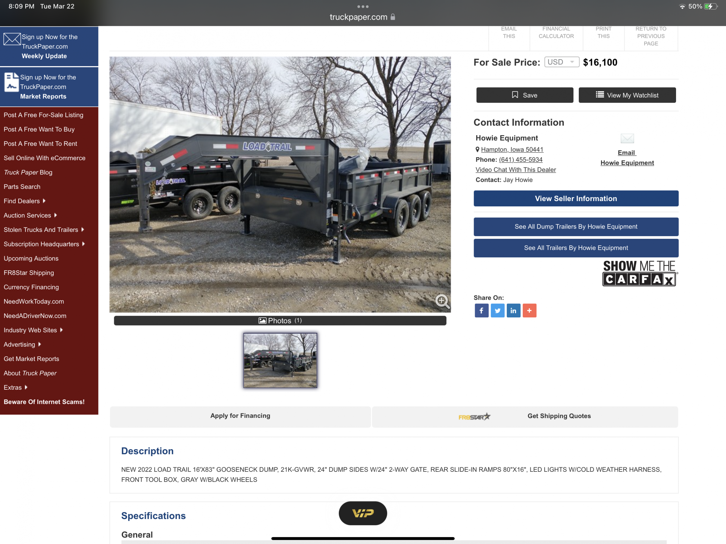

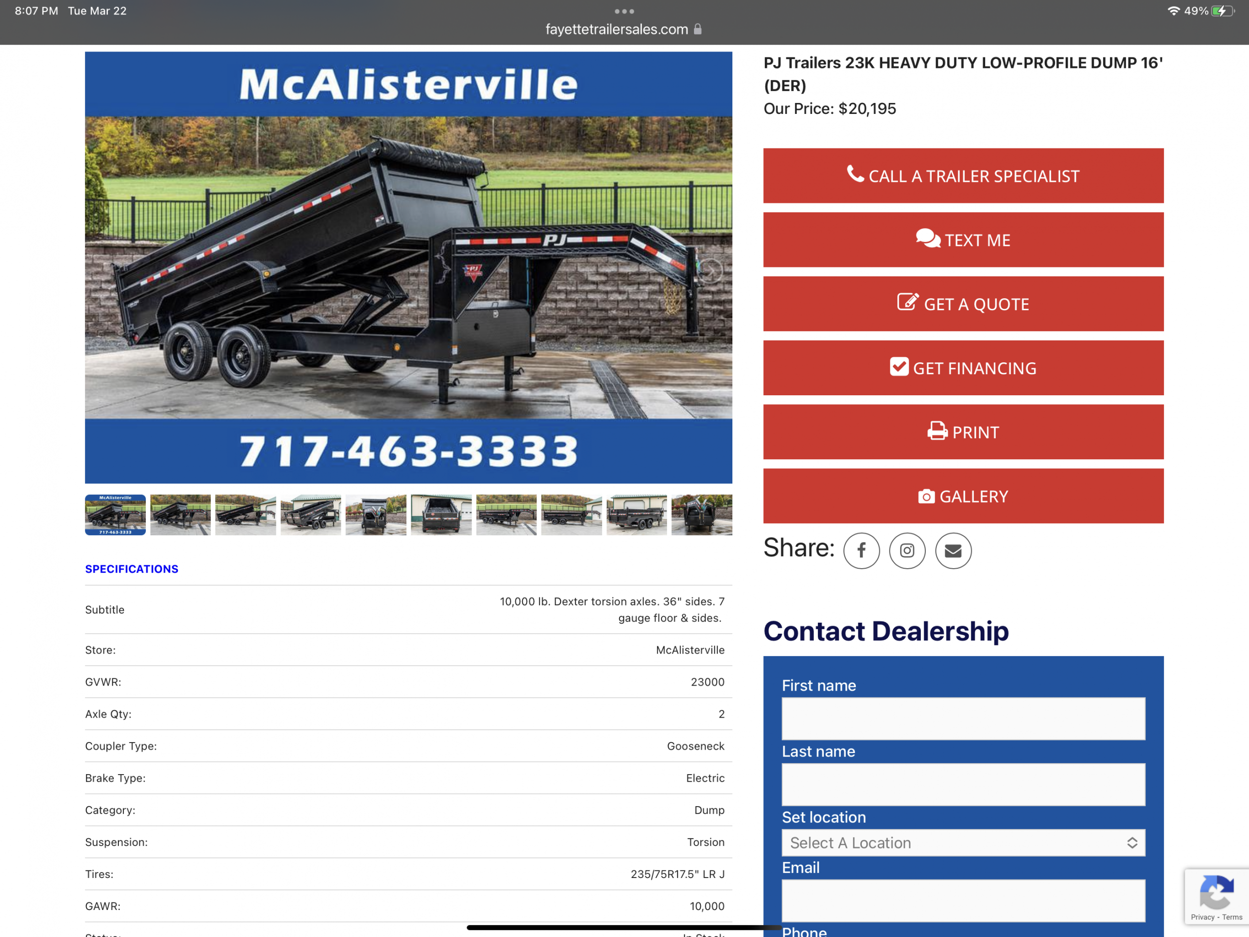

2 fairly comparable trailers.
1. 21,000lb triple 7k Lamar with all 7ga steel. Would be equipped with load range G tires.
2. 22,000lb PJ (2) 10k torsion axles with 235/17.5 super singles. All 7GA steel.
The Lamar trailer in the picture is a representative photo. Theres a similar Lamar near me and the price is $18,500.
Im not super comfortable with either trailer, but I really cant find anything much heavier built without less than 3’ tall sides. No duallies with low sides, which is really what I want. Only Midsota seems to make them and they want 30 grand lol
Ordering is a 3 month wait and the prices are 25% higher on anything custom.

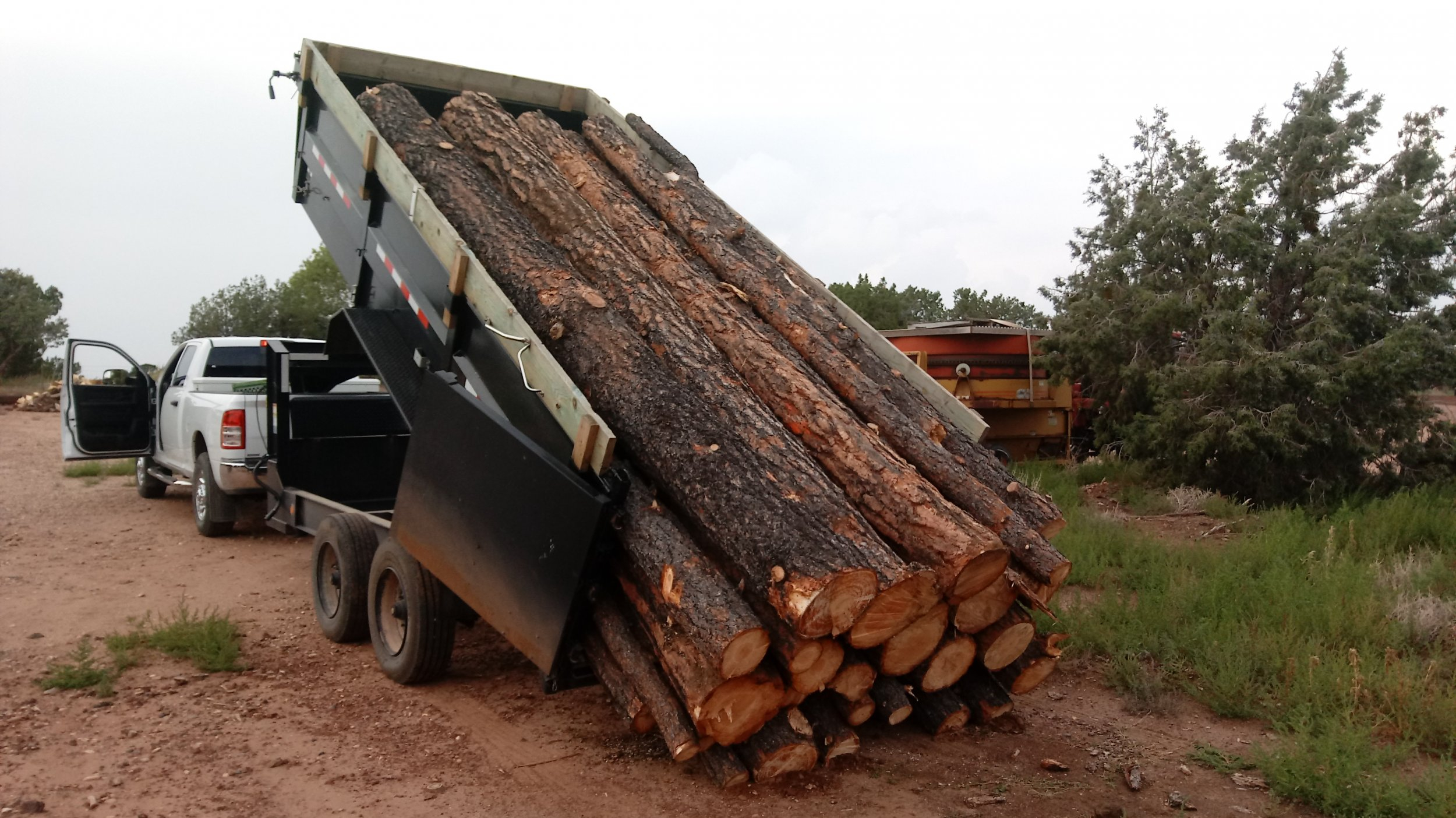

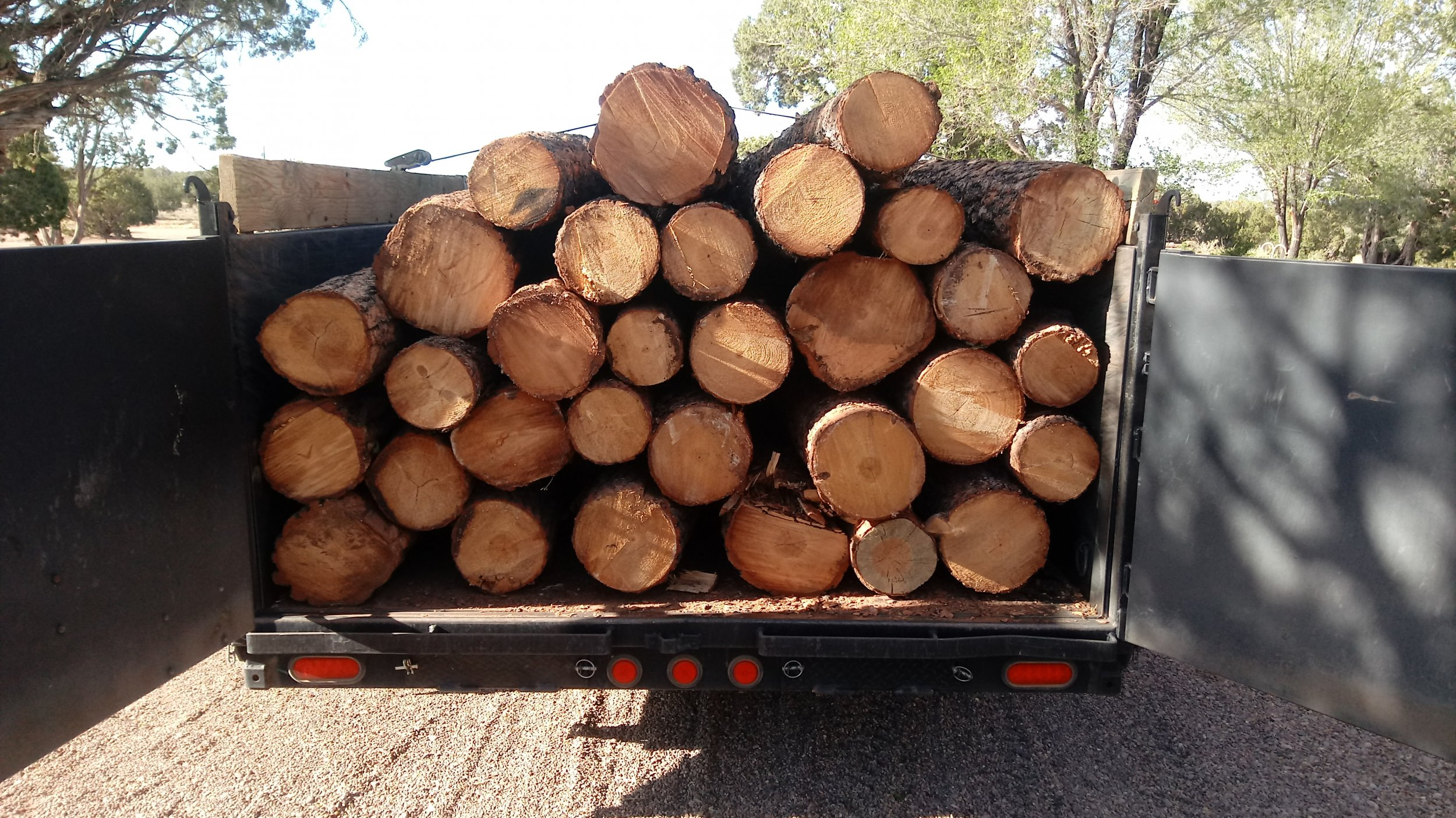

I think either one would make you a good trailer. I have the PJ like pictured. I also haul a lot of logs and the 3' sides are not an issue. My son loads me with an excavator and I use my Bobcat loader with forks. If you get a really large log and don't want to drop it, I load from the rear. Just set one end in the back and slide it in.
