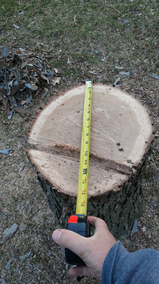

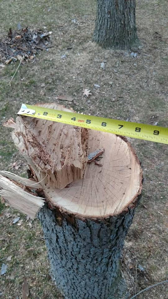

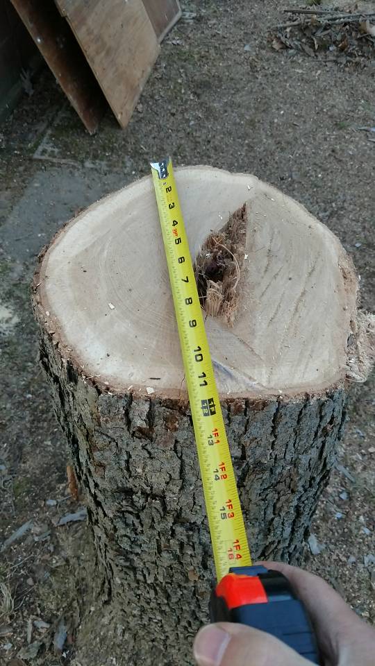

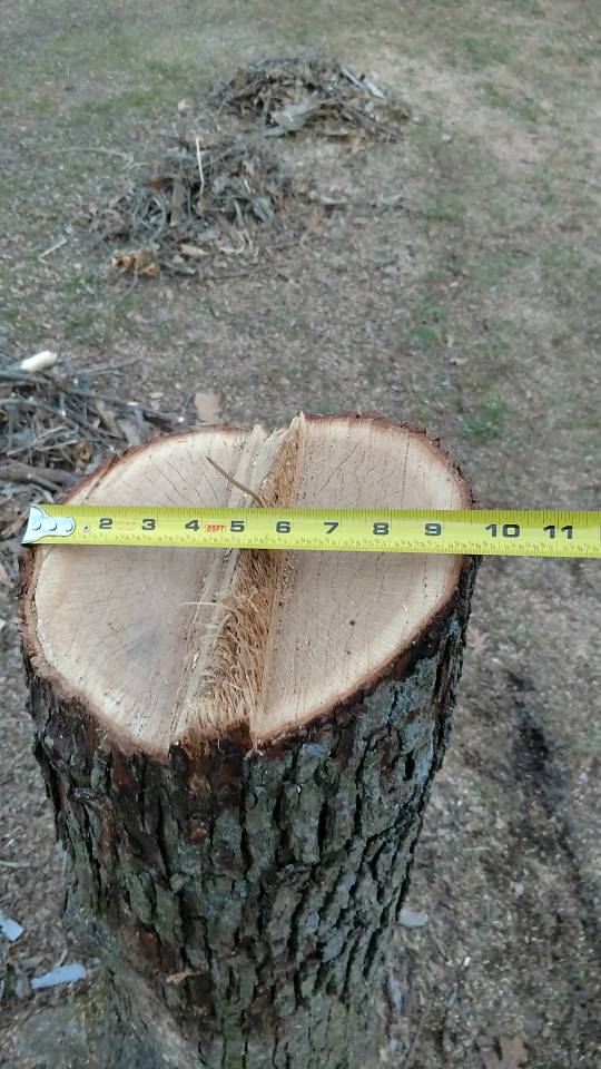

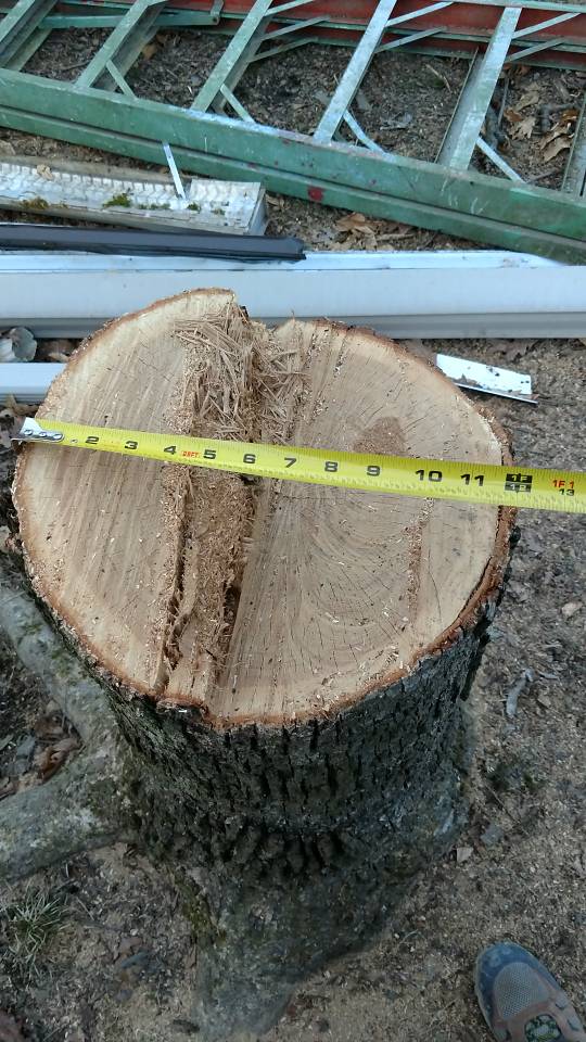

A neighbor is asking me about removing some white oaks that he had cut, he wants the root balls removed, not ground down. I implored him to call in a tree grinder guy, but he says that he's done it before and it brings insects and eventually sink holes. He is dead set on digging the balls out.
So, I have B2650 TLB and the request is that I dig them around, cut the roots, and get the balls out on the 5 trees. These are white oak, so there is some sort of a tap root sticking down in the center.
I told him I'd give it a go, start with the smallest tree and work up from there if it looks like I can do it.
My thoughts are, dig a V shaped moat around the base, picking at it to expose the major roots. Use my DeWalt reciprocating saw with timber trimming blades to cut the roots as I scratch the dirt away, get enough cut that I can get on the otherwise and push it... Hopefully getting the saw to the tap root. Then they should roll right on out.
I told him I wouldn't do it free, but I wouldn't charge much, I also told him that I'd think 7 hours for sure to do 5 roots, but it is what it is. A tried again to suggest a grinder, he's pretty dead set on digging, not grinding.
Am I insane for even thinking that this can be done with a BH77 on a B2650?

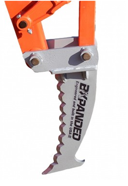

You have such a great neighbor!!! Now you have the perfect opportunity to purchase a BH77 Ripper Tooth! Have your neighbor pay for it! : )

Now there is the right idea! I have a ripper tooth, and I would not even try to dig a stump out without one.

With that ripper claw from BXPANDED, wouldn't you end up needing to swap from claw to bucket? Your not actually removing any material with that thing, your turning the backhoe into a razor knife with it.
I assume you jam the knife in, slice and dice real nice and then go to the bucket to remove the debris. Then go back to that knife and start over, but going another layer deeper?
