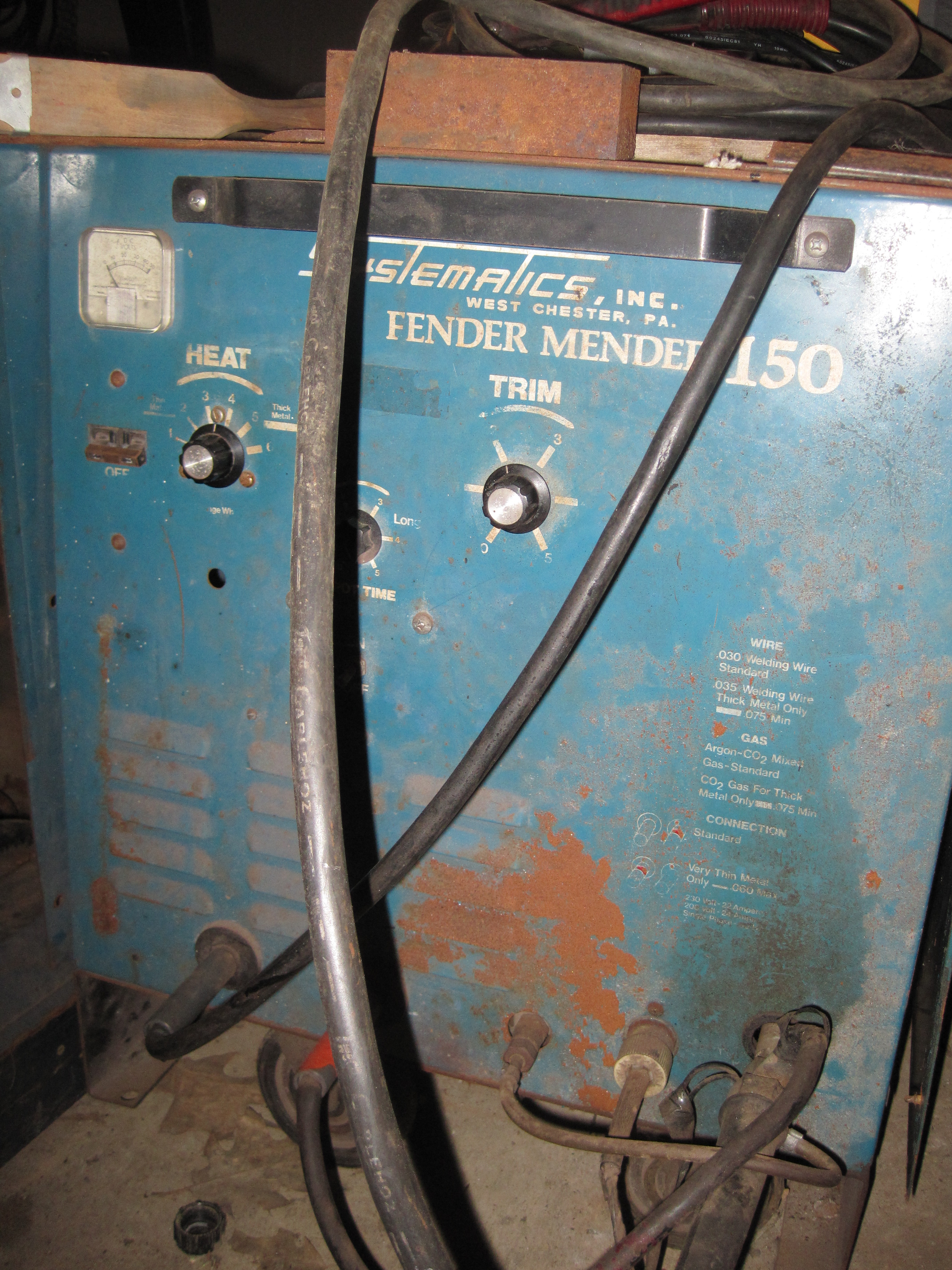

I am in the market for a new welder. I have MIG welded on and off for 25 years, always with wonky over-worn machines. The latest is a 1970's MIG my FIL gave me before he passed. The feed controls, amperage setting, and gun are all problematic and any welding I do now has about a 20% chance of being problem free. I will give this one away to a hardworking smart young man who works for me. He will get it running well enough.
I want to get a wire feed welder MIG/flux-core. Because of tank-certification dance I am inclined to stick with flux-core at this point in time. Portability is not a priority. Dual 120/240 V is not a priority; 240 V will be fine. I required 3/8" mild steel in a single pass but like the idea of 1/2" in a single pass. My usage is as a landowner, maintaining tractors, implements, trailers, and fabrication. I am hardly ever in a hurry when welding so throughput is not a concern. I am not likely to want to weld aluminum, convert to TIG, or add a spool gun.
