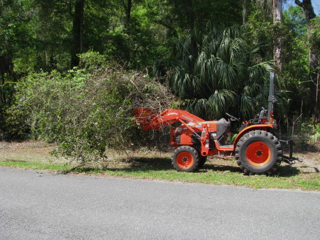

At this second I am leaning toward the Hay King C-3 Renovator for vine and root removal. Then continuing to use my well tested Ratchet Rake on the FEL bucket to pile exhumed vines. Ratchet Rake is pictured in Post #1, Photo #2. Debris transport to burn pile via my FEL clamp-on aluminum Debris Forks.
Just one new implement, the Hay King Renovator.

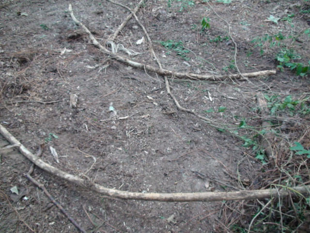

The grape vine roots I am dealing with do not put out side filaments. Vines slowly taper, then may branch at the ends, but without holding/filament side shoots they free from sandy-loam relatively easily. Even so, I do plenty of cutting sections free from the dirt with loppers. If you look at Photo #1, Post #1, you can see where my ROBB has surfaced a box blade width of vines.
The soil was perfect that one day. I need something that will work on imperfect days too, hopefully faster. I think the shape and angle of the box blade rippers is the problem. Good for cutting to the bottom of pot holes, not so good as an ersatz chisel plow.
