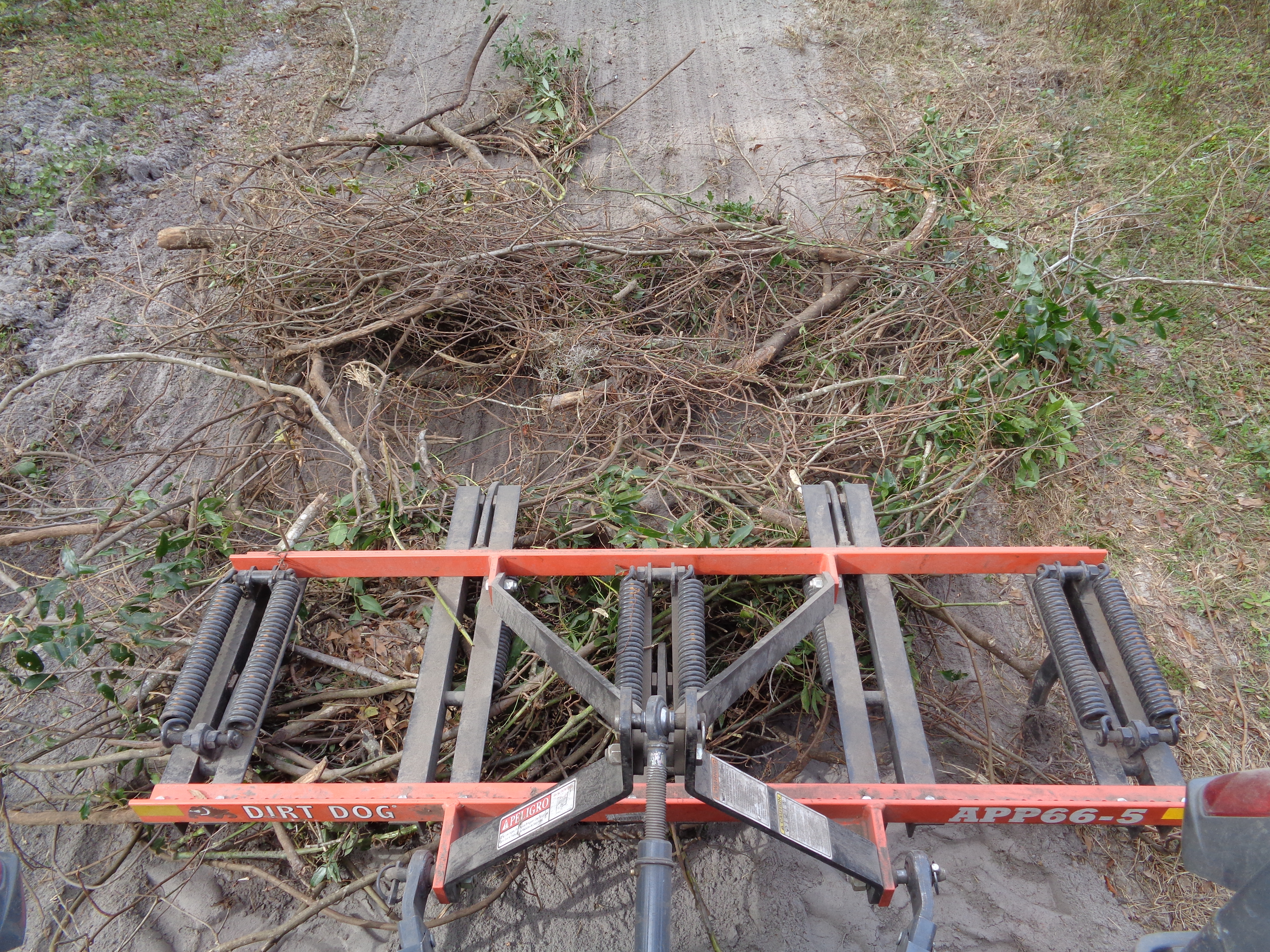

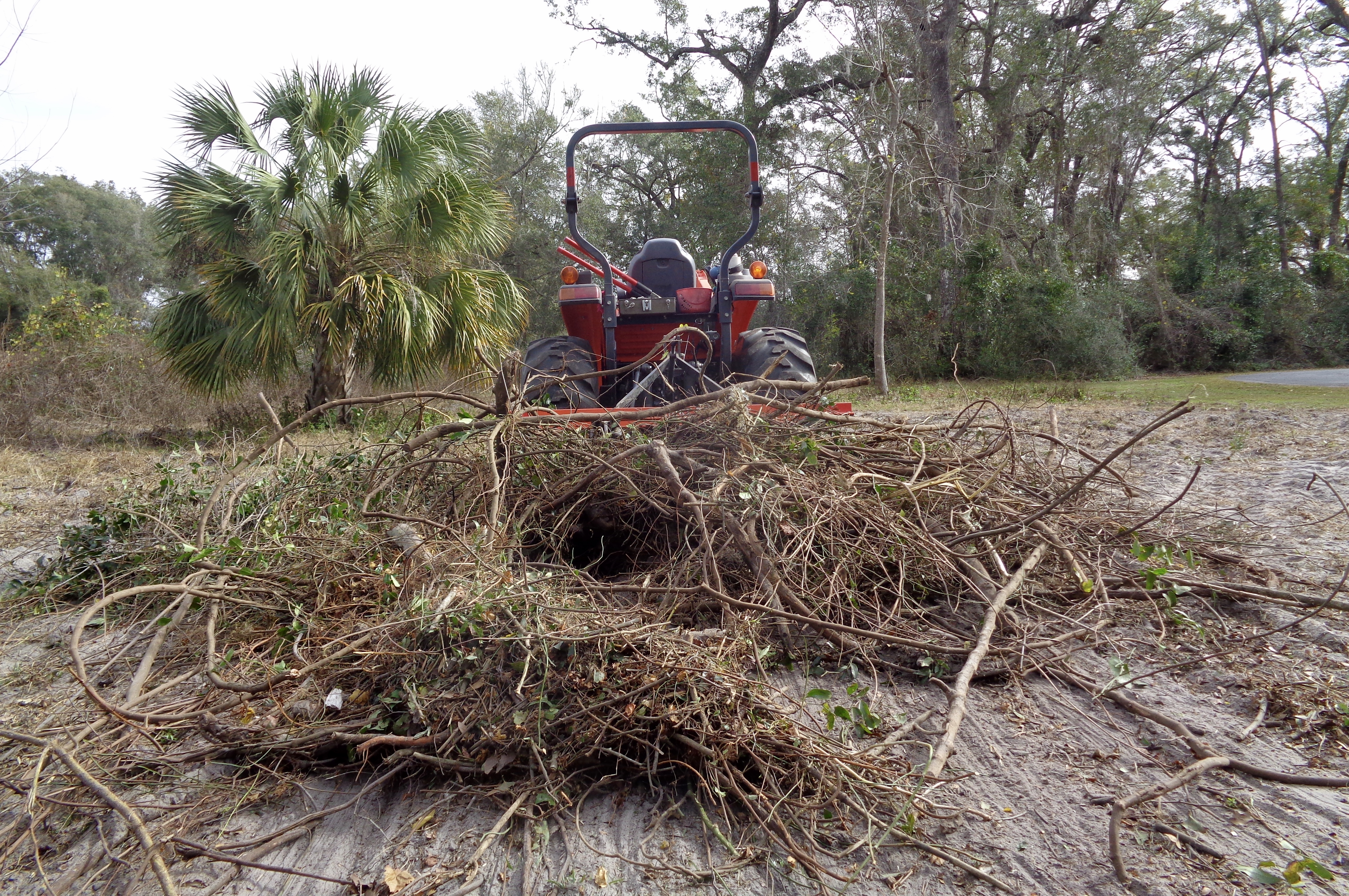

April 2017 pictures.

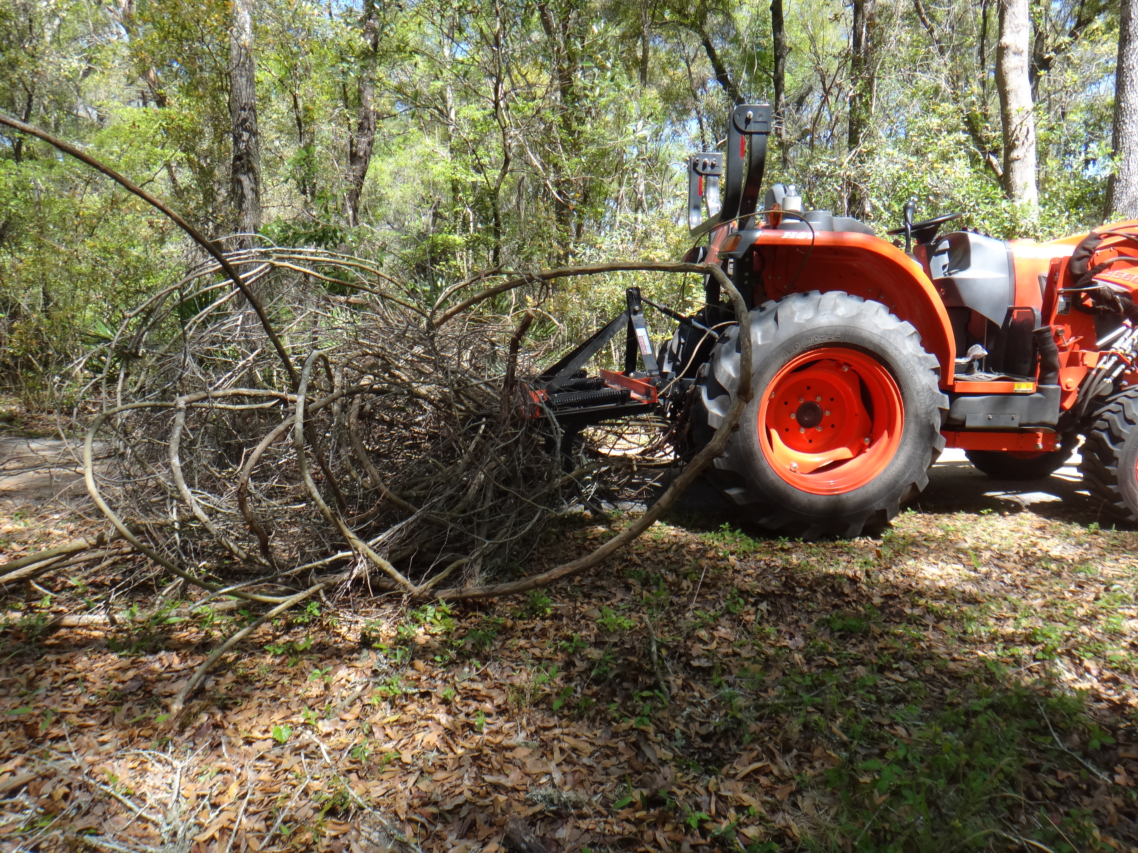

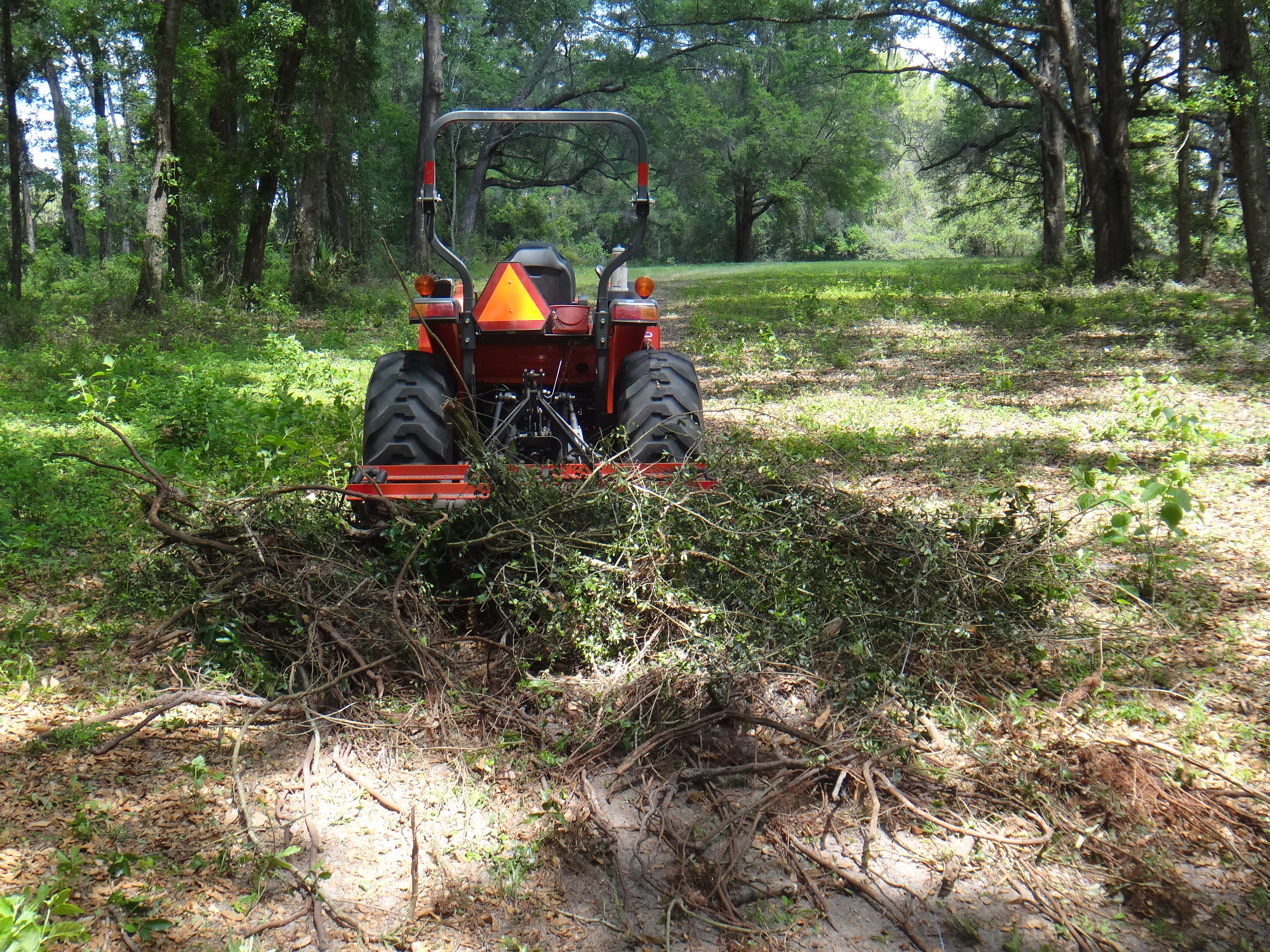

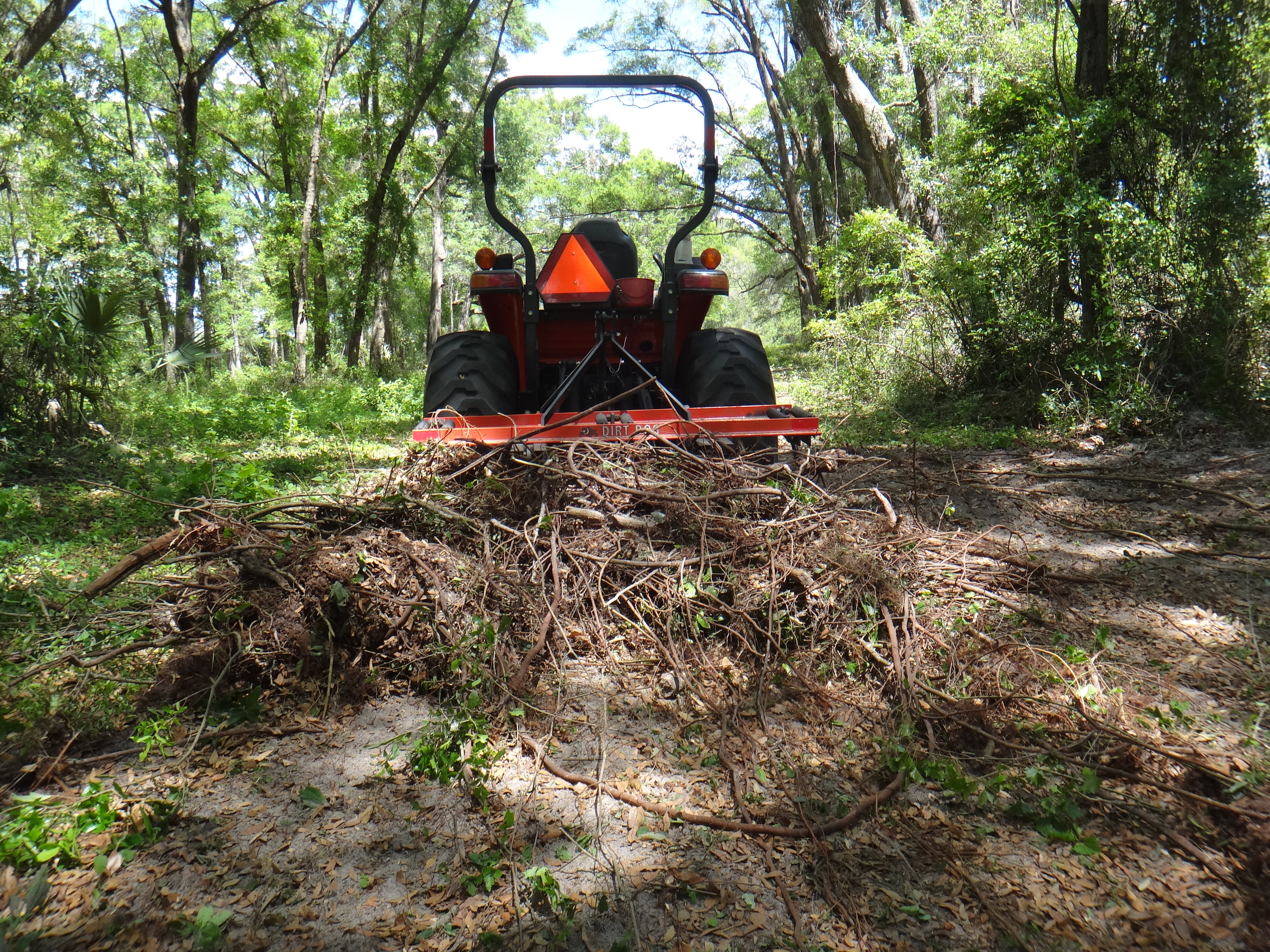

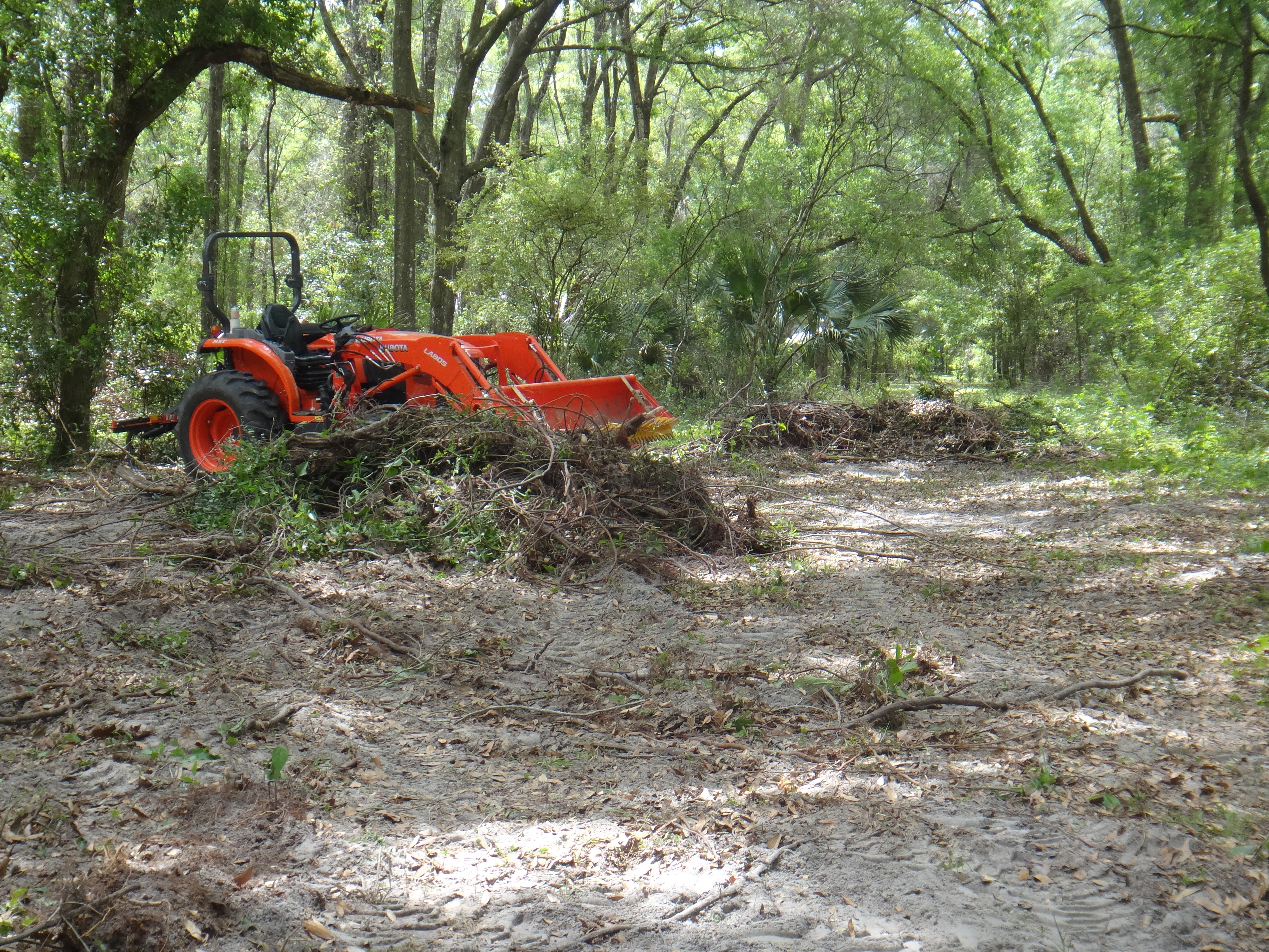

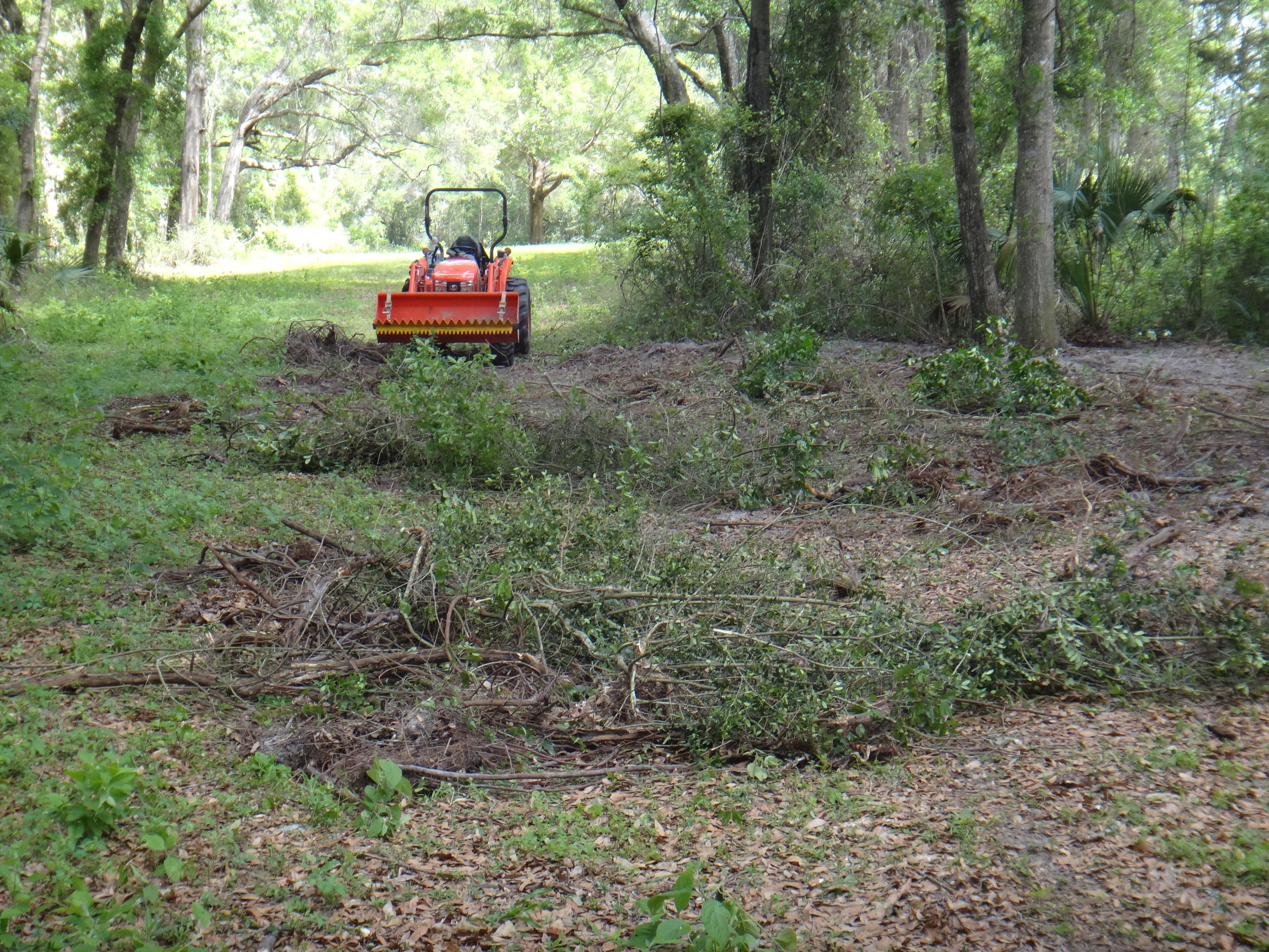

I cleared a small area thick with vines today.
Used Ratchet Rake bucket attachment to drag vines from trees and up to 1-1/4" trunk diameter trees and vine roots from the ground. Then consolidated debris into piles with the Ratchet Rake and towed piles to the burn pit with Dirt Dog Field Cultivator. At the pit, unhooked the debris from the Field Cultivator and used the Ratchet Rake to push debris into the burn pit. I used large loppers to cut some 2-1/2" grape vines which wanted to wrap around tractor wheels at burn pit, rather than release easily from Field Cultivator tines.
Few of these slightly elevated tows weighed less than 500 pounds. Most were 750 pounds or more.
Returning to the newly cleared area, used the Field Cultivator to drag out additional subsurface vines, roots and wild climbing rose corms to 12" depth. Then, with the Field Cultivator tines elevated so they just kerf the ground, rough graded. Next I will use a Disc Harrow to even and smooth the area, followed by TR3 rake for finish work. These stages will occur interspersed by rainfall.

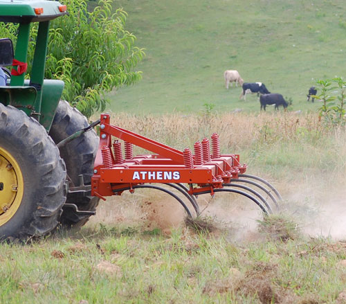

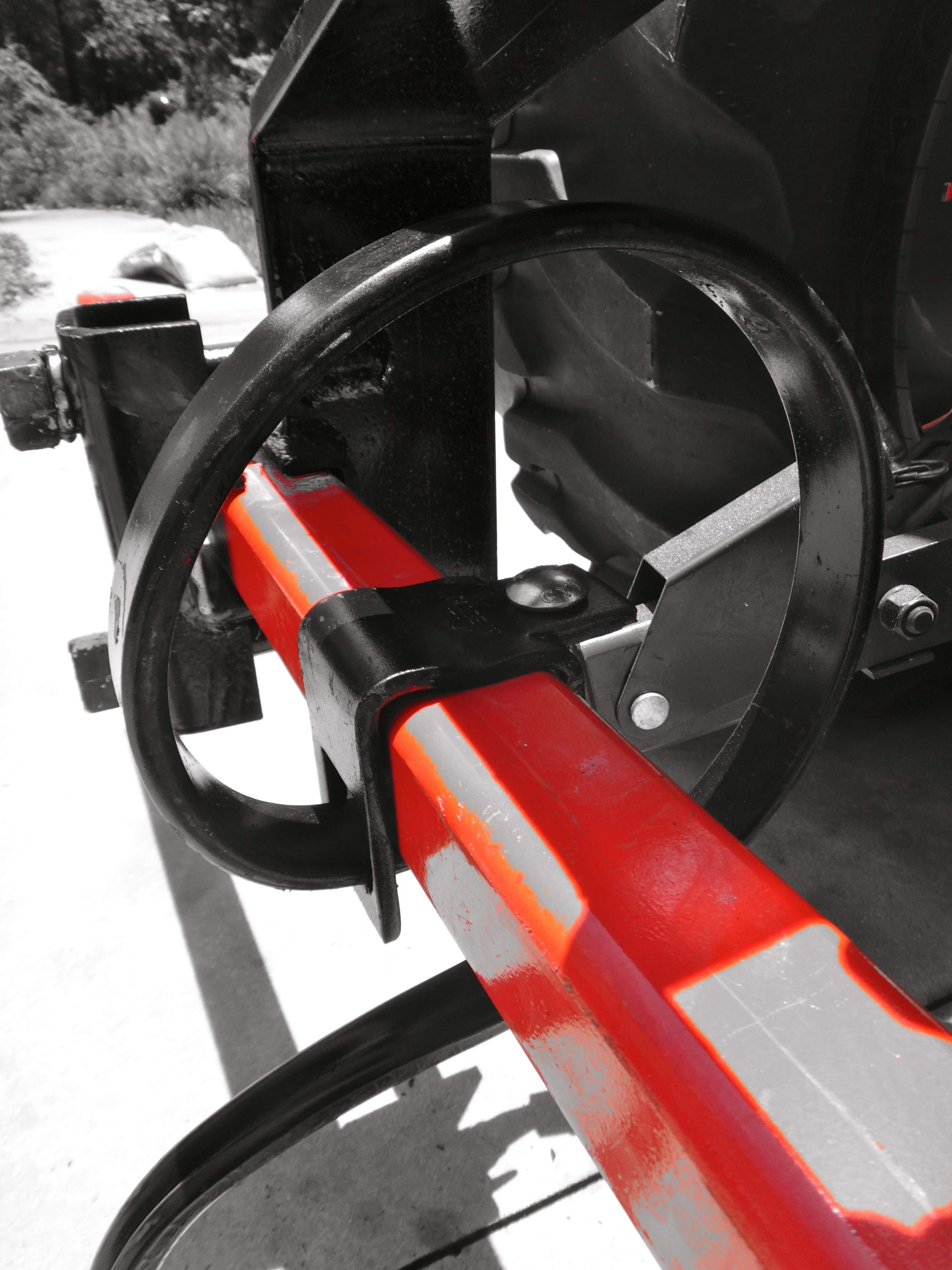

I also run across two other types of field cultivators and would like to see what others have to say about them. First, this style is lighter and has no springs. I assume it is just a very light duty version without the customization potential of those discussed above.
A spring-protected Chisel Plow is a primary cultivation conservation plow. A spring-protected Field Cultivator is a lighter duty primary cultivation conservation plow/aerator, sized for compact tractors. A Row Crop Cultivator is a tertiary cultivation implement for disrupting (little, baby) weeds in soft, moist, well prepared row crop/garden beds.

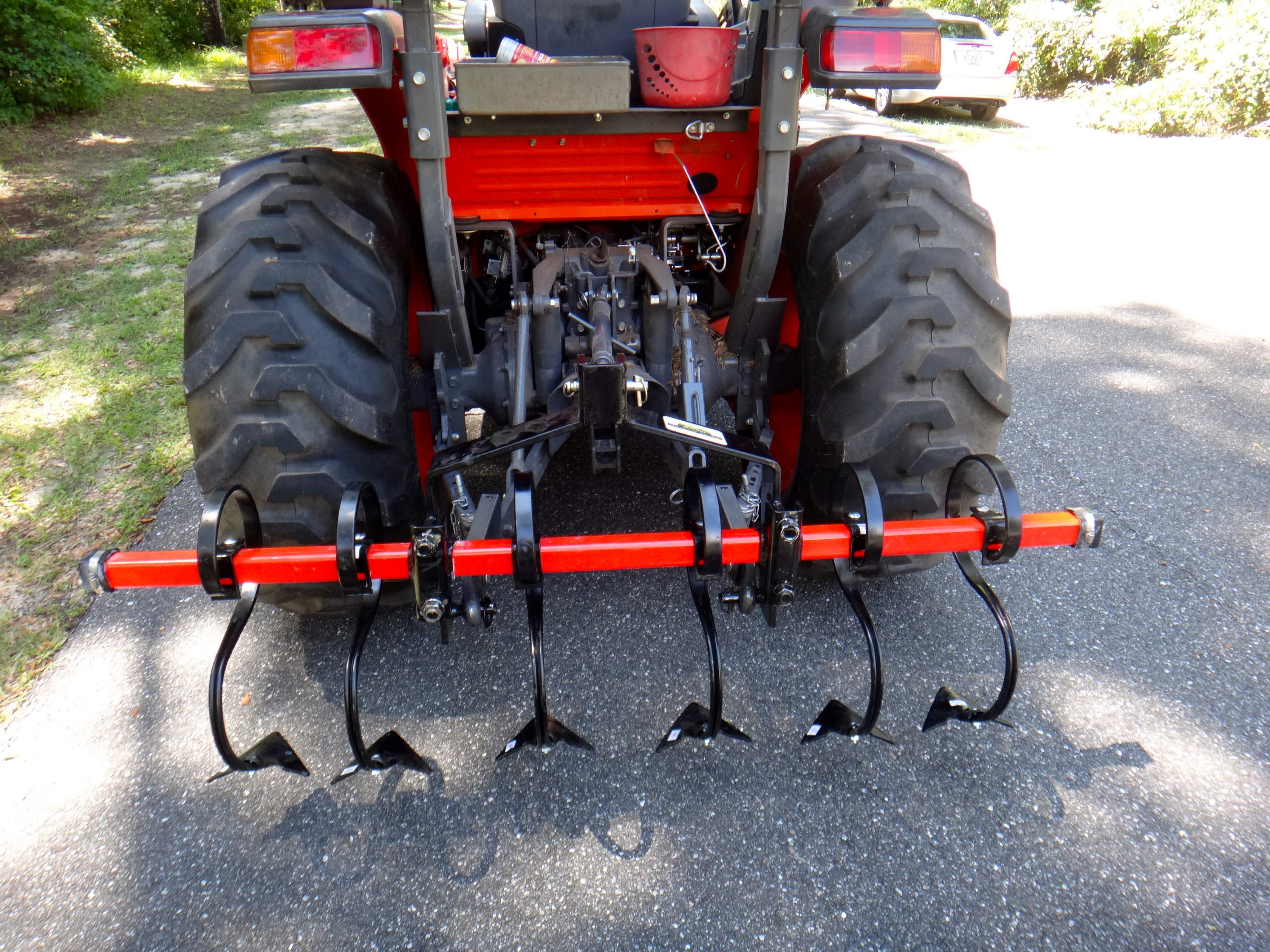

These S-tined styles seem to be the most popular. The sales language suggests that the tines vibrate to better destroy clods. They look less durable than the DD/FC style that has been discussed here earlier, and are lighter in weight. Does anyone have ideas to share regarding the various merits and demerits of the S-tined cultivators in relation to the spring loaded cultivators?
I use a heavier S-tine Cultivator. This is an another implement for secondary cultivation. The primary "fail safe" point on this springless design is the generic clamp bolts, which are about 75 cents each to replace. The secondary "fail safe" point is the generic clamp itself, about $3.50 each, including shipping. I have shovels, as opposed to points, for dirt contact. I break 3-4 bolts per season, one clamp per season and perhaps one S-tine every-other-season. Strangely, I have never replaced a shovel.
As bolts, clamps and S-tines distort individually, the tines no longer align in a straight row as shown in PHOTO #1. Still cultivates well as draft force resistance aligns spring-tines when sunk. PHOTOS #1 - #4
(Do not expect to use a Braber/DD/FC Field Cultivator for weed disruption. The tines/points are too narrow. Nor can points be replaced with shovels. The tines are too narrow for necessary plow bolts.)
