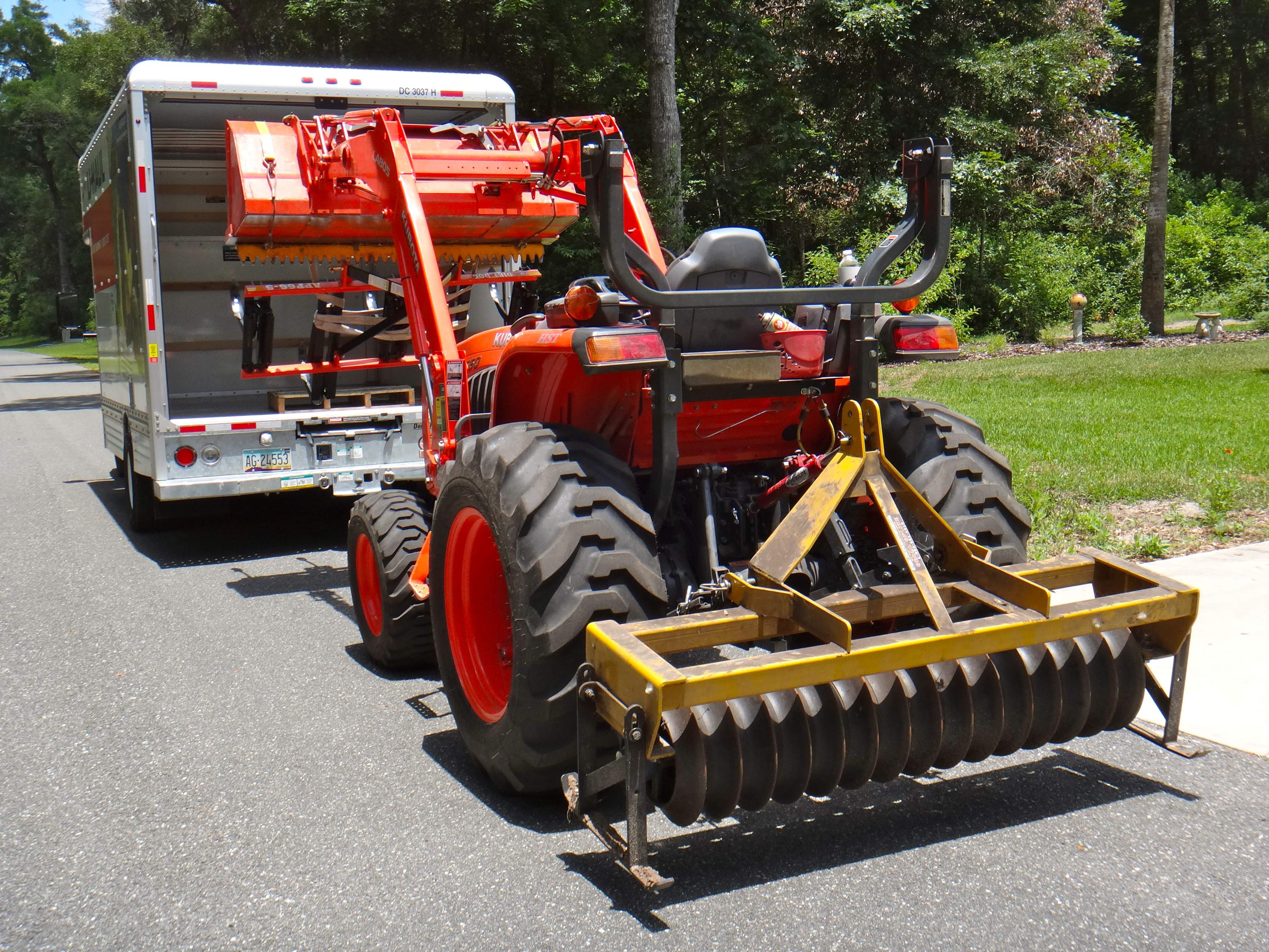

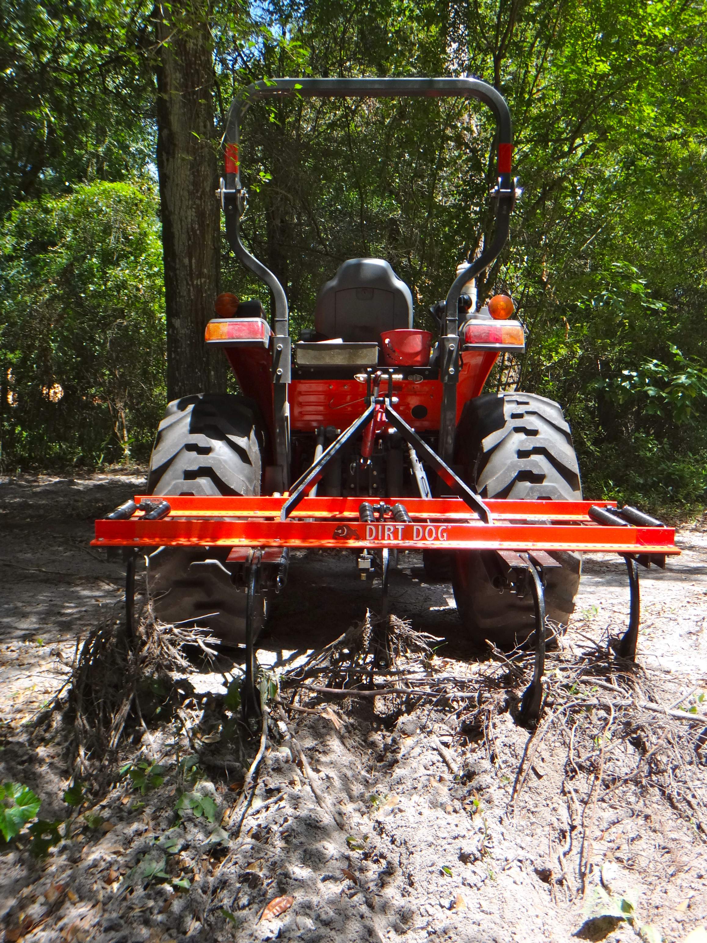

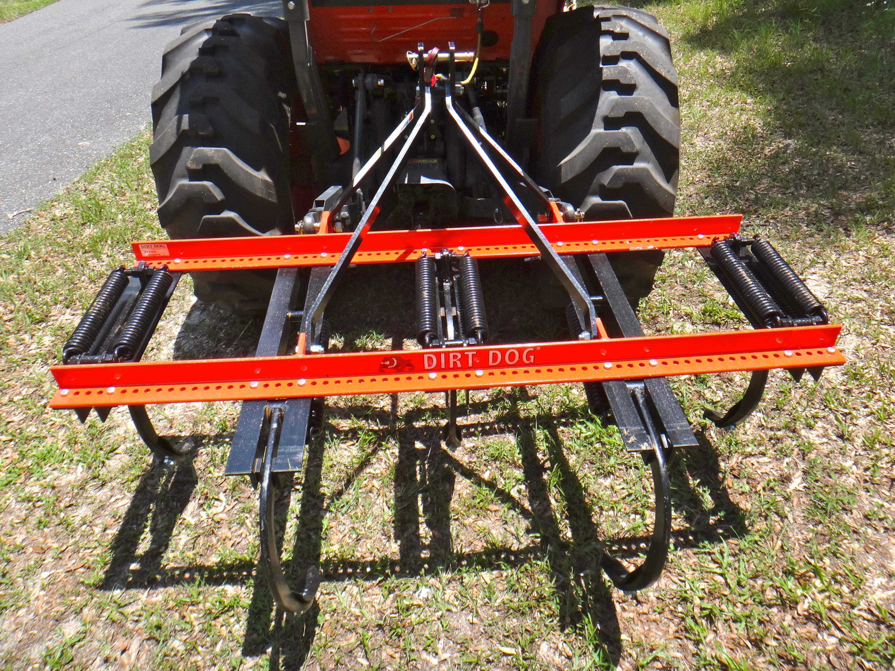

After one year and five months of consideration I special ordered a 66" Dirt Dog 'All Purpose Plow' (APP 66-5) which I will call a Field Cultivator, rather than a plow, as no soil inversion occurs.

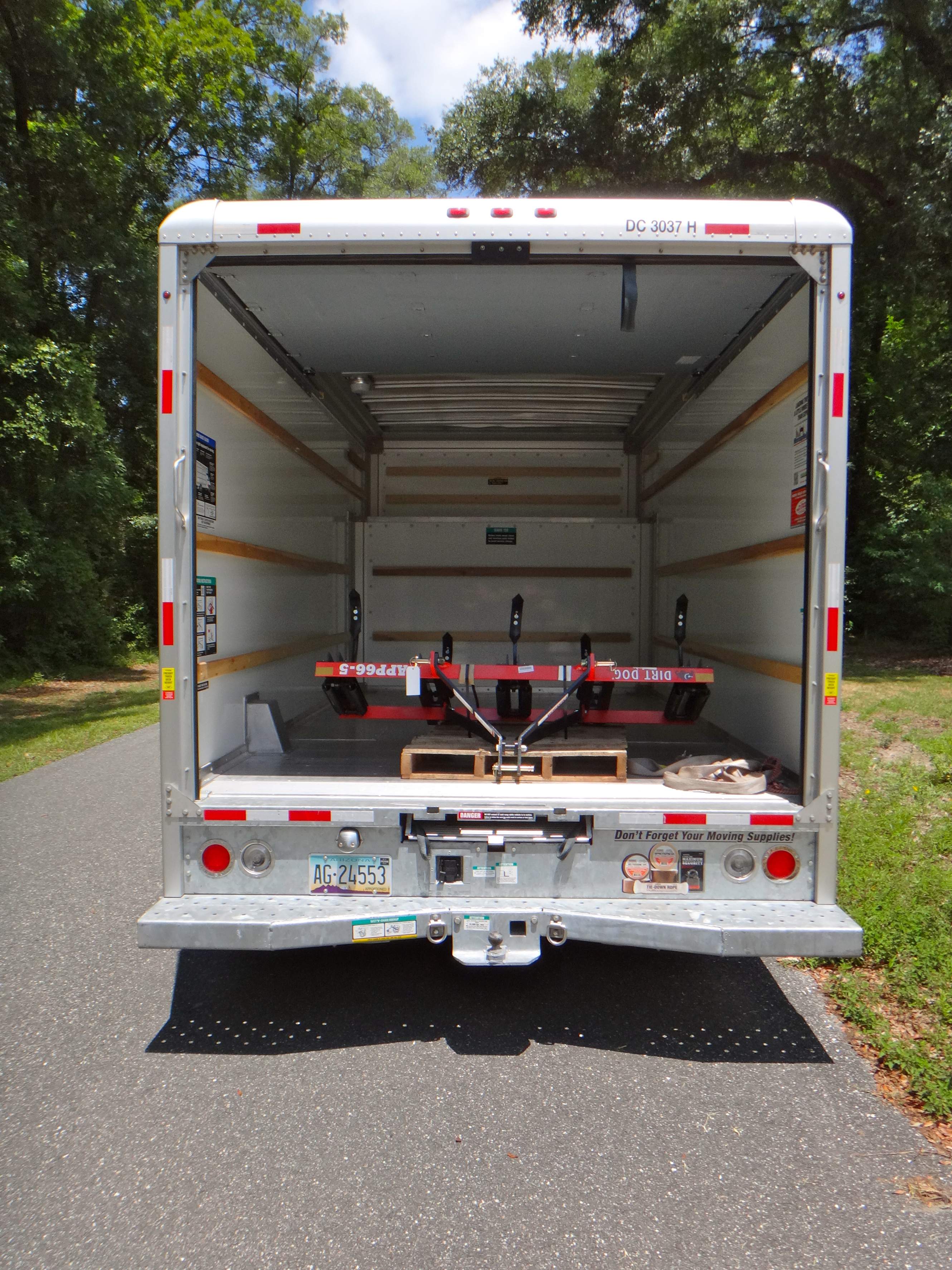

Cost was $835 FOB dealer, no sales tax on Ag nor Forestry equipment in Florida. I rented a U-Haul truck to transport Field Cultivator from Dirt Dog dealer, forty miles away, home.
Five parabolic shank Field Cultivator pulls much easier than the five rippers on my Bush Hog Rollover Box Blade. (Photo #11)
Like all implements, operating this one involves a learning curve. It worked well this afternoon. It should perform better as I accumulate hours pulling/adjusting it. (Photo #6)
I pulled Field Cultivator through a small patch of Bahia pasture grass to see if it would work as a Pasture Renovator in my sand-loam soil. It penetrated 5"-6" without tearing up surface growth.
This implement is a contemporary reproduction of an original Harry Ferguson design circa 1934. Ferguson called it a 'tiller'. Ford/Dearborn marketed same implement as a 'Field Cultivator', after parting ways with Ferguson.

I looks like it will do a great job. When I was a kid on the farm, we used chisel plows with fixed shanks (no springs). Field cultivators were not very common at all in our area. Now, the only fixed shank chisel plows I see are older ones from the days gone by.
When you have a chance to use it some more, I'd love to see some more action pics and to hear a report on your thoughts and impressions. I think with one of these plus a disc harrow and a drag of some sort (for leveling and busting up clods), I wouldn't need a rotary tiller. Plus I think the field cultivator would bust up and aerate the soil deeper than a tiller would.

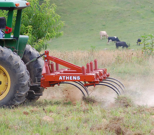

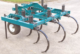

Dirt Dog Field Cultivator / 284 pounds Vs. Athen's Chisel Plow / 737 pounds with five shanks, both made in Georgia.
Note: parabolic shape shanks.
Field Cultivator -an implement used to perform secondary tillage operations such as seedbed preparation and weed eradication*. Field cultivators are equipped with steel shanks that are typically spring mounted to permit the shank to move within the soil and shatter clods. Field cultivators are constructed similarly to chisel plows, but are more lightly built.
[*not much for general weed eradication due to space between shanks. Would be fine for weed eradication if sweeps were substituted for standard chisel points.]
Chisel plows are primary tillage implements which use curved shanks to penetrate and "stir" the soil without inverting a soil layer. Chisel plows cause less residue disturbance than moldboard plows and are often used in conservation tillage systems.
Why do you think this is? The shape? The shanks on the field cultivator appear to be a bit longer than the ones on the ROBB. I have a RO720 ROBB.

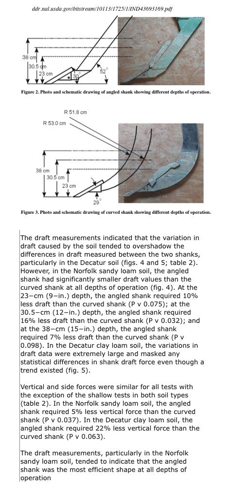

Anyone out there know the WHY? of parabolic shank shape?
I have a comparison of angled and parabolic that may be of interest.
I suspect angled or parabolic shanks require less down force (weight) to enter the soil and stay down, compared to vertical shanks.
