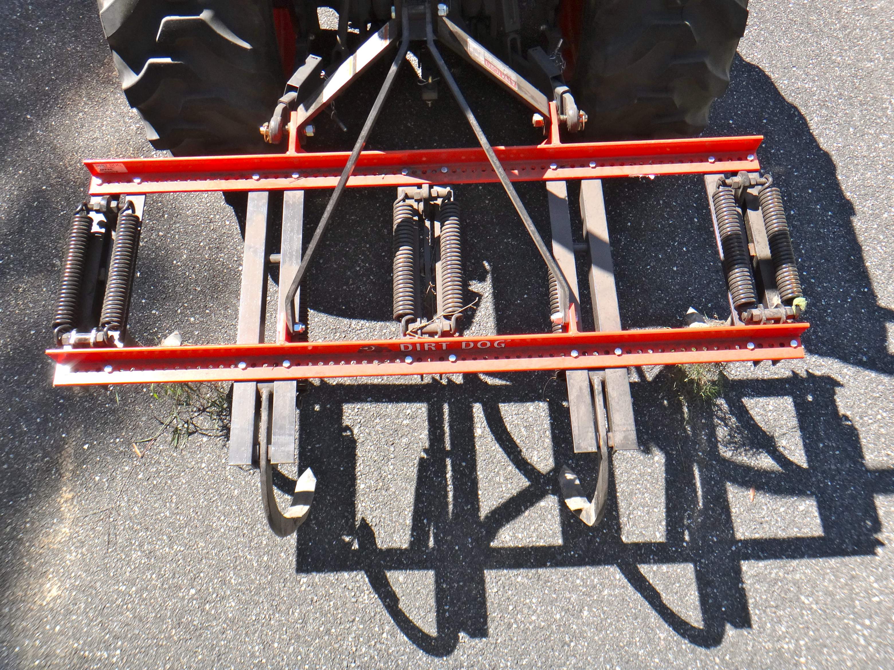

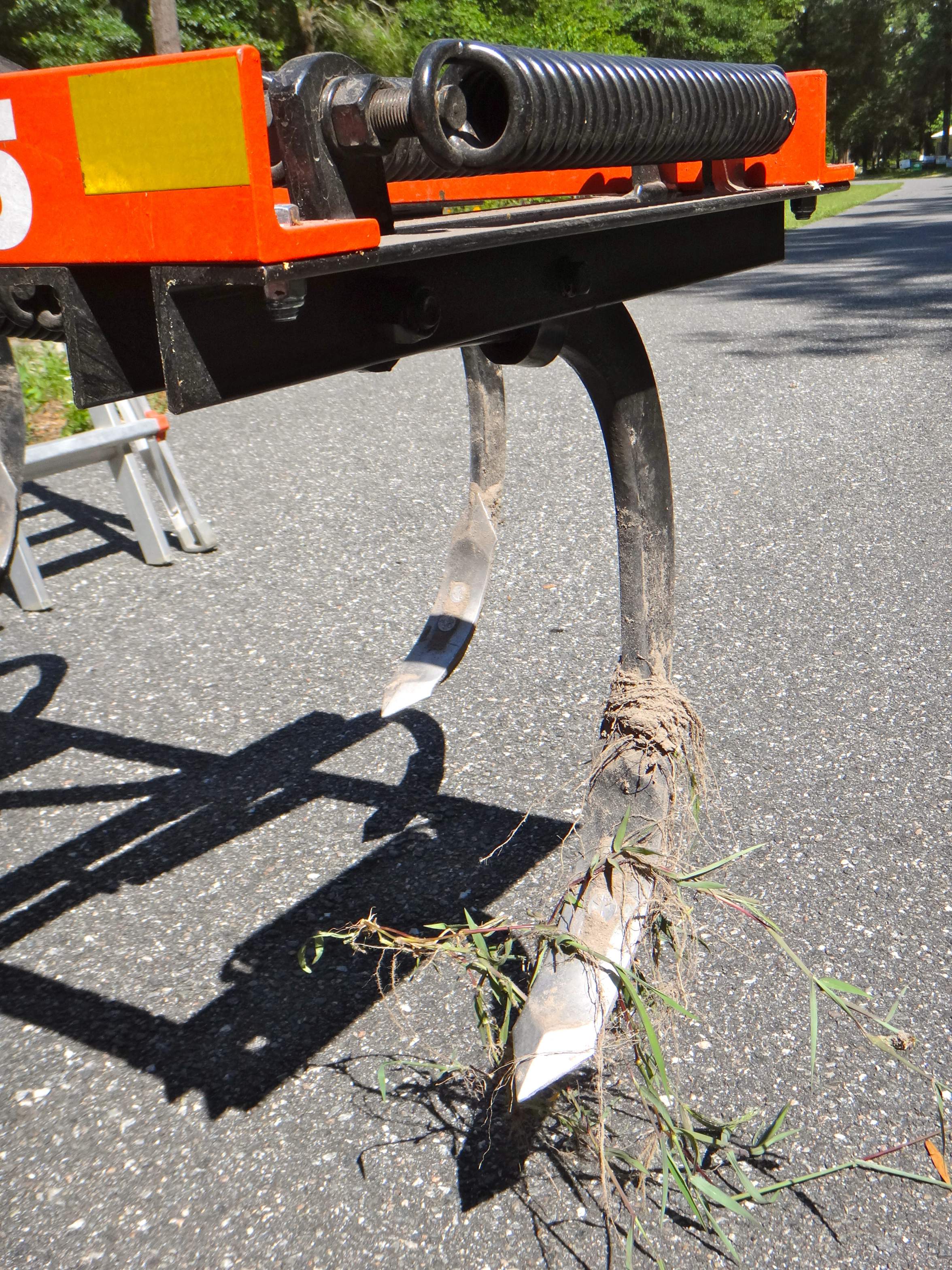

Why do you think this is? The shape? The shanks on the field cultivator appear to be a bit longer than the ones on the ROBB. I have a RO720 ROBB.
Five parabolic shanks on Field Cultivator are 1/2" width; area of point 20.3 square inches.
Five angled shanks on ROBB are 5/8" width; area of point 6.6 square inches.
Field Cultivator has easily perceived LESS draft resistance. It has to be the parabolic shape.
bcp's attachment in Post #40 contradicts my experience.

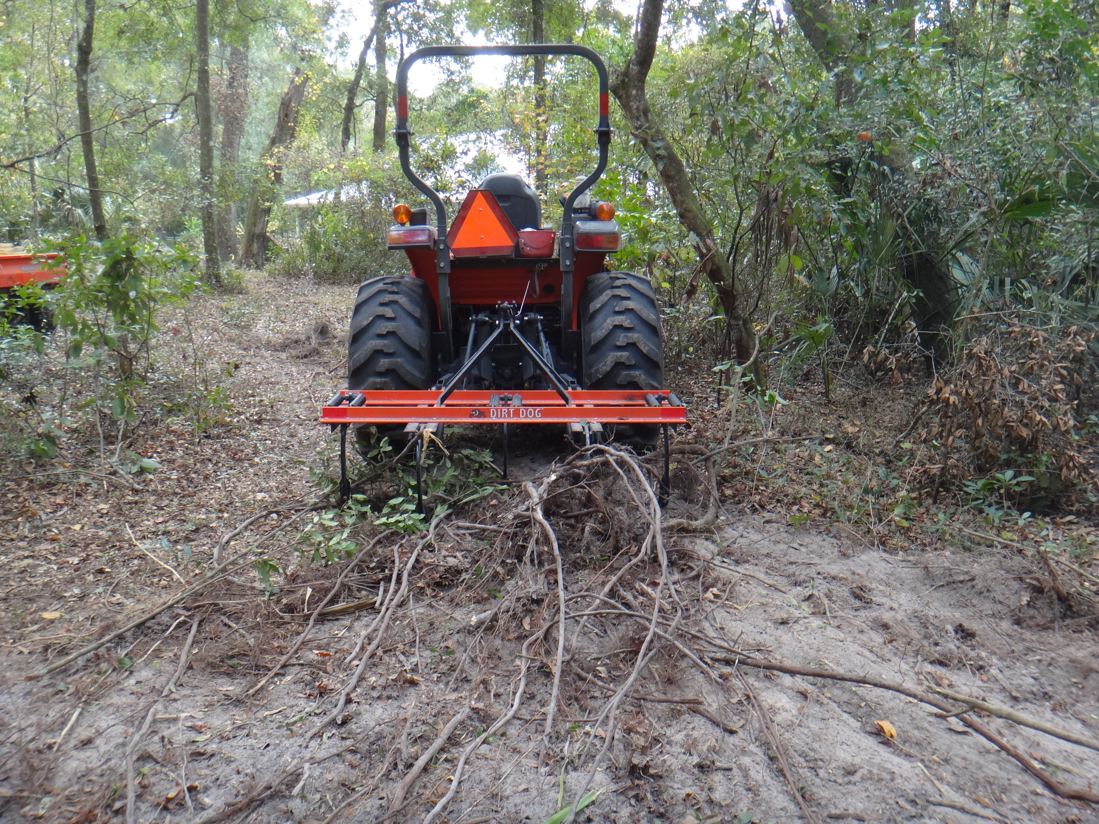

#42

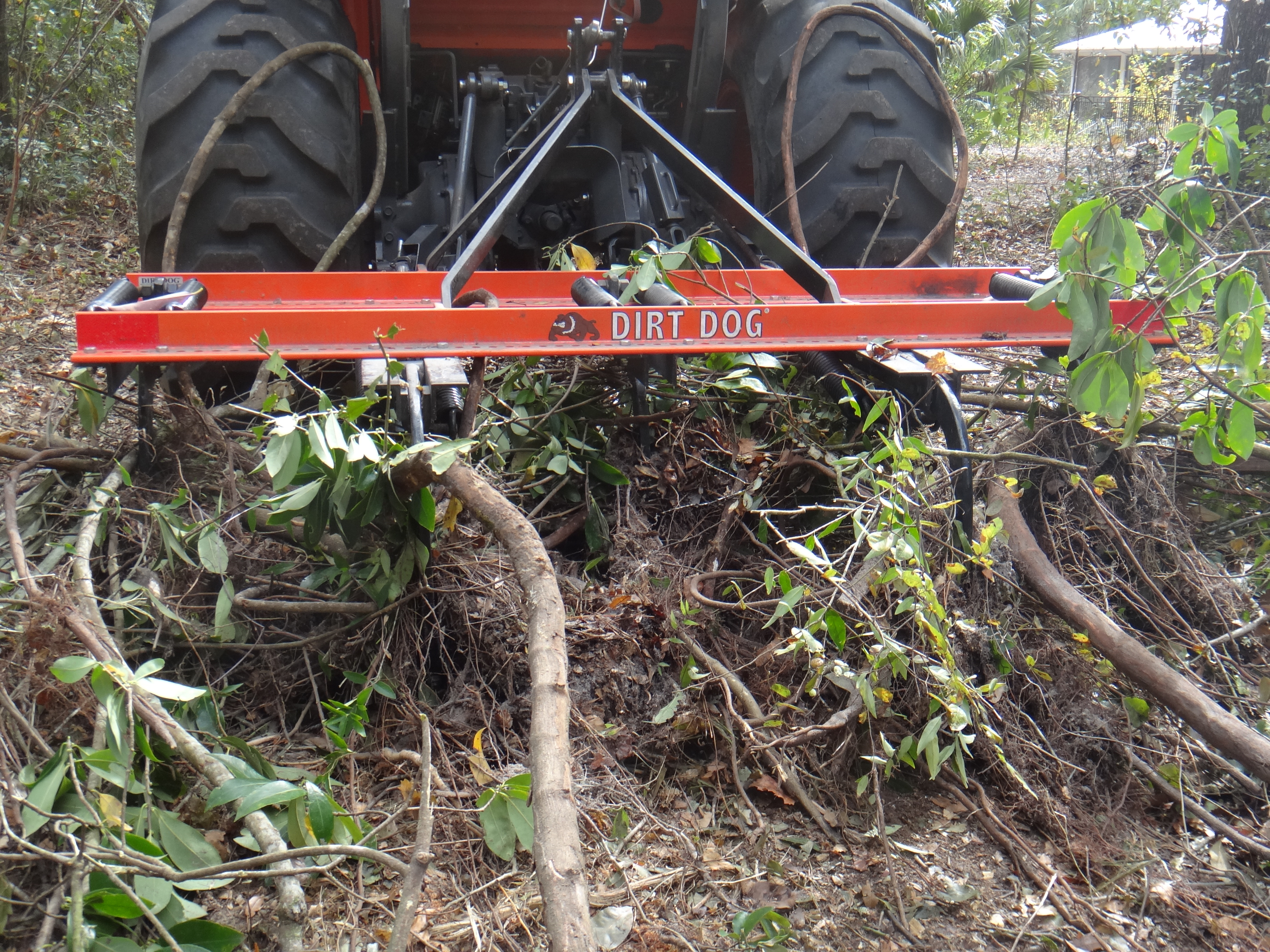

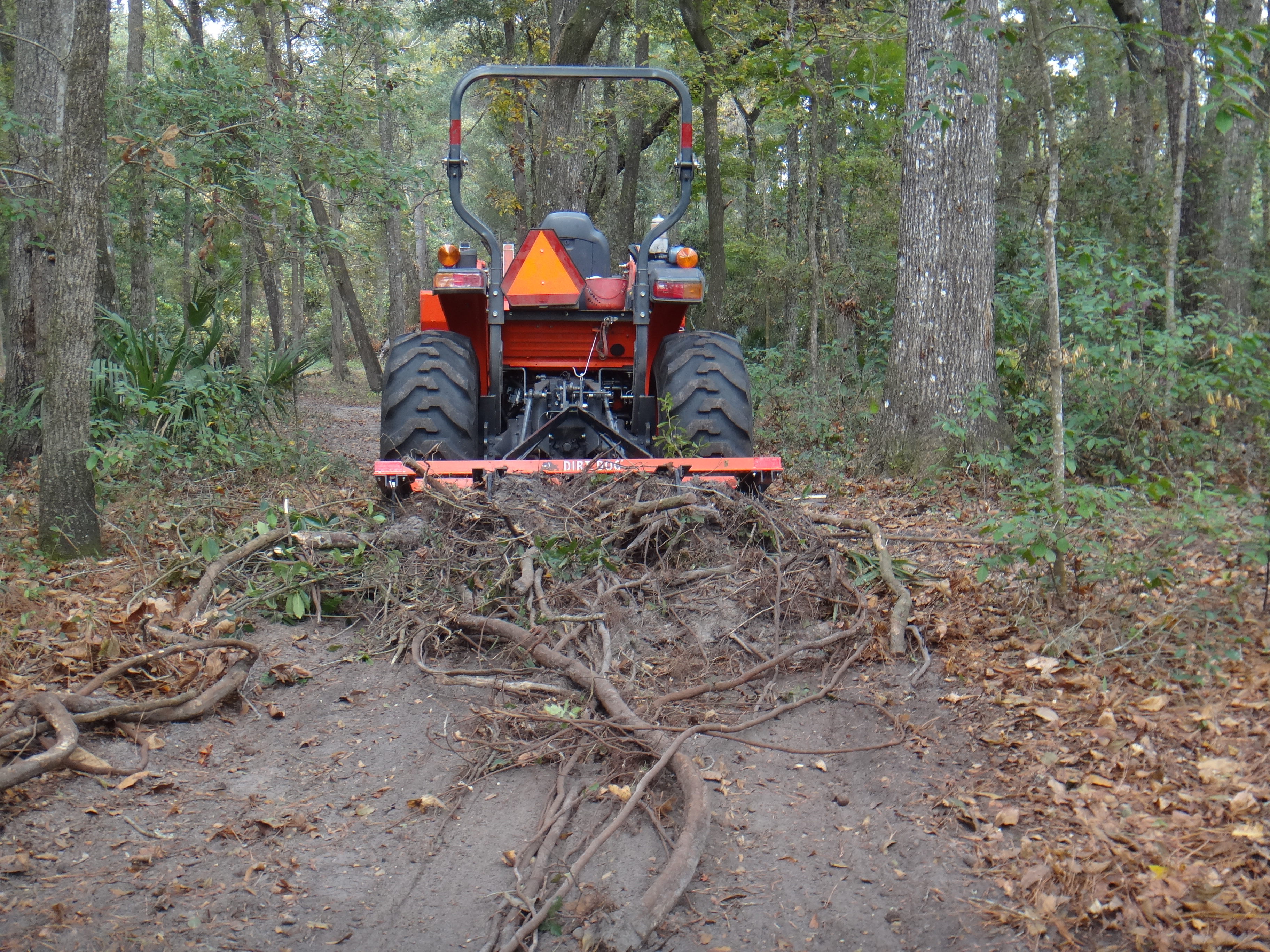

This afternoon I used the Field Cultivator to drag out wild grape vines and a few wild roses, growing from near the base of native Water Oaks up the trunks and into the crowns. Water Oak roots grow straight down into the soil, so I could back the Field Cultivator up against the Oak's trunk, lower the implement and PULL. Tractor was in HST/LOW. It pulled easily, however I made the right decision in selecting a five shank model rather than a seven shank model, both of which utilize the same 66" X 2-1/2" X 2-1/2" angle iron frame.
At the end of a pull, when the Three Point Hitch is lifted, the Field Cultivator self cleans reliably.
The engaged five shank Field Cultivator pulls easily, relative to my five shank Rollover Box Blade, with shanks down. With parabolic shaped tines the sharp, pointed chisel point is oriented almost horizontally when the Field Cultivator is being pulled through soil. See Photo #2
Parabolic tines "cup" spreading, shallow vine roots quite well, so the implement can drag unwanted vegetation out of the soil.

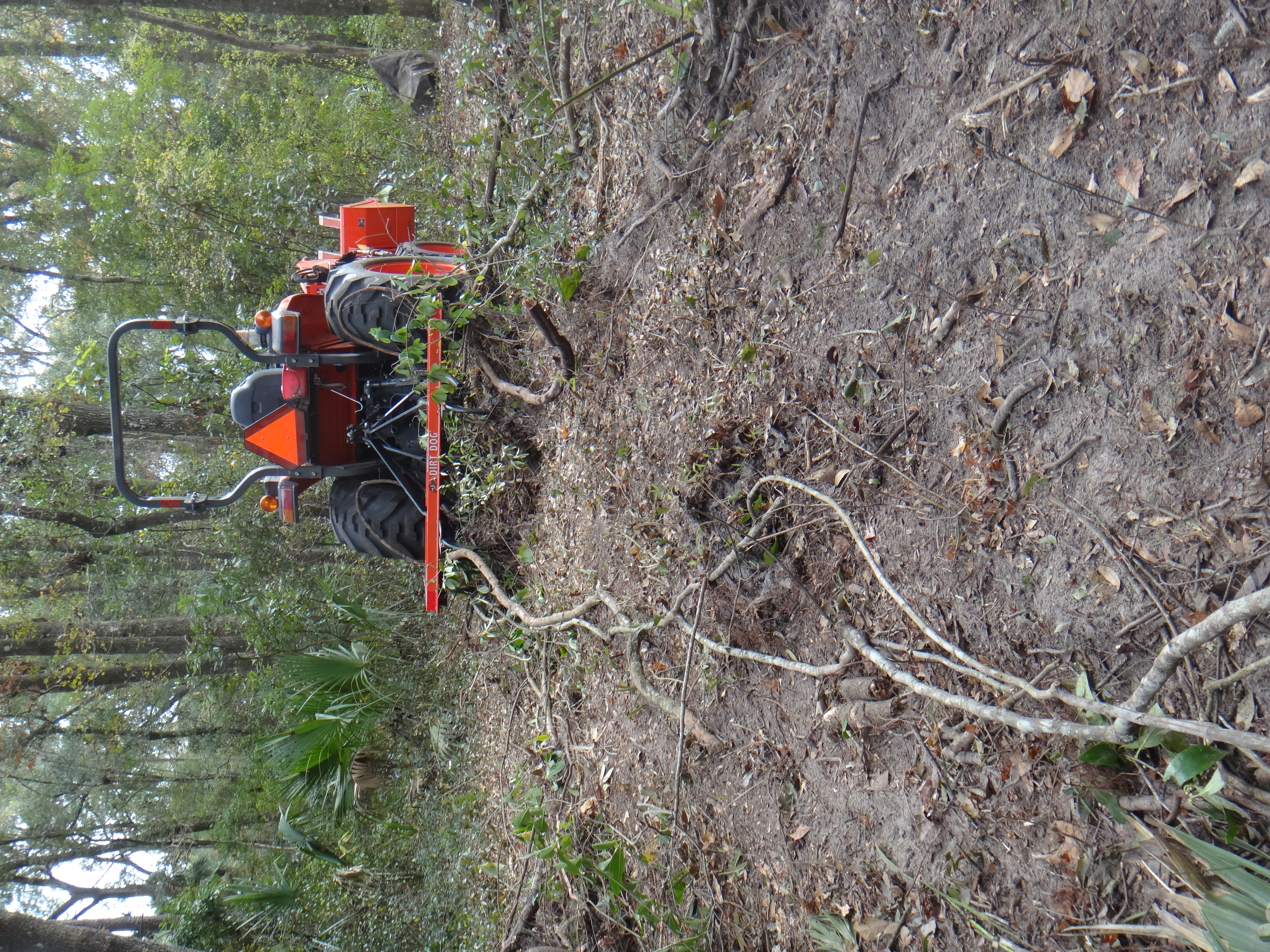

#43
12/01/2016

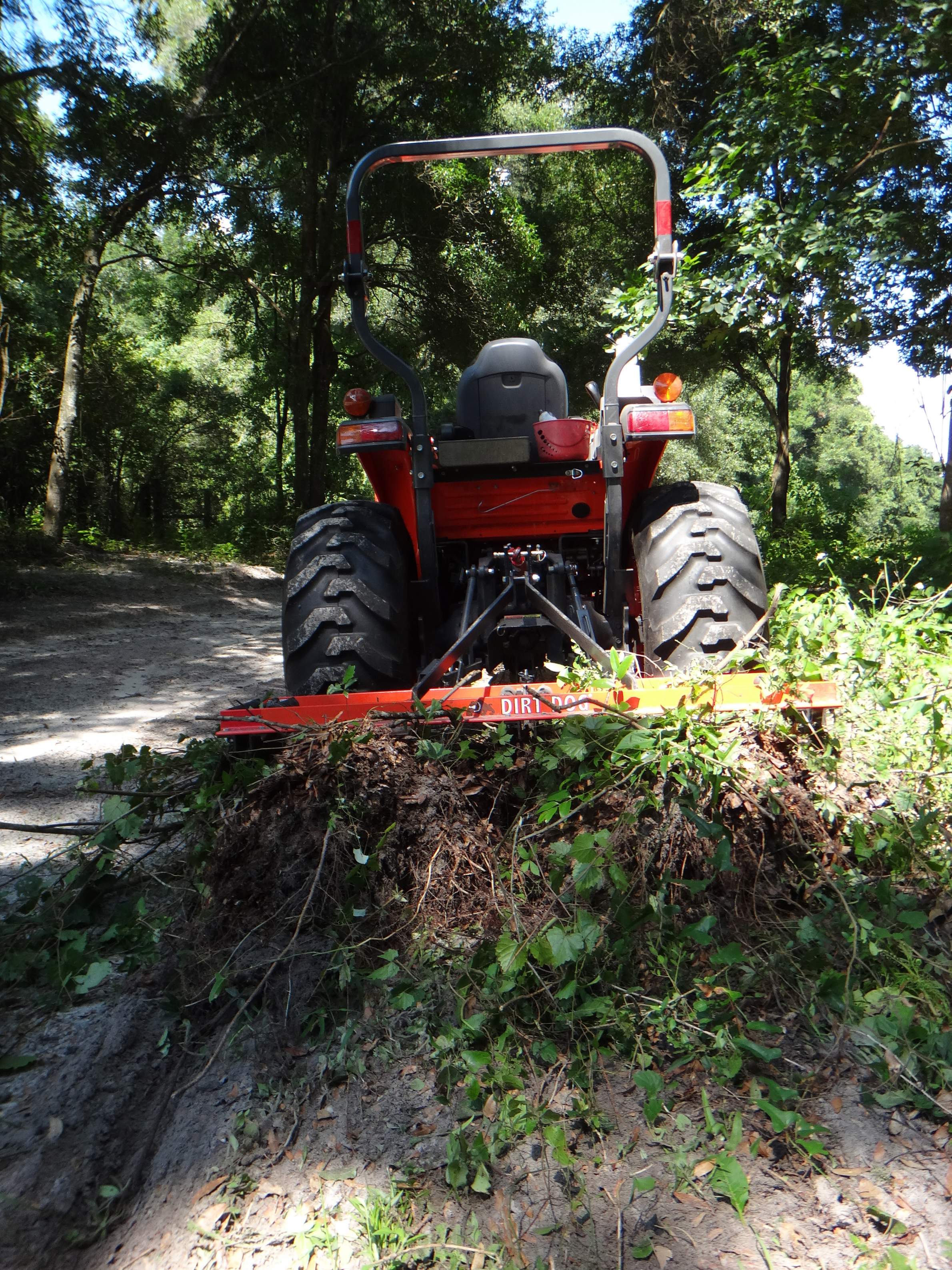

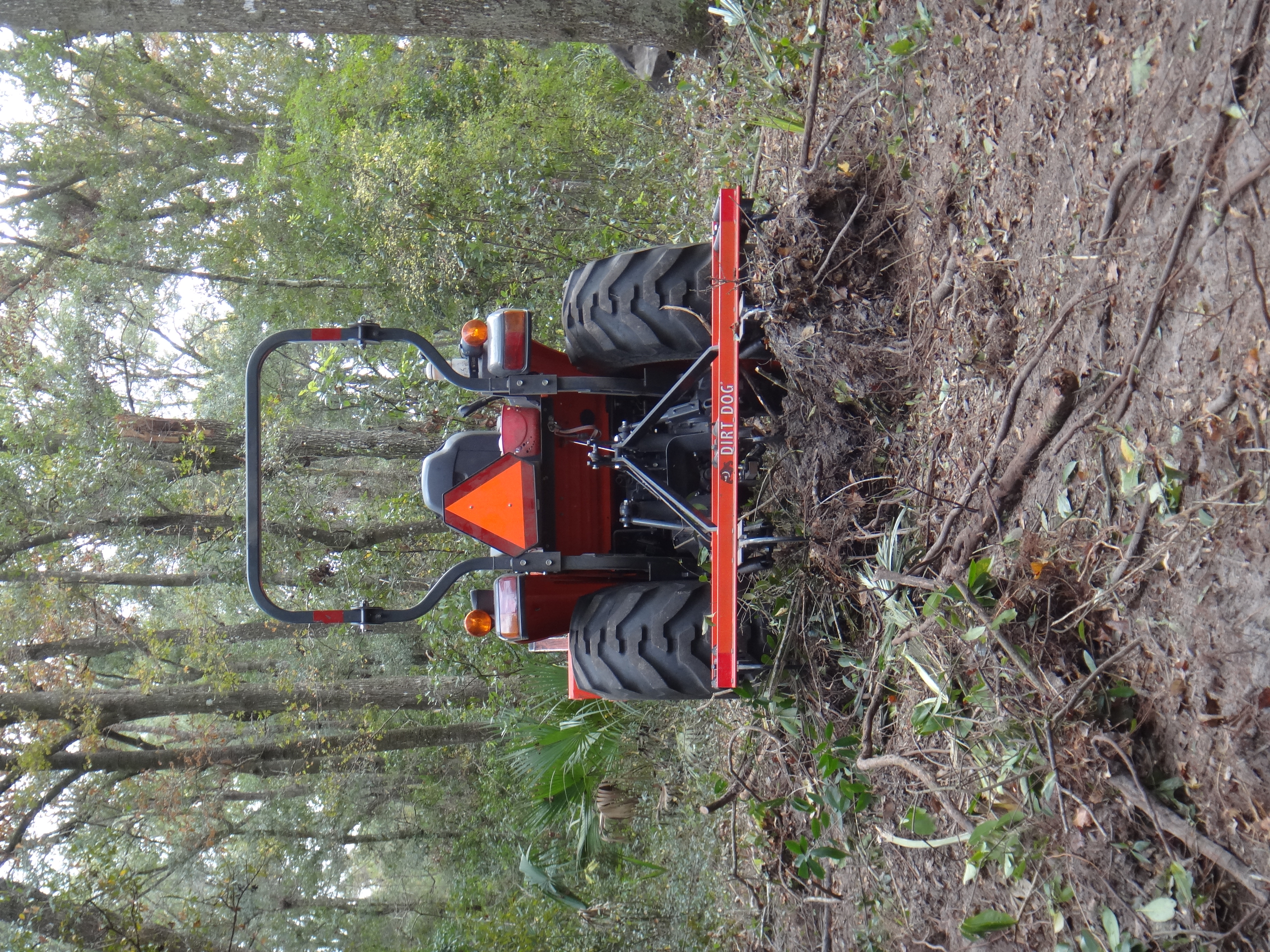

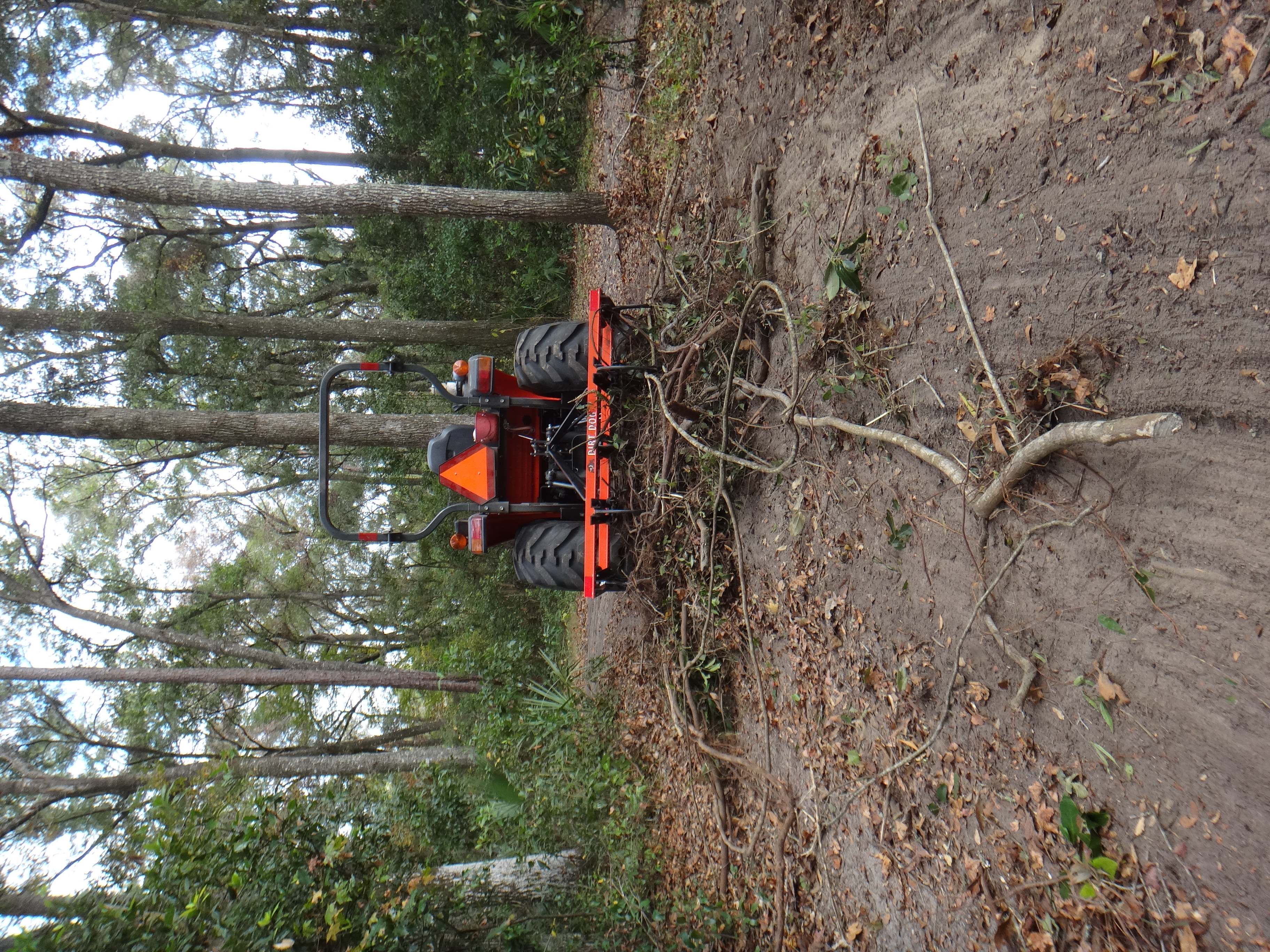

Photo #1 - Photo #4 Dirt Dog APP pulling wild grape vines from woods soil.
Photo #5 - Photo #6 Consolidated vines being dragged to community burn pile. Points are 2" above ground, Top Length is long in order to orient points upward slightly, to grip vines. Vines so 'hooked' can be dragged long distances with hardly any loss ~~~ as a bonus you get a clean swept trail.
