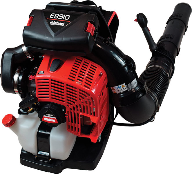

I just purchased my first backpack blower. After a bit of searching I ended up with a Shidaiwa eb910. It is extremely difficult to move forward when this thing is blowing at full speed. It's like walking against a hurricane wind gale. So far I like it a lot.
Please tell about its features, backpack, etc, etc. Its the fuel caps good on it? Photos are good.
/ Which Backpack Blower? #45
Please set about its features, backpack, etc, etc. Are it caps good on it? Photos are good.
I'm back in FL for a few days so I can't get real pics.
80cc 2 stroke
1100 cfm
220 mph wind speed
26lbs (a little heavy) but it's comfortable to wear and it sucks wind across your back to keep you cool.
don't know what you mean by caps (typo?)
it was at the very top of my budget plus 100 dollar :)

Nice, I didn't realize it was a rebranded Echo 9010, you'll like it, Echo makes an excellent product.

((Oh BTW... the Shindawa is a RedMax with different stickers.))
