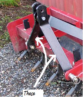

Does anyone know where I can buy a pair of cat 1 A-Frame struts as shown in the attached .jpg? Exact size does not matter other then they fit my BX24 3 point hitch. No paint/primer required, just bent correctly and with lift and top link pin holes. BTW, is A-frame strut the correct name for these?

I'd go to a blacksmith or welding shop.
That is an equipment part basically just 2 lengths of 1/2" X 2" flats bent at correct locations with a couple of drilled holes.
Any small shop could make that in about 1/2 hr.

I doubt they would cost much to make. If you have a vice, hacksaw and a drill you can make them yourself. Cut to length, mark and drill your holes and then clamp in a vice and bend away. Besides, it's alway's a good reason to buy more tools. :) If you have measurements I could make them for you. A couple bucks and shipping is all I would need. It's only about 3 minutes of work and a piece of scrap iron.

I built a set for a friends box blade. After you figure your time & material, I would buy a prefab set that has also been hardened. I thought it to be a 30 min job too and I do have a 12 ton press, but had to heat the flat bar to bend in my press. I did use 3 X 3/8 flat bar to build them really heavy duty.

The search is over...I found a fabrication shop here in Ohio (Ballard Fabrication's Store - Business & Industrial) that sold me a pair made out of 3/8" x 2" for about half the price of buying "replacement" struts. Struts came today and look like they'll be just about perfect for my BX24 project. I originally saw Ballard's 3 point stuff for small tractors on eBay and decided he might just be willing to sell some of his raw components. Funny thing how cold steel will get when UPS leaves it on your front porch in sub-freezing temps for several hours.
