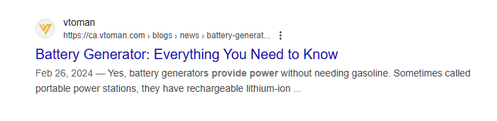

When did a battery become a generator? RANT
