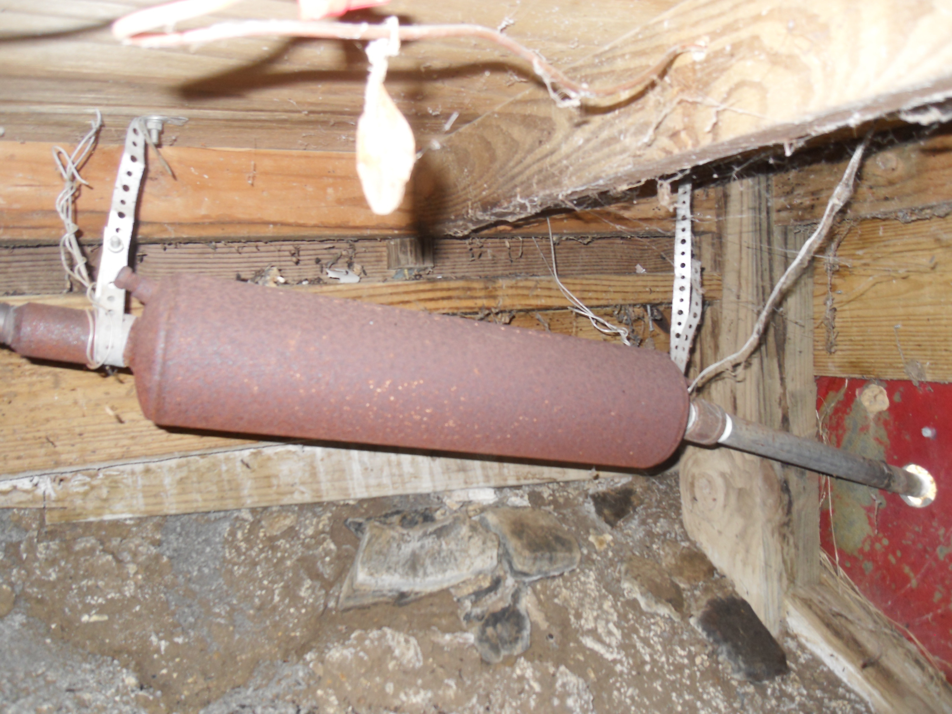

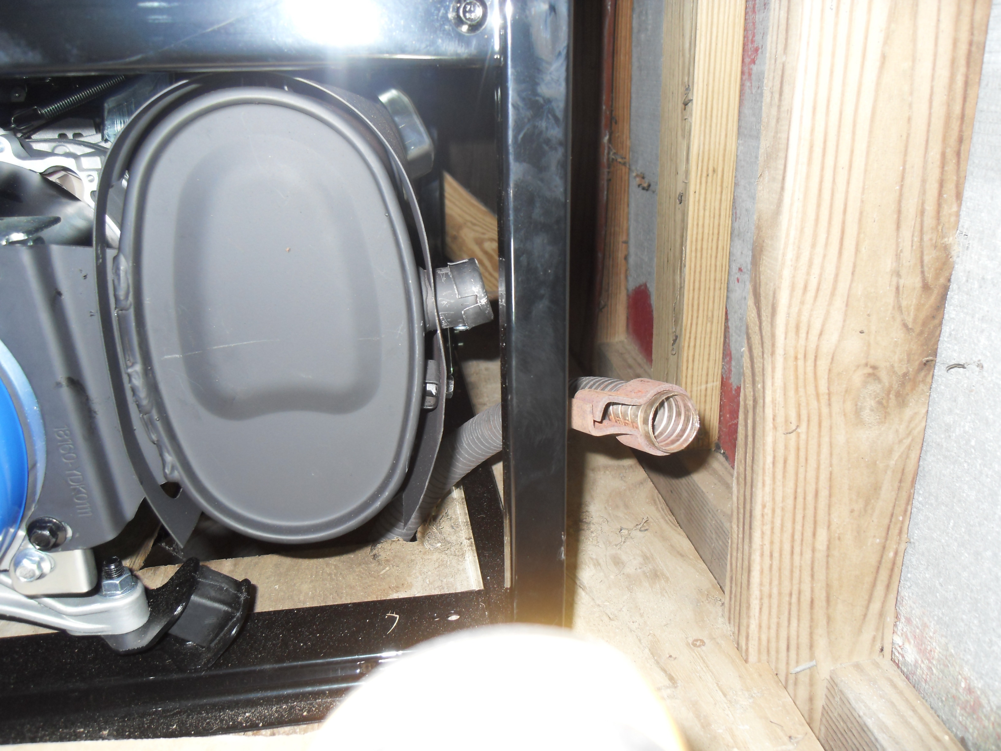

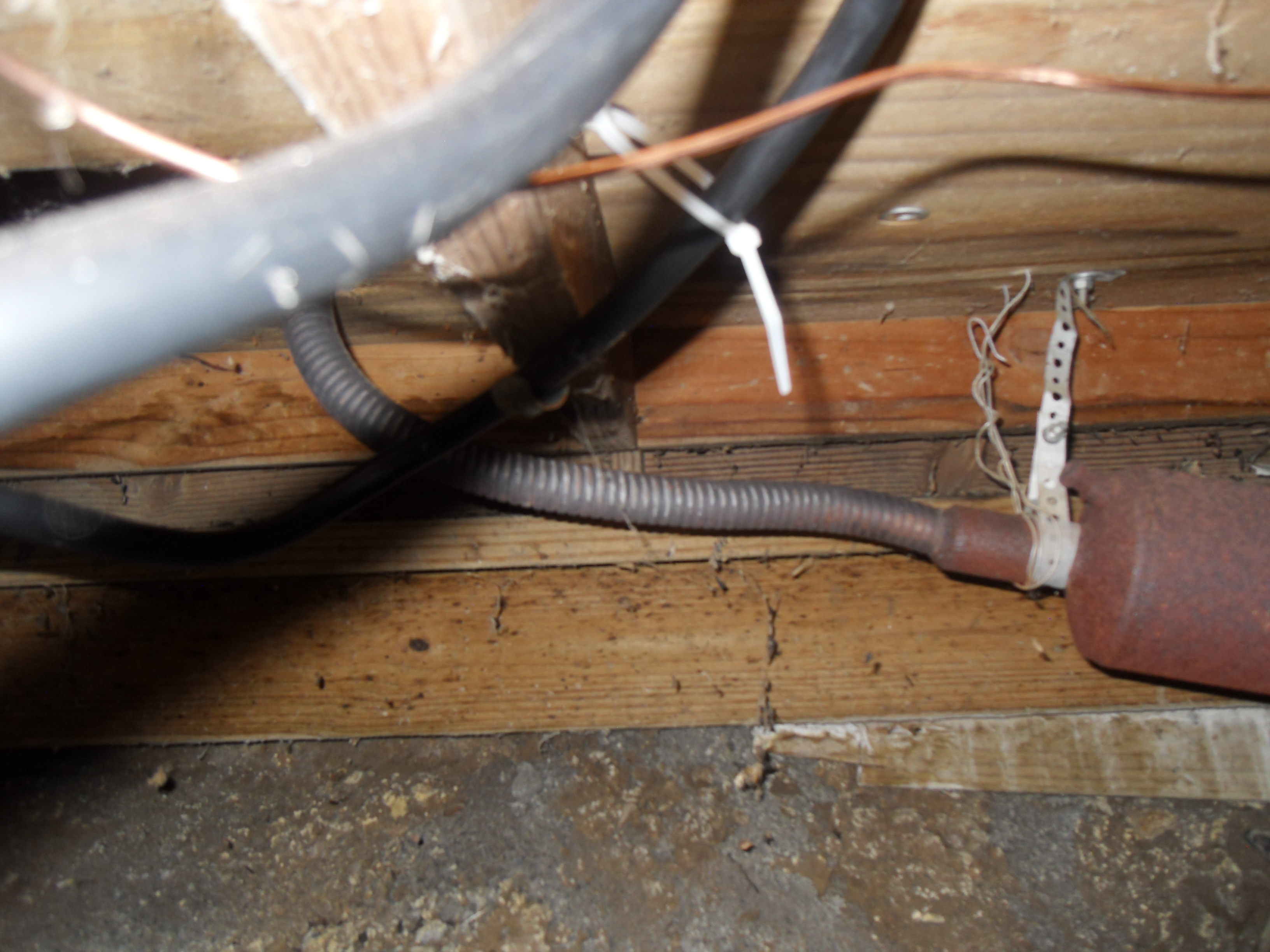

I purchased a Duromax XP13000HX a few months ago when the generator my husband purchased for Y2K finally decided it would not generate electricity. Ran fine but no juice. This new one is in place(stationary), connected to a large propane tank, we attempted to start it, turns out for running on propane you need a different spark plug. I have the plug now but it is not installed. The electrician tried to connect the generator exhaust to the existing muffler system but the end of the flexible steel pipe and the outlet of the generator are the same size(he tried to get a metal connector but has not found one yet). Currently the exhaust has a small cover on it, with a filter(first picture, on the right side, to the left of the upright), I assume so no pests can go back into the exhaust area. Any suggestions how to simply connect the two ends? I have contacted Duromax and sent pictures(their request), they say modifications to the exhaust may void the warranty.

I purchased a Duromax XP13000HX a few months ago when the generator my husband purchased for Y2K finally decided it would not generate electricity. Ran fine but no juice. This new one is in place(stationary), connected to a large propane tank, we attempted to start it, turns out for running on propane you need a different spark plug. I have the plug now but it is not installed. The electrician tried to connect the generator exhaust to the existing muffler system but the end of the flexible steel pipe and the outlet of the generator are the same size(he tried to get a metal connector but has not found one yet). Currently the exhaust has a small cover on it, with a filter, I assume so no pests can go back into the exhaust area. Any suggestions how to simply connect the two ends? I have contacted Duromax and sent pictures(their request), they say modifications to the exhaust may void the warranty.

You don't say the OD of your flexible lines but exhaust clamps are available in many sizes;

OD of exhaust with cover is one inch and 1/8, OD of flexible pipe is one inch. I assume if I get the coupler/clamp the cover and filter of the exhaust will be removed.

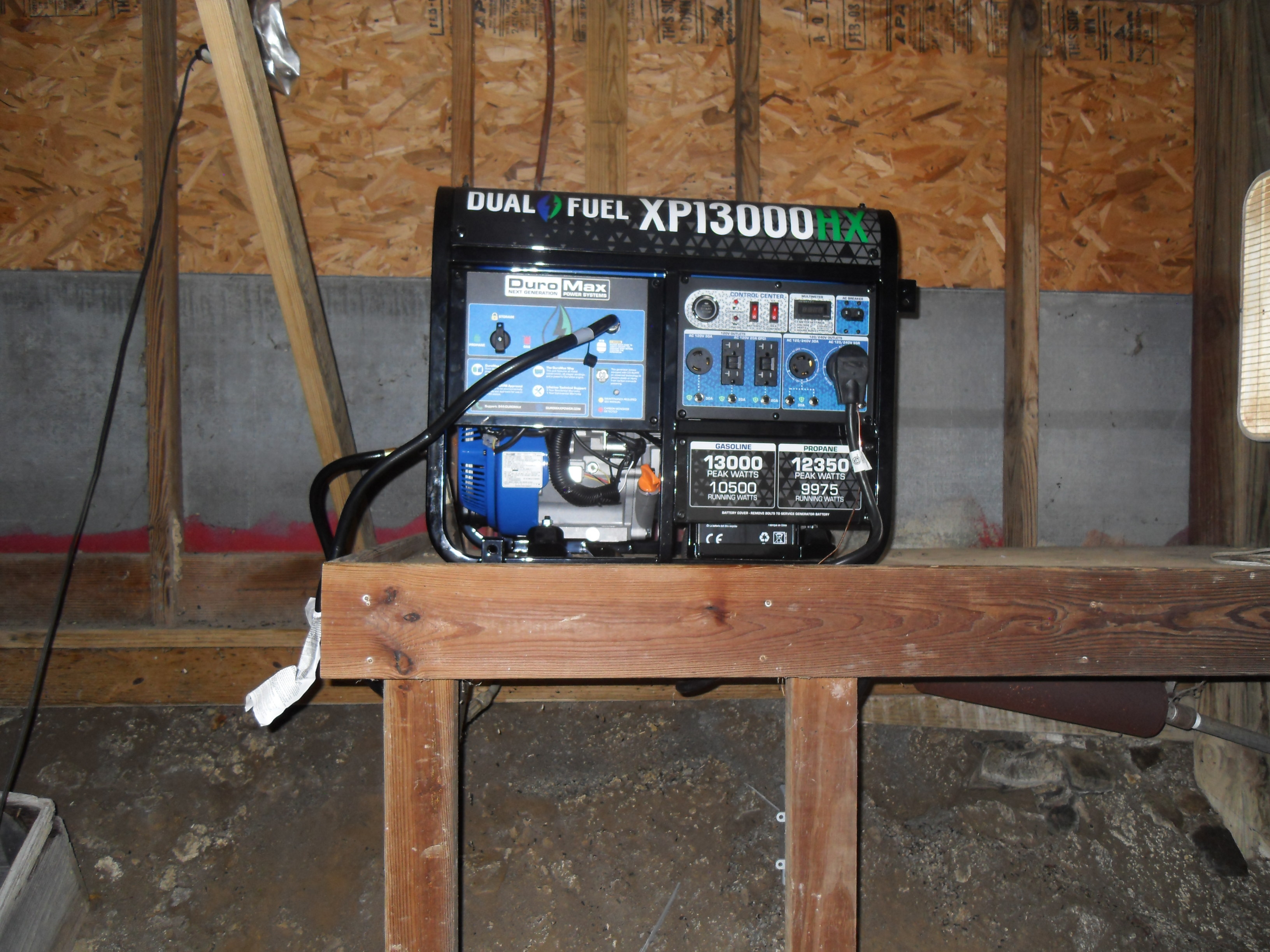

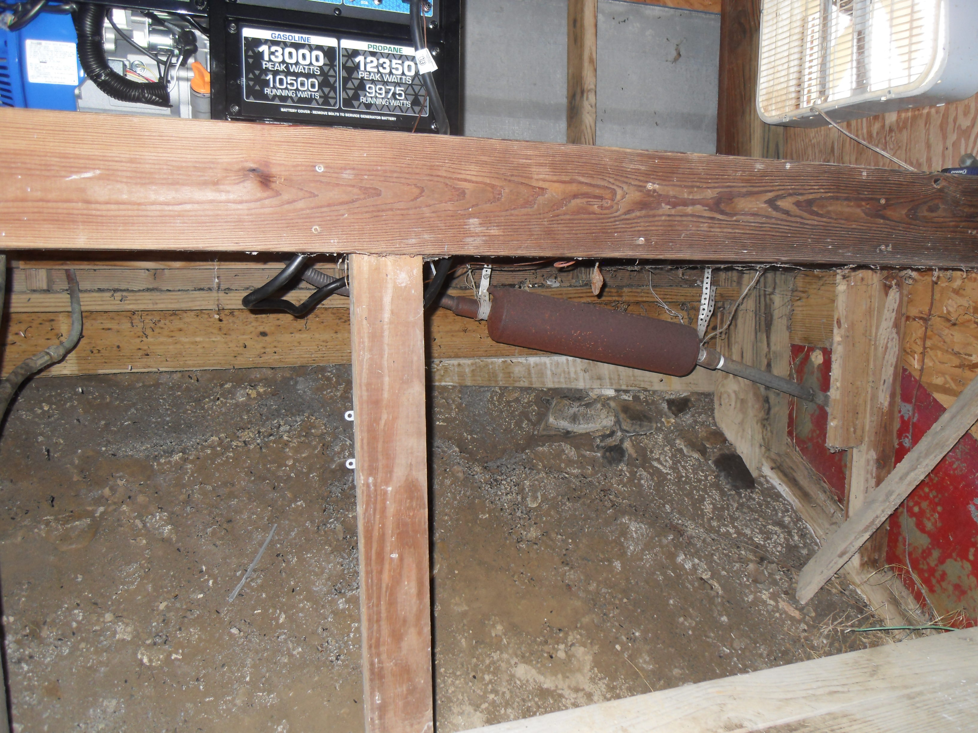

I'd like to see more clearance to combustibles for your exhaust or at least some shielding.

the set-up.

Many auto parts stores stock the sort of reducers and adapters that you want, though around here the stock of one inch +/- can be thin. Generally though, from a generator, you want a larger pipe than the engine exhaust. I would get some larger ID flex pipe, and do any adapting on the add-on muffler.
The mesh is probably a spark arresting mesh, required on most gasoline generators these days. It does bear checking periodically to make sure it hasn't clogged with rust or carbon.

Looks to me like you are attempting to connect the new generator’s muffler to your old pipe/muffler plumbing. You’ll end up with two mufflers in series, unless I’m seeing it wrong. That could be more resistance to air flow than optimum. Probably the most simple solution, is to ditch your old hose/pipe setup with that rusty muffler, and replace it to the wall with a single piece of flexible pipe sized to the new muffler, and adapt it to size as needed, at the wall

"Looks to me like you are attempting to connect the new generator’s muffler" new generator does not have a muffler that I know of.

"Probably the most simple solution, is to ditch your old hose/pipe setup with that rusty muffler, and replace it to the wall with a single piece of flexible pipe sized to the new muffler, and adapt it to size as needed, at the wall" that also sounds doable.

I assume the muffler was put there years ago for noise cancelling. And possibly to put fumes outside the enclosed area it is in. If the generator is not too noisy( it has not been started yet), could I connect a flexible pipe to the generators exhaust outlet and run that through the outside wall, without going through a muffler?

There is a muffler on this Generator all you need is the flex pipe to route the fumes outside! take off the short piece already on the generator and buy a longer one that will reach the wall.(napa)

Well, look what I just found. "the DuroMax XP13000HX generator has an oversized noise reducing muffler with a built-in spark arrestor. The muffler helps the generator operate quietly and smoothly."

First, I think that the manual for this generator is one of the best that I have seen, and has a number of important tips for starting it, break in time (6-8hrs, no more than 50% load, then change the oil, and recommending synthetic oil thereafter).
I've used similar generators as well, and I agree with @B7510HSD that your generator has a muffler. It is visible in one of your photos, the silver item to which your spark arrestor is attached.

Personally, I would not go removing the spark arrestor. Generators these days are tuned and optimized nine ways to Sunday, and I would not make any bets that the generator will run better without it. The bet I would make is that the generator will run a little louder without it.
I have to comment that I'm personally not that wild about running a generator in a space surrounded by wood, and partially enclosed. I understand that you have done this for some time, but I would point out the fire risk.

If you replace your old three piece flex-pipe, muffler setup with a new single flex, as some of us have suggested, I would definitely remove the spark arrestor before connecting your new flex to the engine muffler, if it was mine.
Your long length of flex should make it virtually unnecessary, especially if your wall exit area is non-combustible.
If you still want to use it, I would relocate it to the outside exit pipe where you can inspect, and easily clean it if necessary.
If you bury it under your new flex tubing and clamps, you’re almost guaranteed to forget it’s there, and you’ll likely run into future engine performance issues
