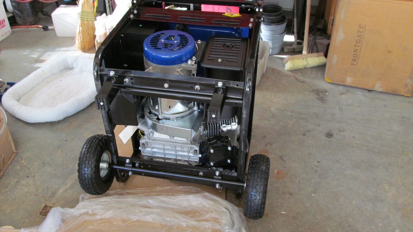

Unpacking and assembly was pretty easy. After cutting the straps and tape the box sides ripped open easily. The unit comes with a wheel kit, tools for assembly, a propane hose, and even includes a bag of electrical plugs for all the receptacles. I found the bolts to be easier to access and tighten with a 1/4" drive ratchet and 10mm socket than using the included wrench.
I installed the handles first then rolled it on to the engine end of the frame to install the wheels and rests. The axle mount holes are offset so it only goes on one way. Make sure and position it so the stubs stick out equal on both sides. After the axle is tight place a flat washer on the stub, install the wheel with the hub offset inwards, then another flat washer, and the cotter pin.

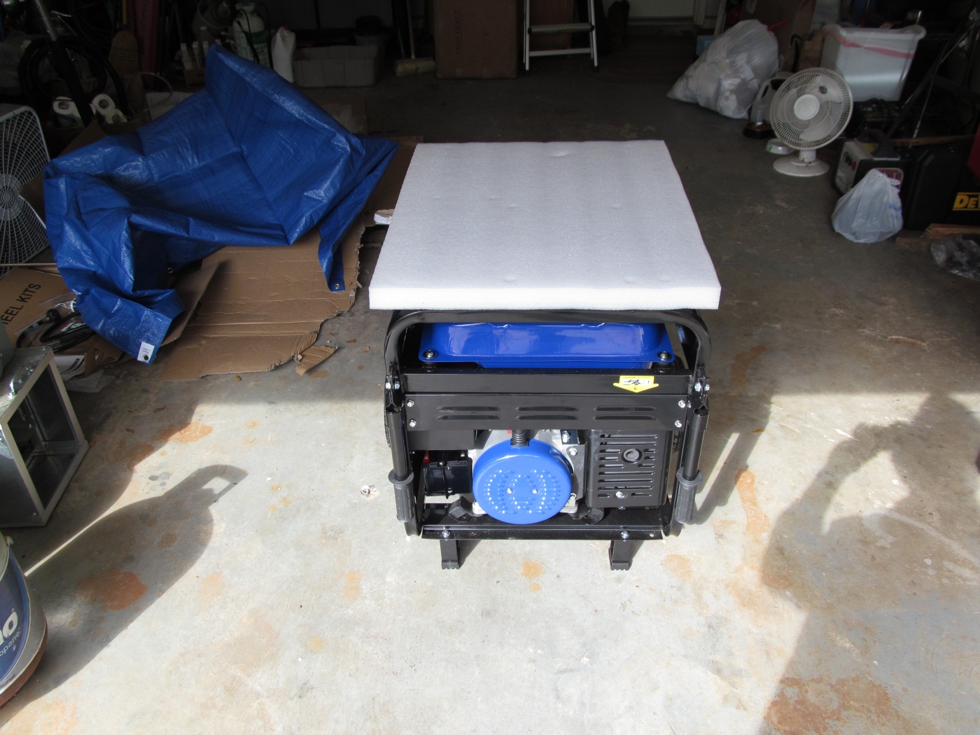

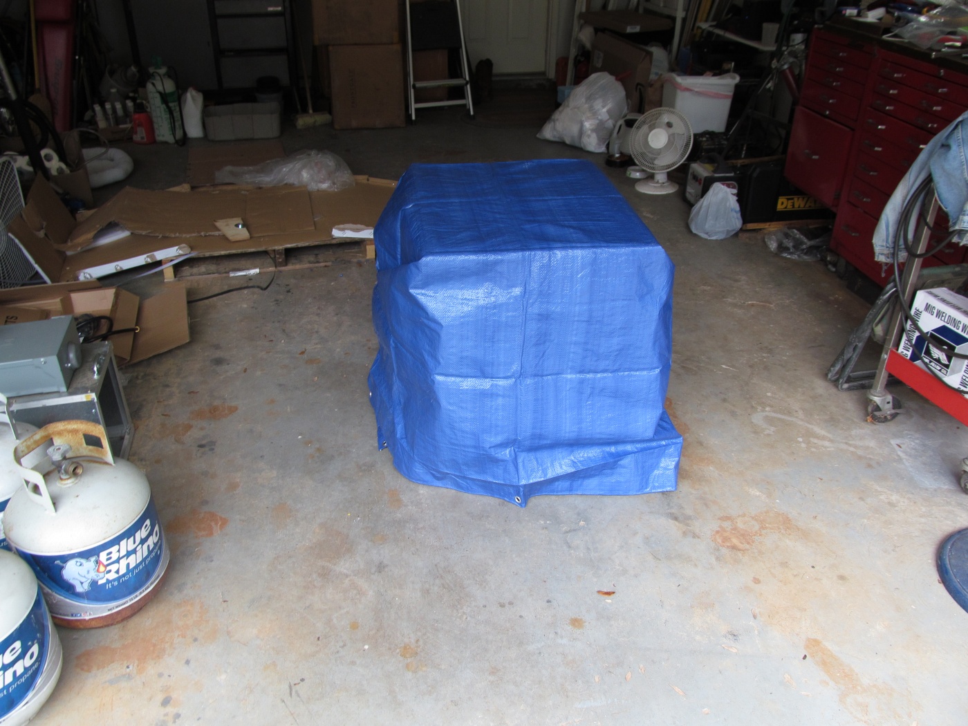

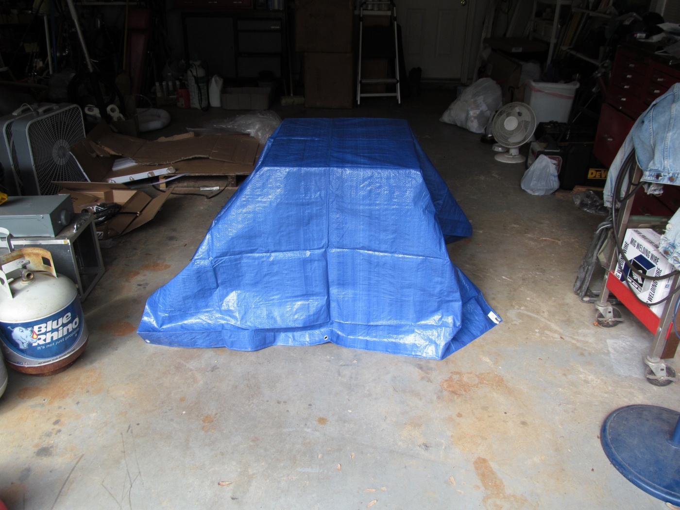

For a cover I used a 5'6"x7'6" HF tarp. They sell these pretty cheap and often give them away with coupons.
I placed the foam that came with the unit on top and positioned the tarp evenly over it.
Then I folded the sides in, stapled, and marked them. Then I pulled the tarp off and punched holes to add a grommet to hold them in place.
It ain't the prettiest cover but it goes on and off fairly easy and should help protect the unit. I left the foam in the top to make it easier to handle and it also keeps the ends from laying out on the ground too bad.

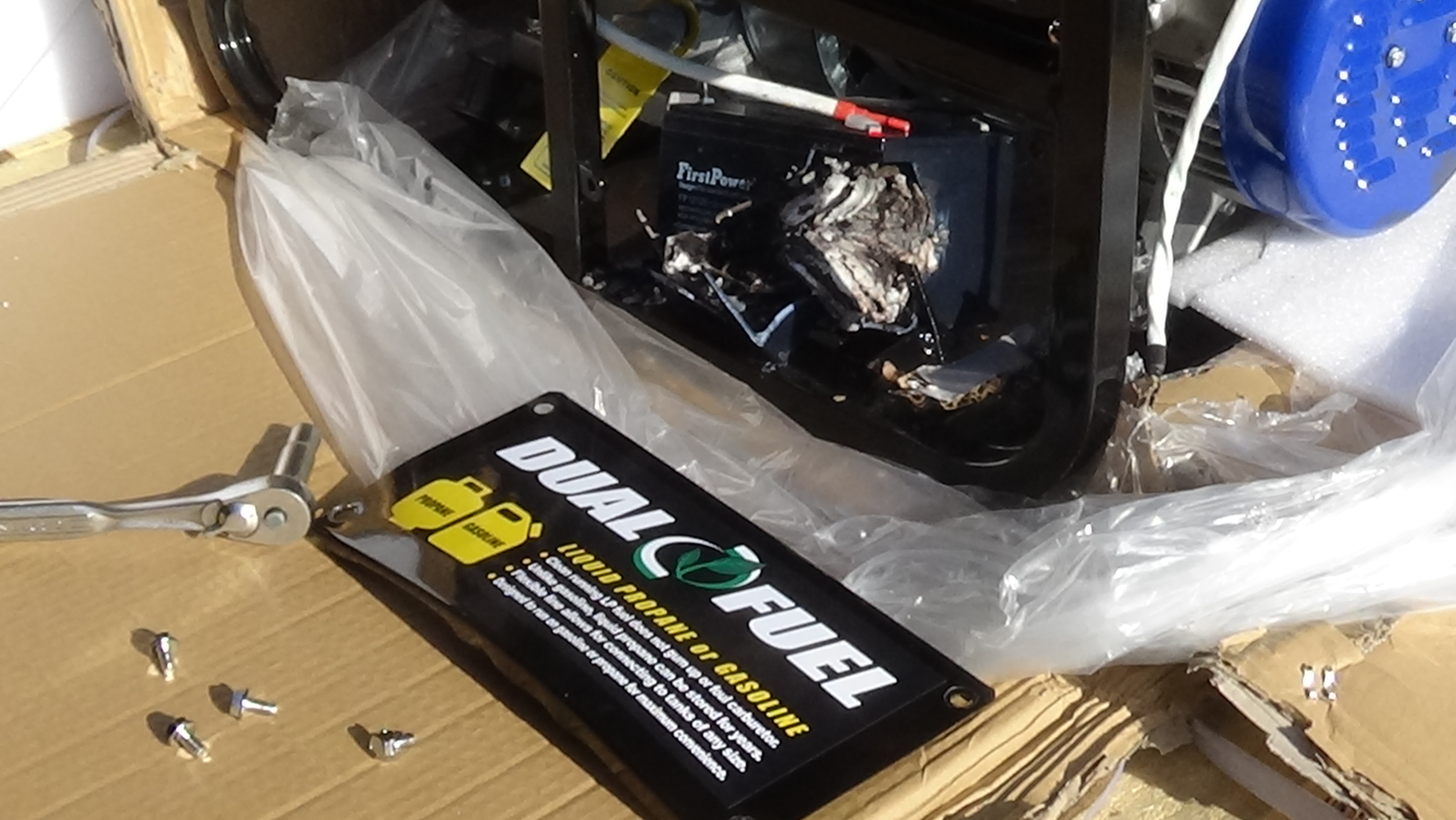

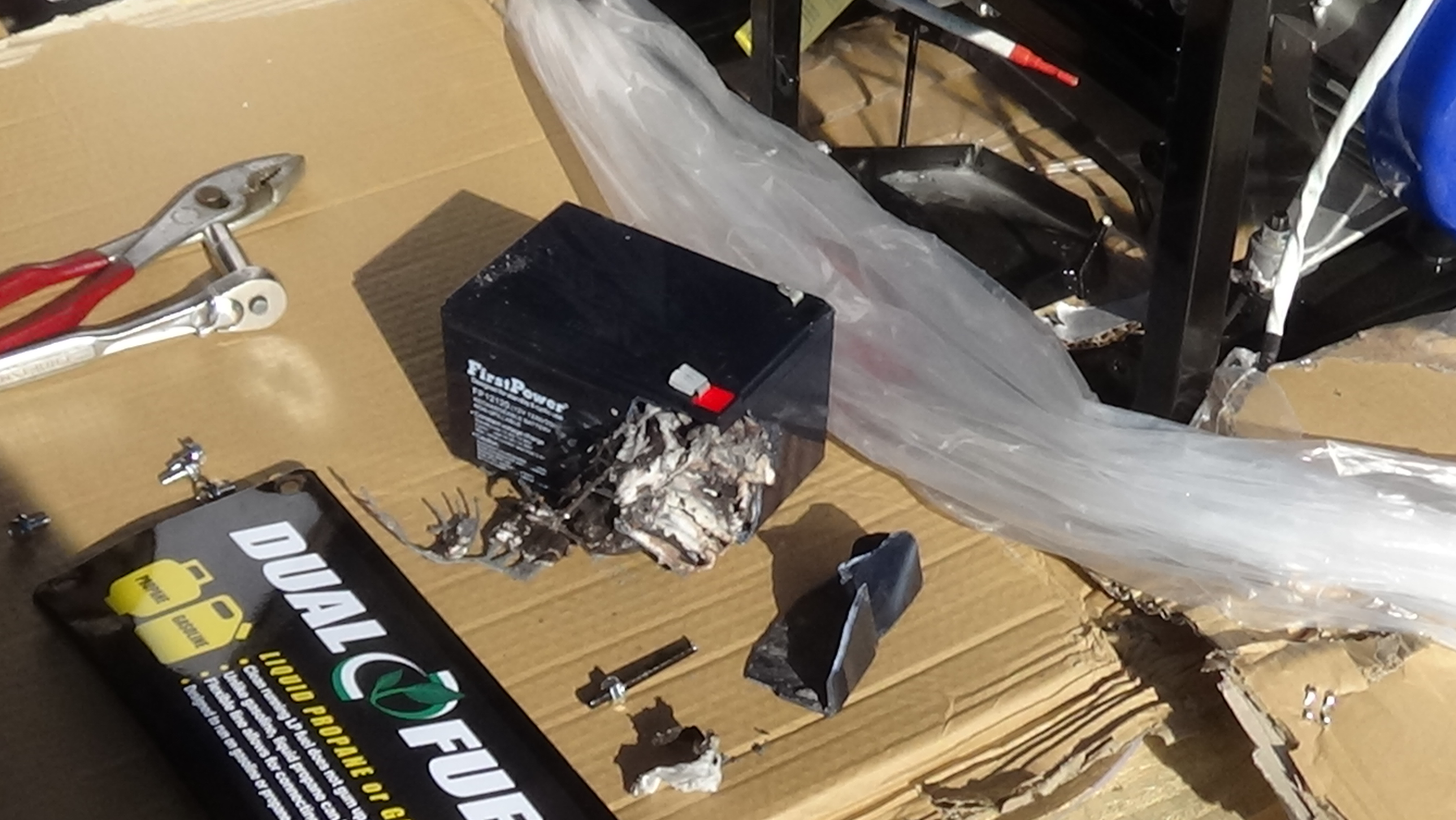

I saved the ad to My ebay and found it on sale 2 weeks ago for $699.00 and ordered it.
It seems they run the sale for short periods.
I got my generator and somewhere someone stabbed it with a forklift fork! :(
LUCKILY it went between the frame and the gen head and speared the battery.
I called, then sent pics by email and they sent me a new battery.
I told them I could straighten the battery box and repair the hold down.
I will add that the generator comes with a set of plugs (maybe $60.) a propane hose with tank fitting and 12 V charge cord.
