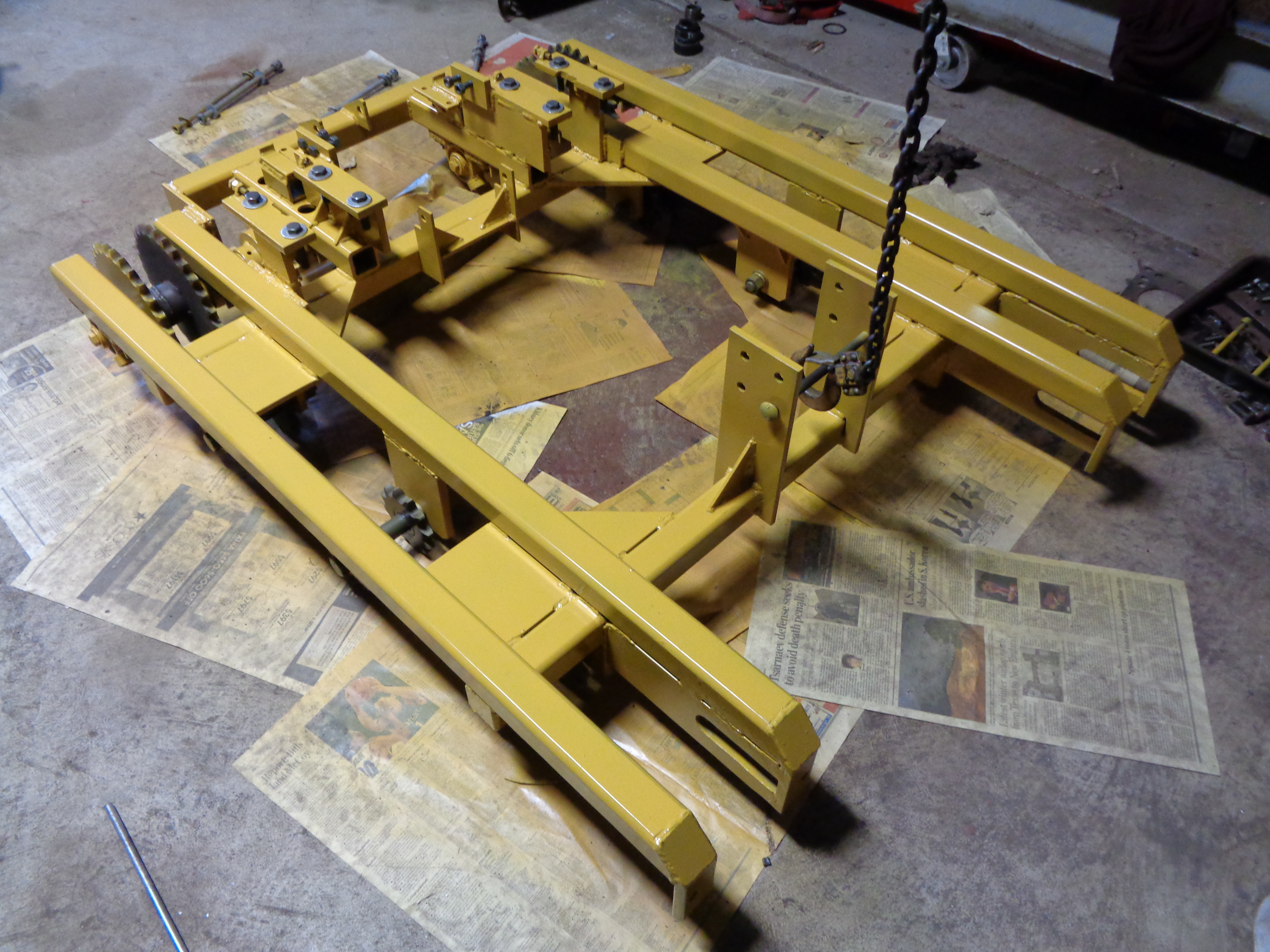

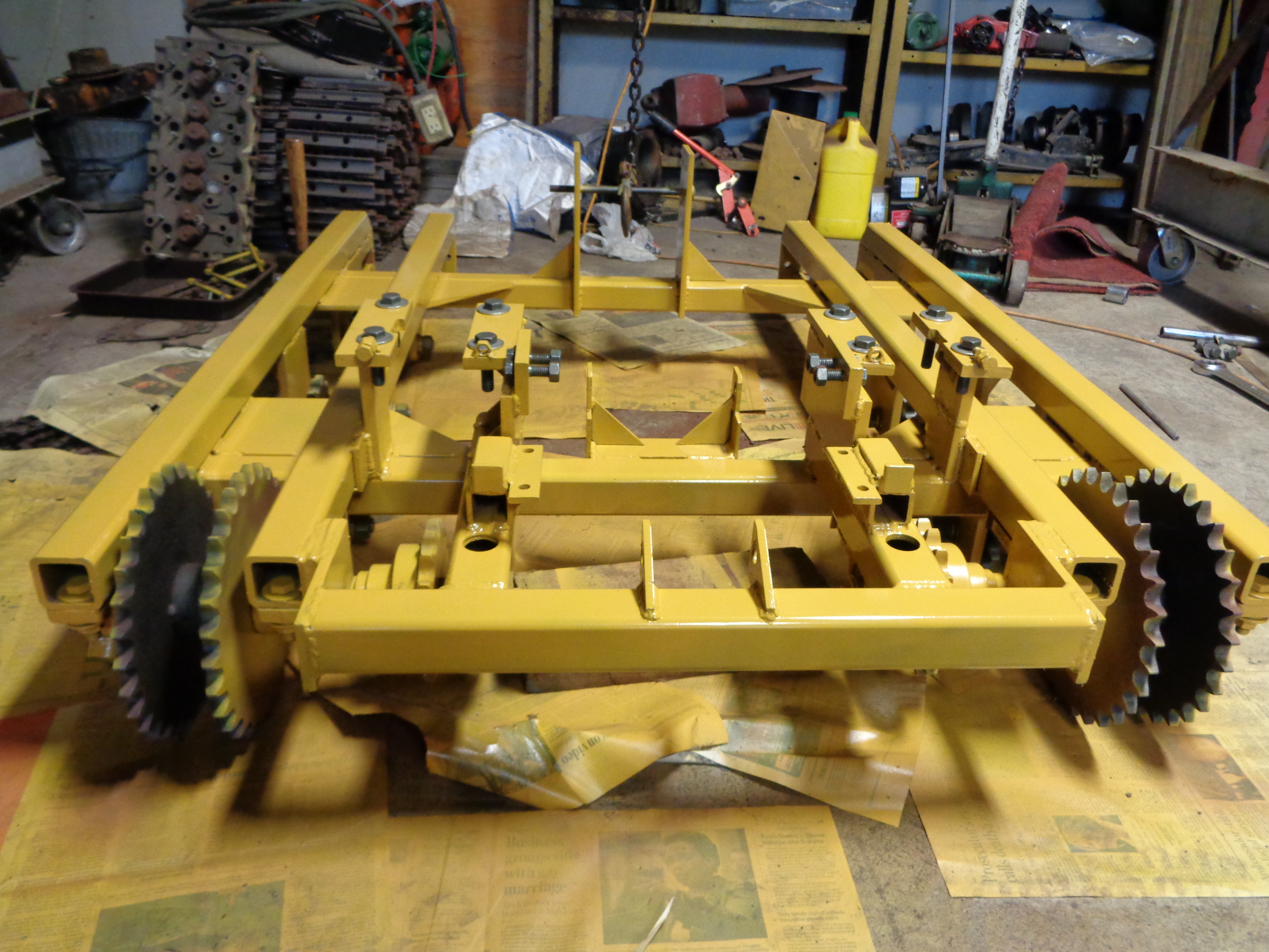

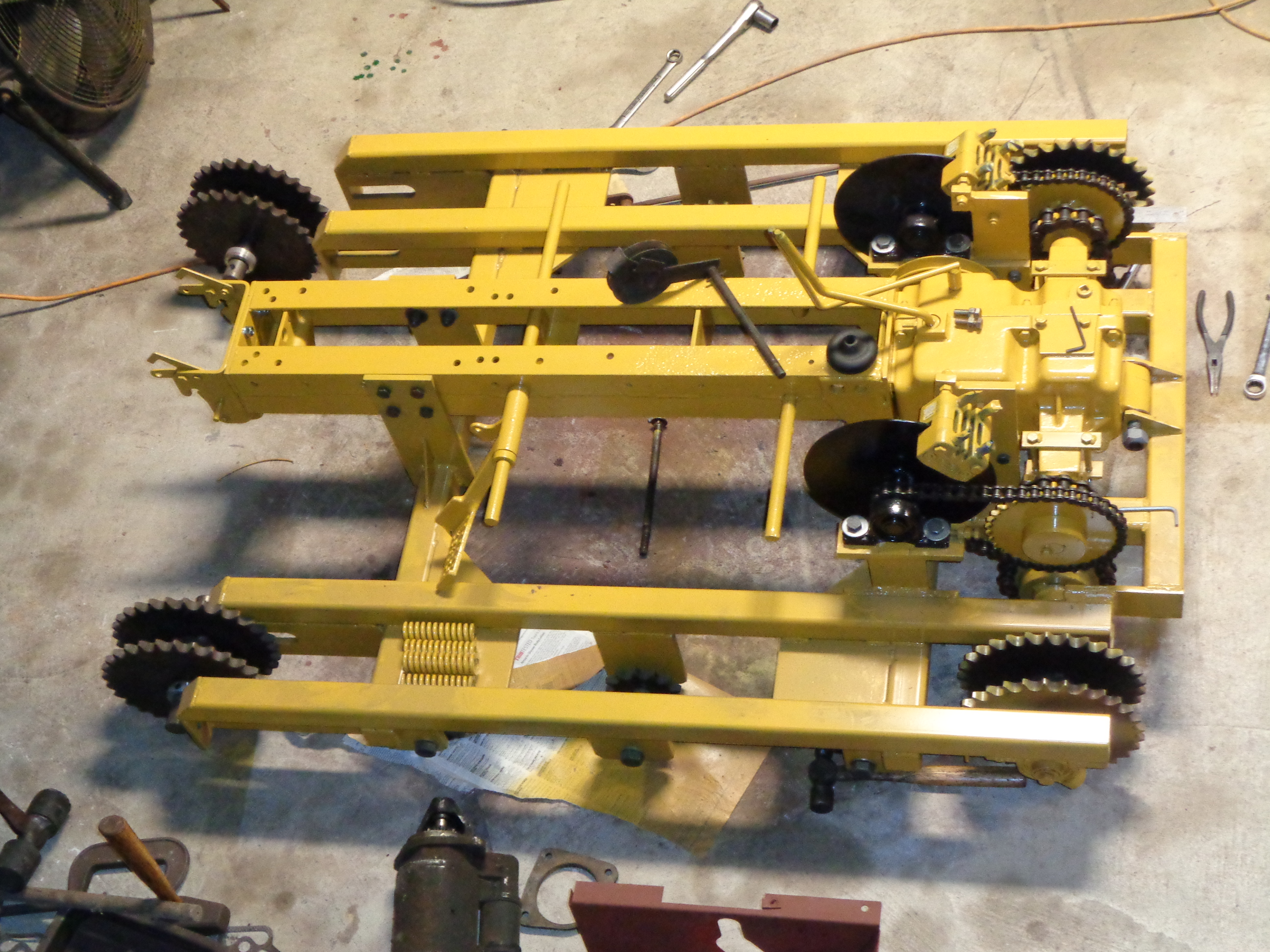

#24

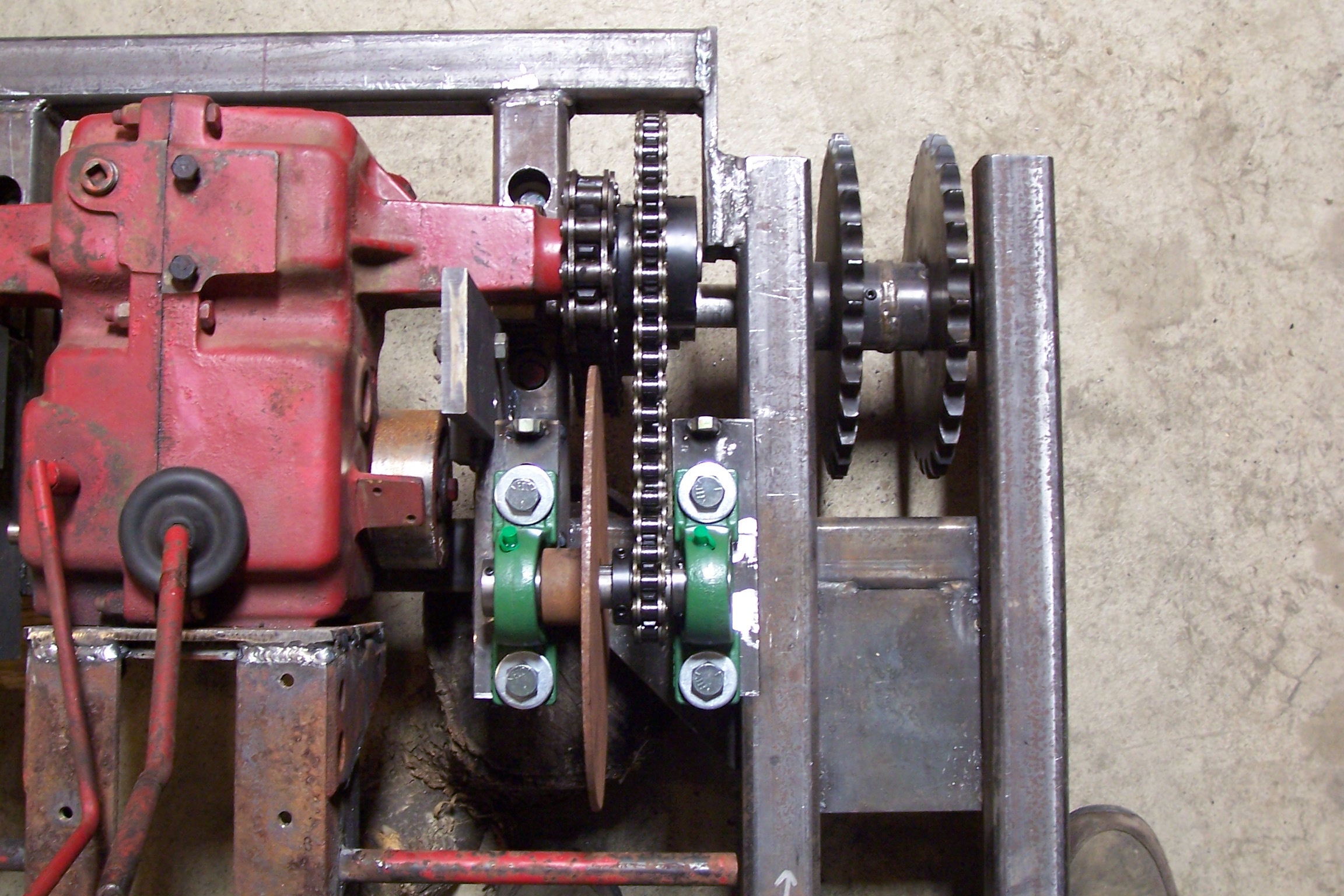

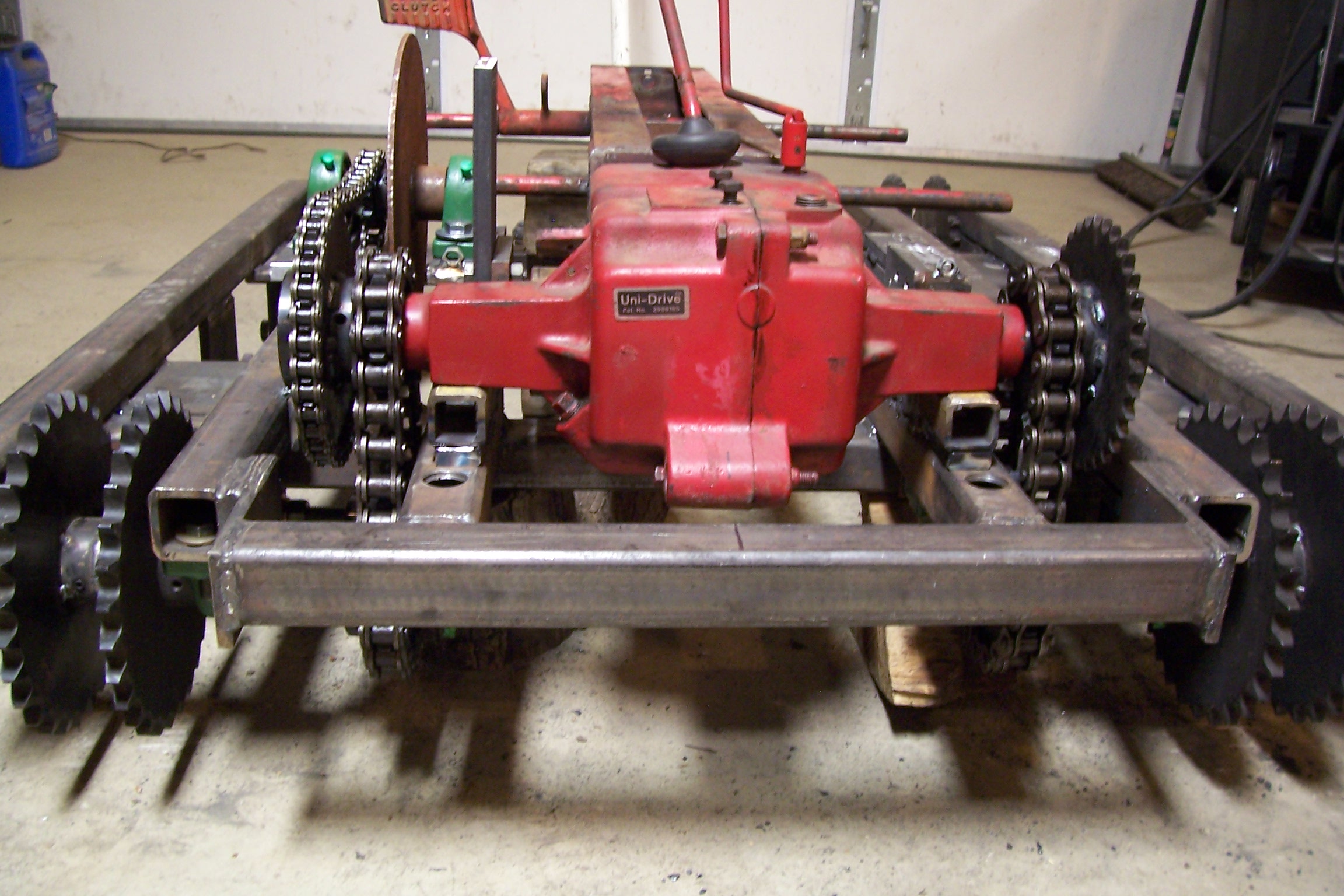

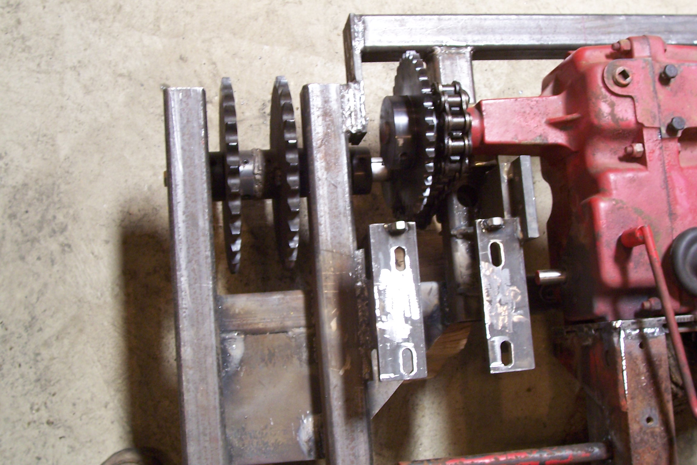

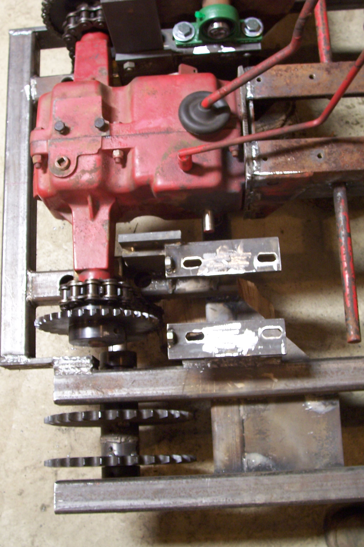

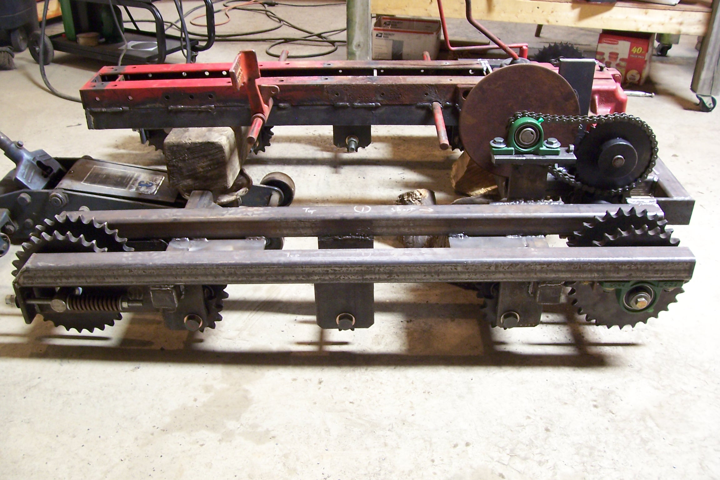

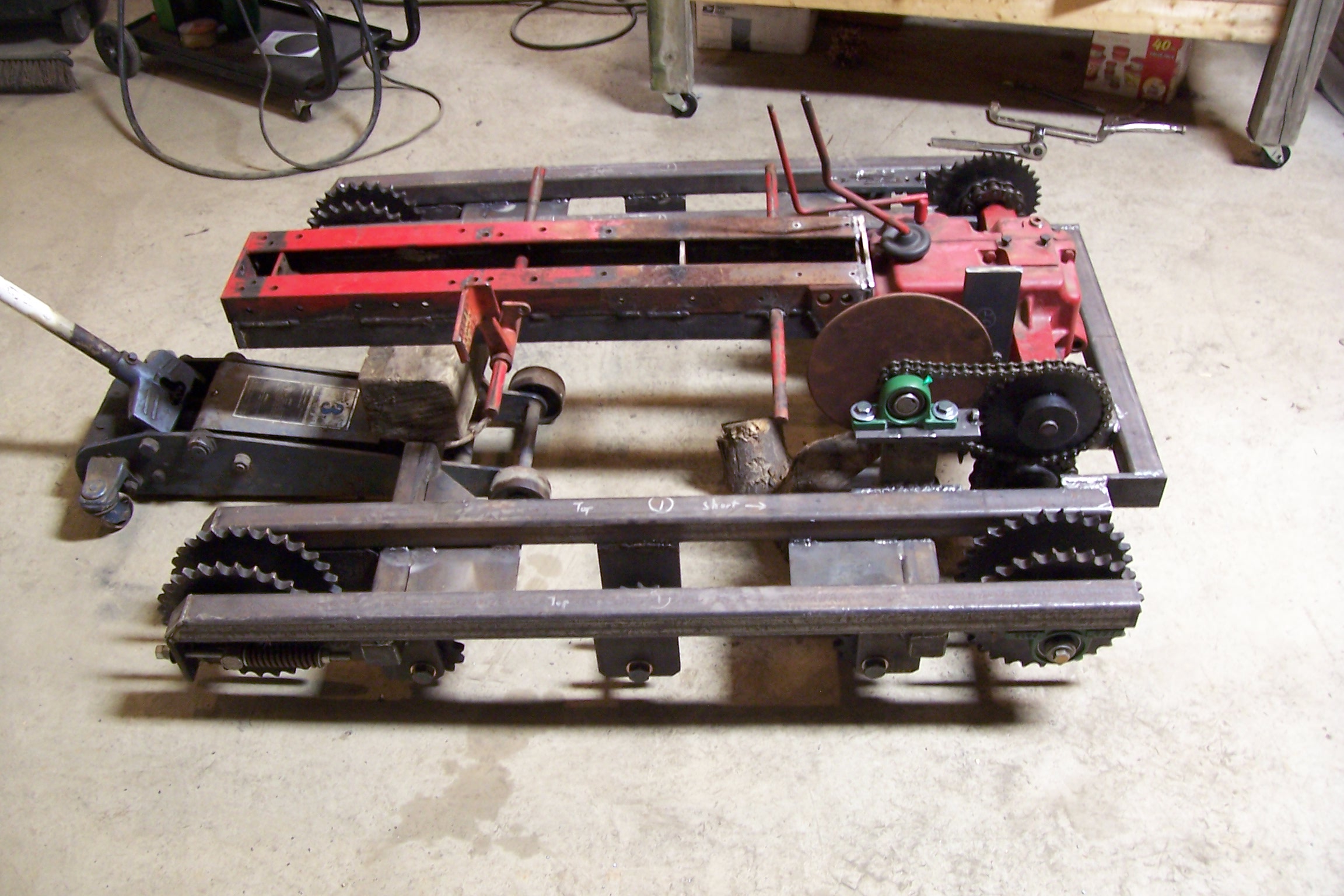

Ive been wanting to update this thread for a while but was having trouble uploading picks. I pretty much got the whole undercarriage done and painted. I am working on the upper frame and bodywork as the original bodywork was bad in some areas and needs some improving. All I got to do to get it running is an engine, get the brakes working and finish welding the track sprockets. Hopefully ill get it working this winter. Ill be posing updates as soon as the work progresses.

/ Wheelhorse Crawler Conversion #25
Awesome progress, I'm glad you didn't give up
/ Wheelhorse Crawler Conversion #26
That is looking really good!! Hope you can locate a good power plant.
