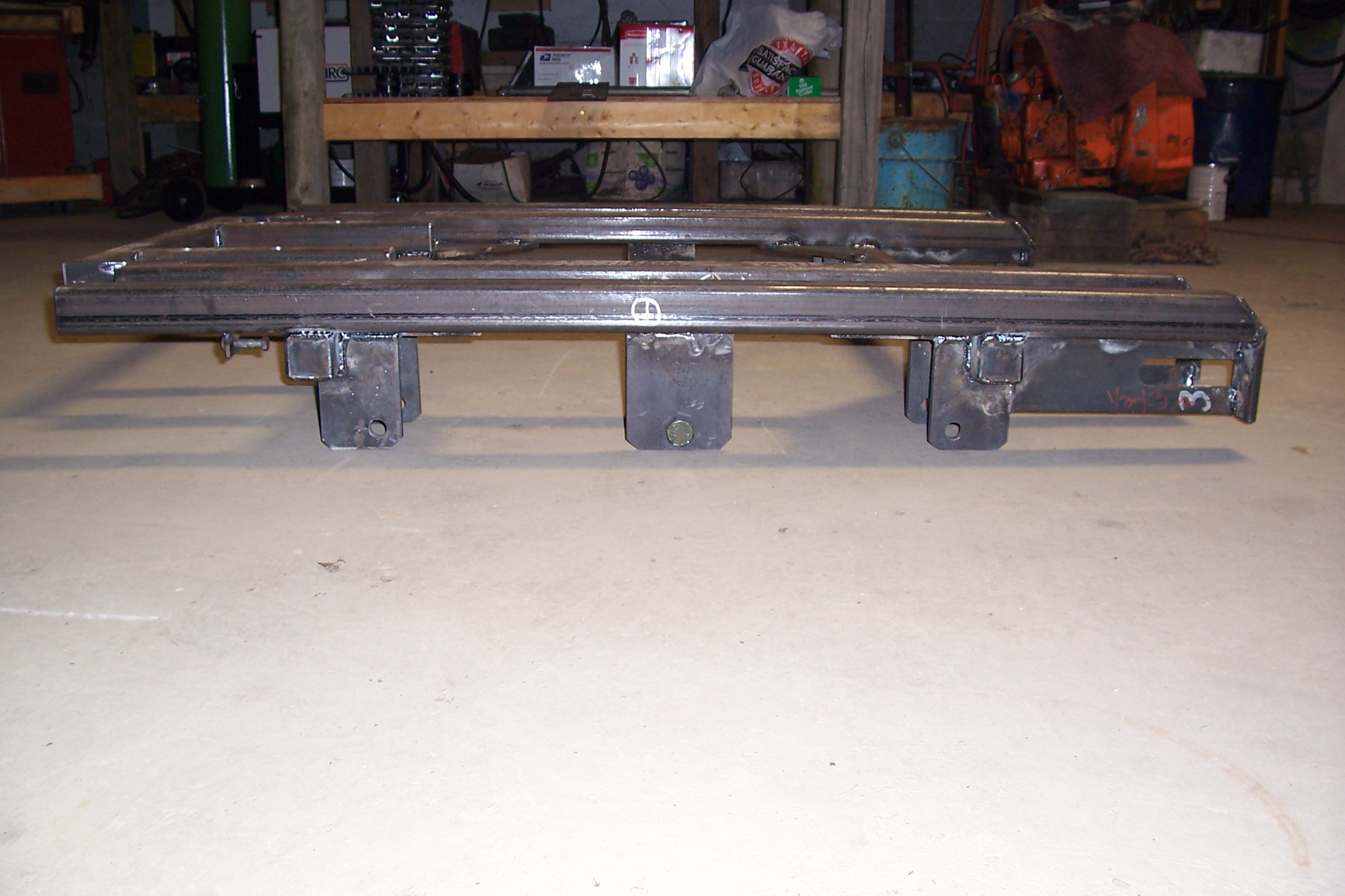

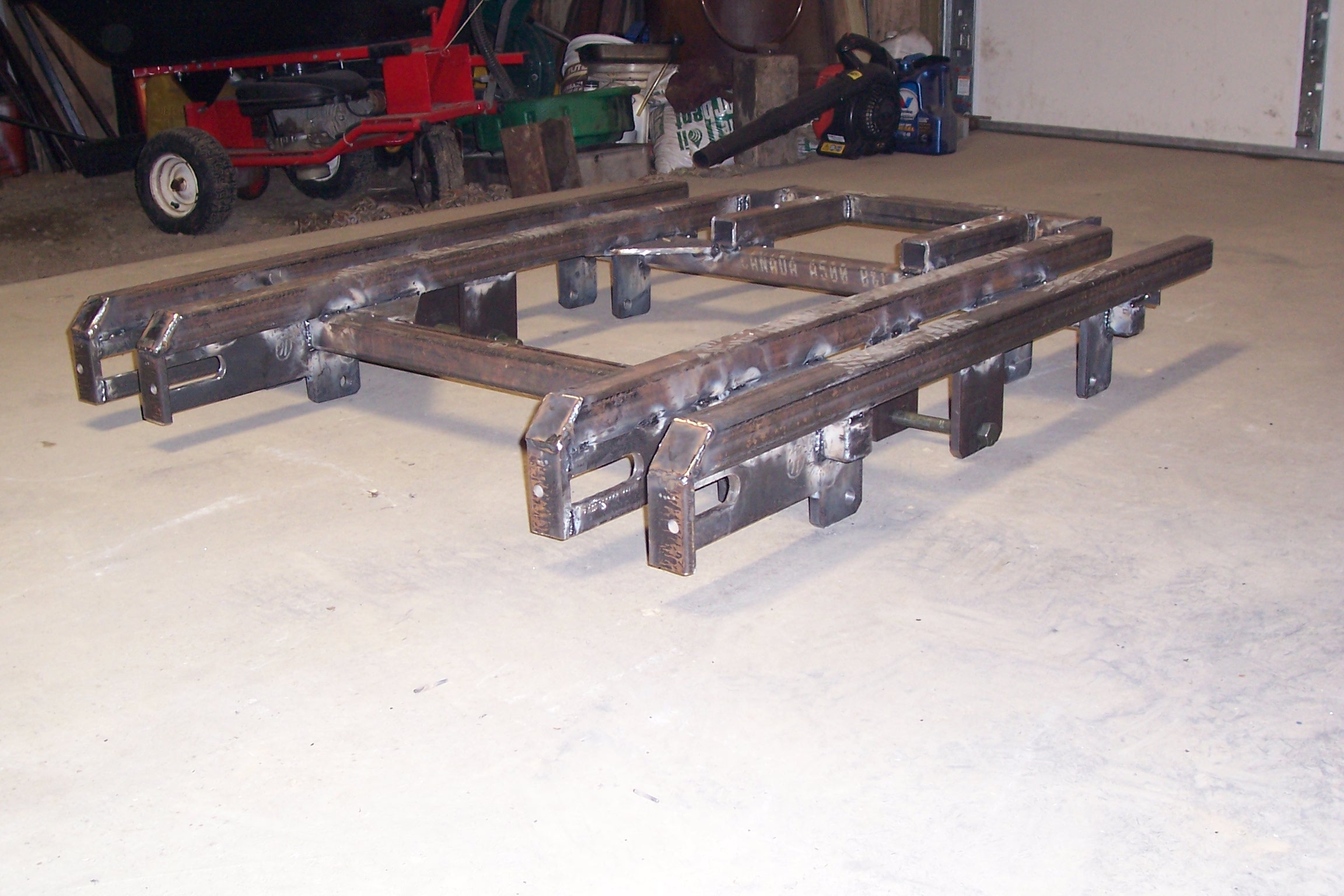

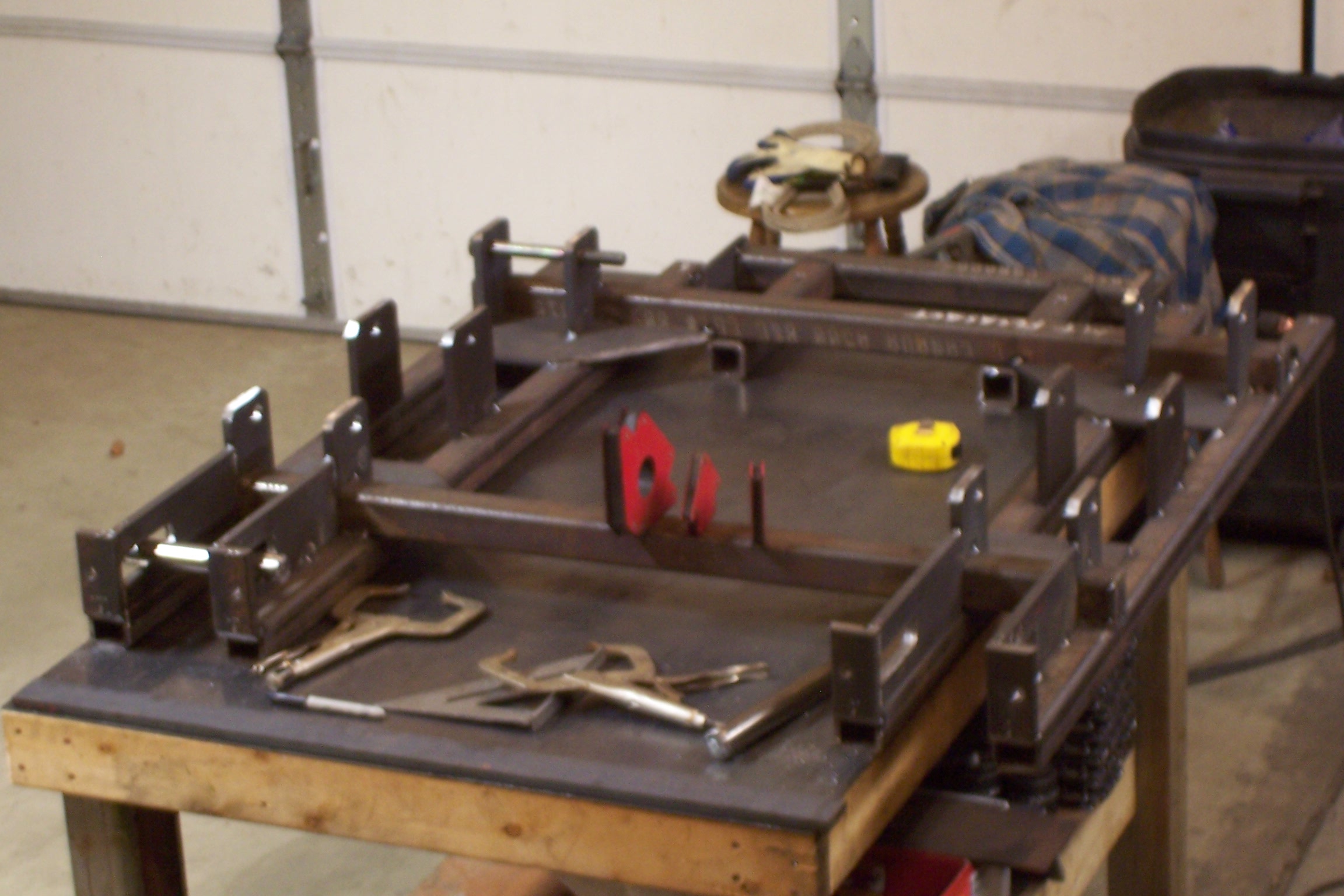

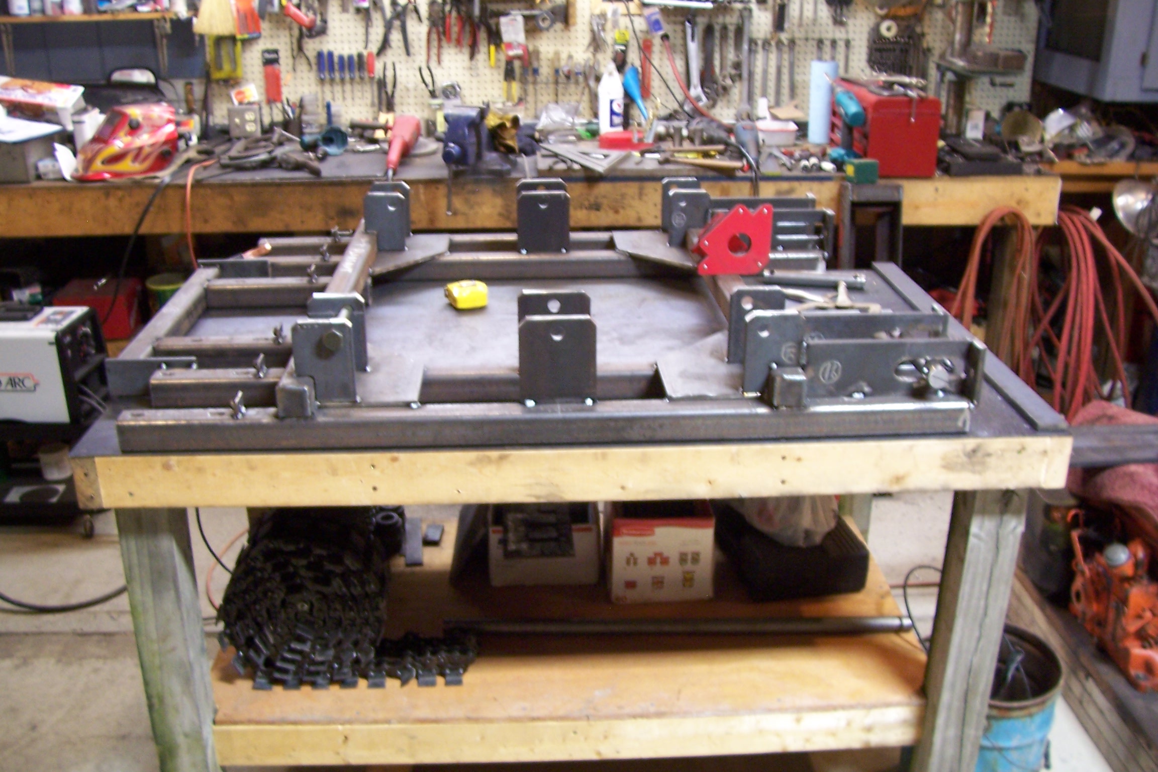

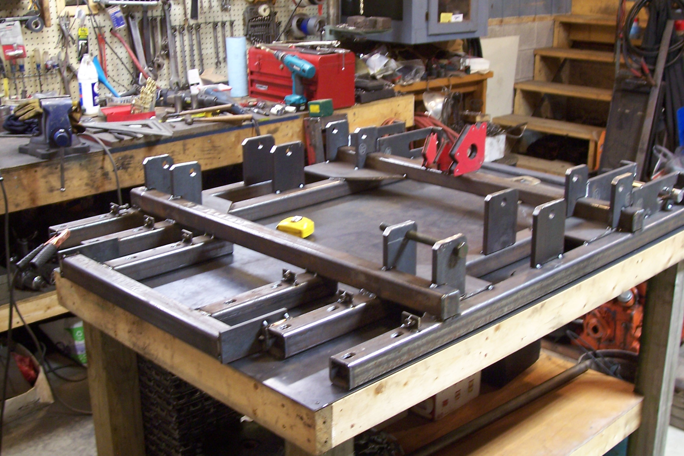

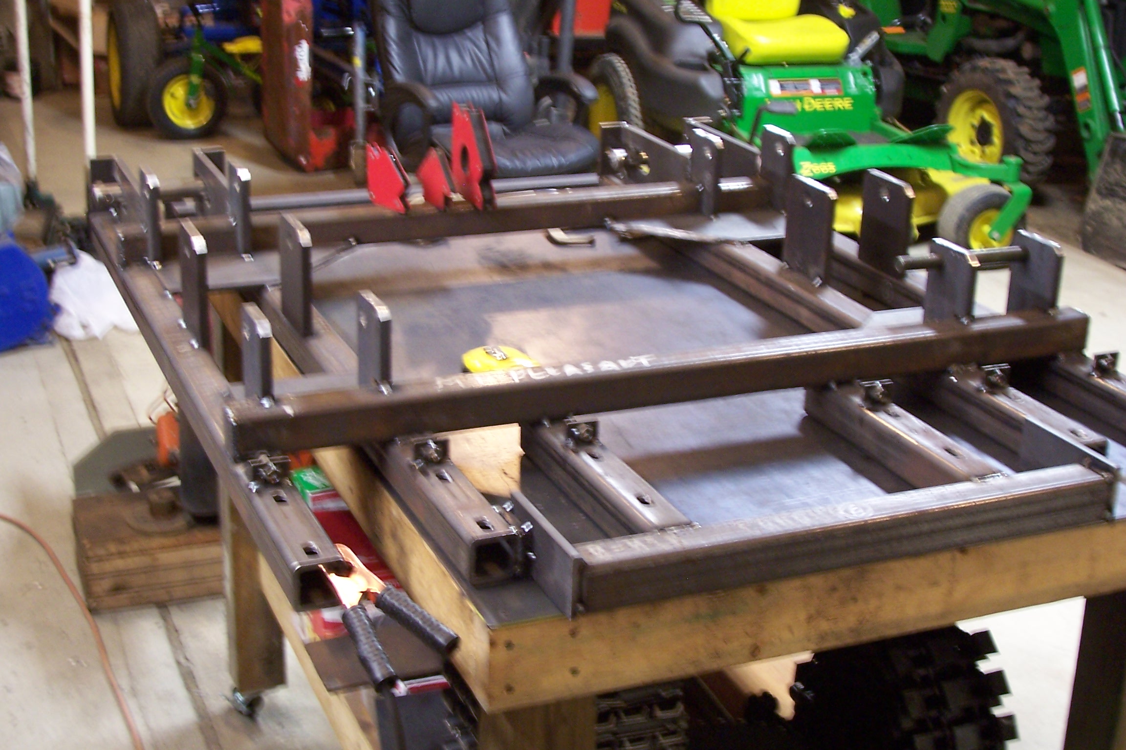

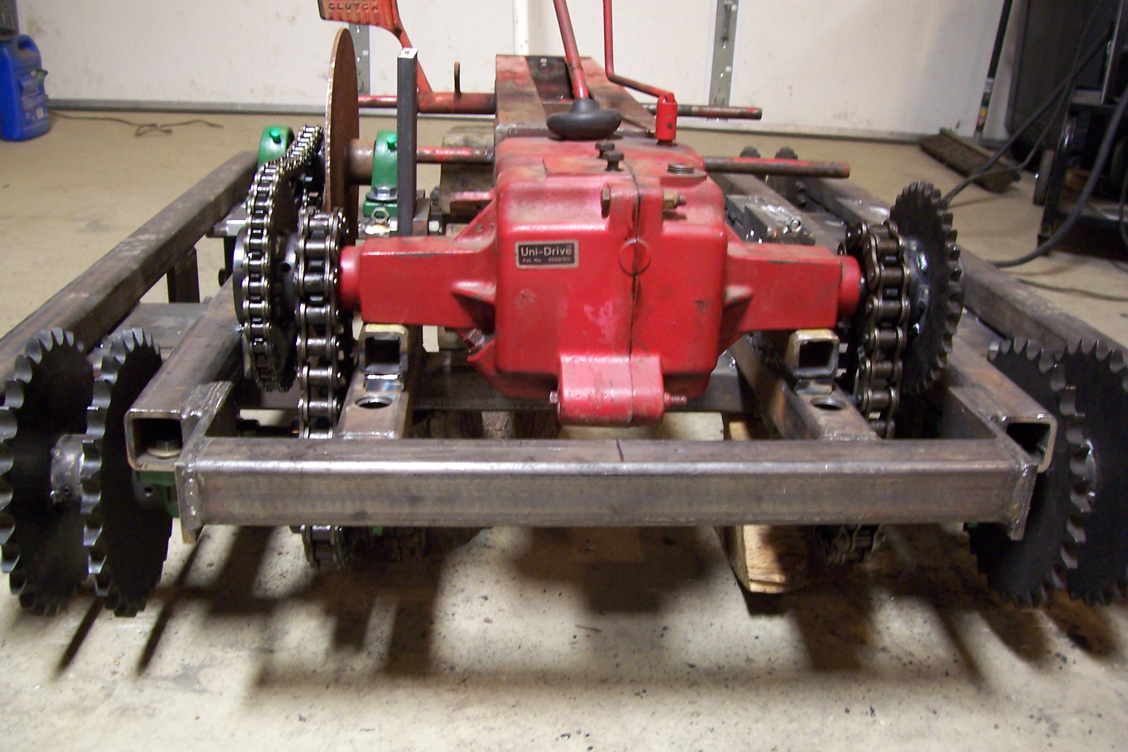

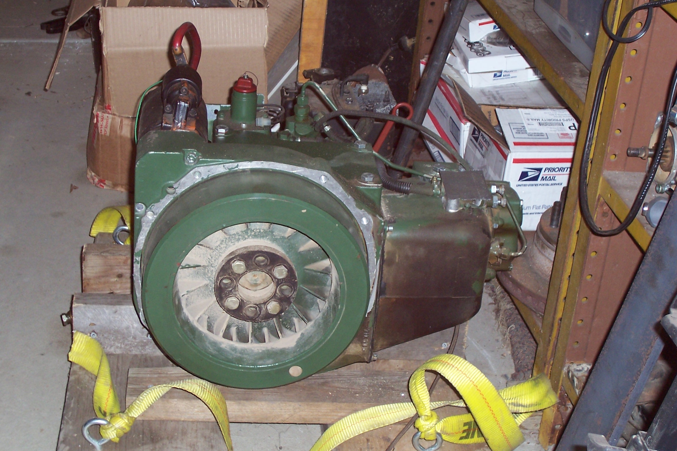

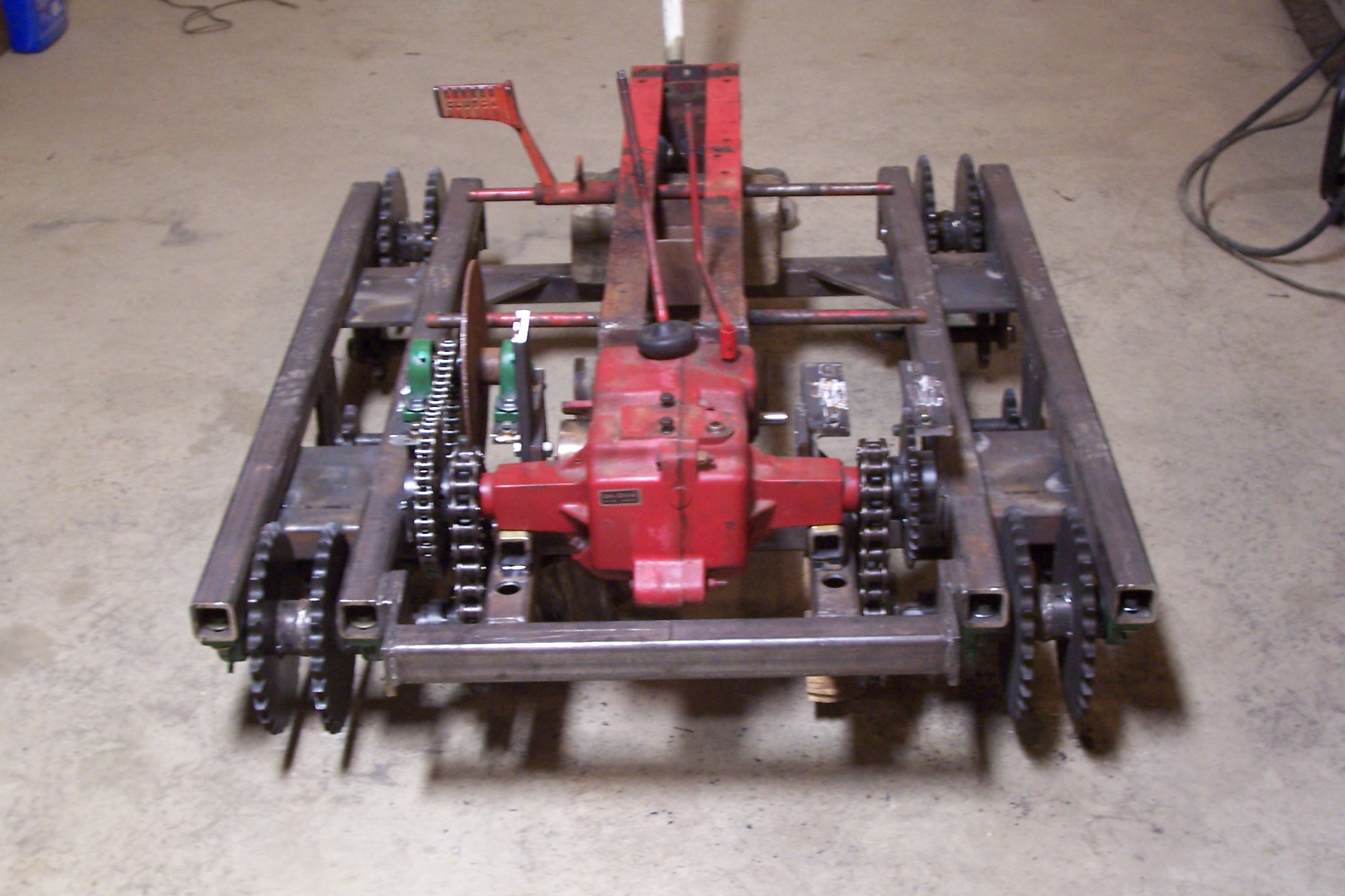

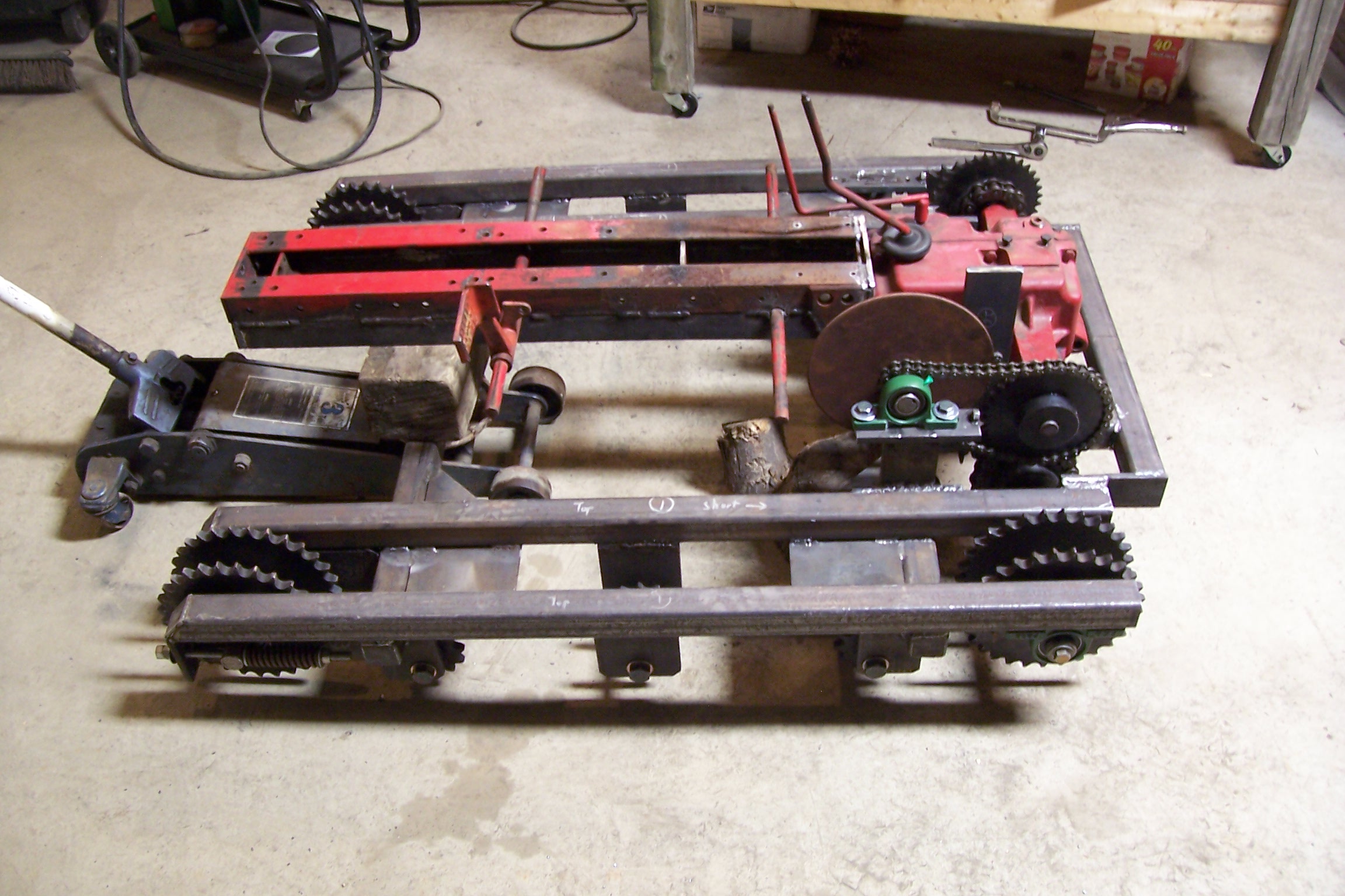

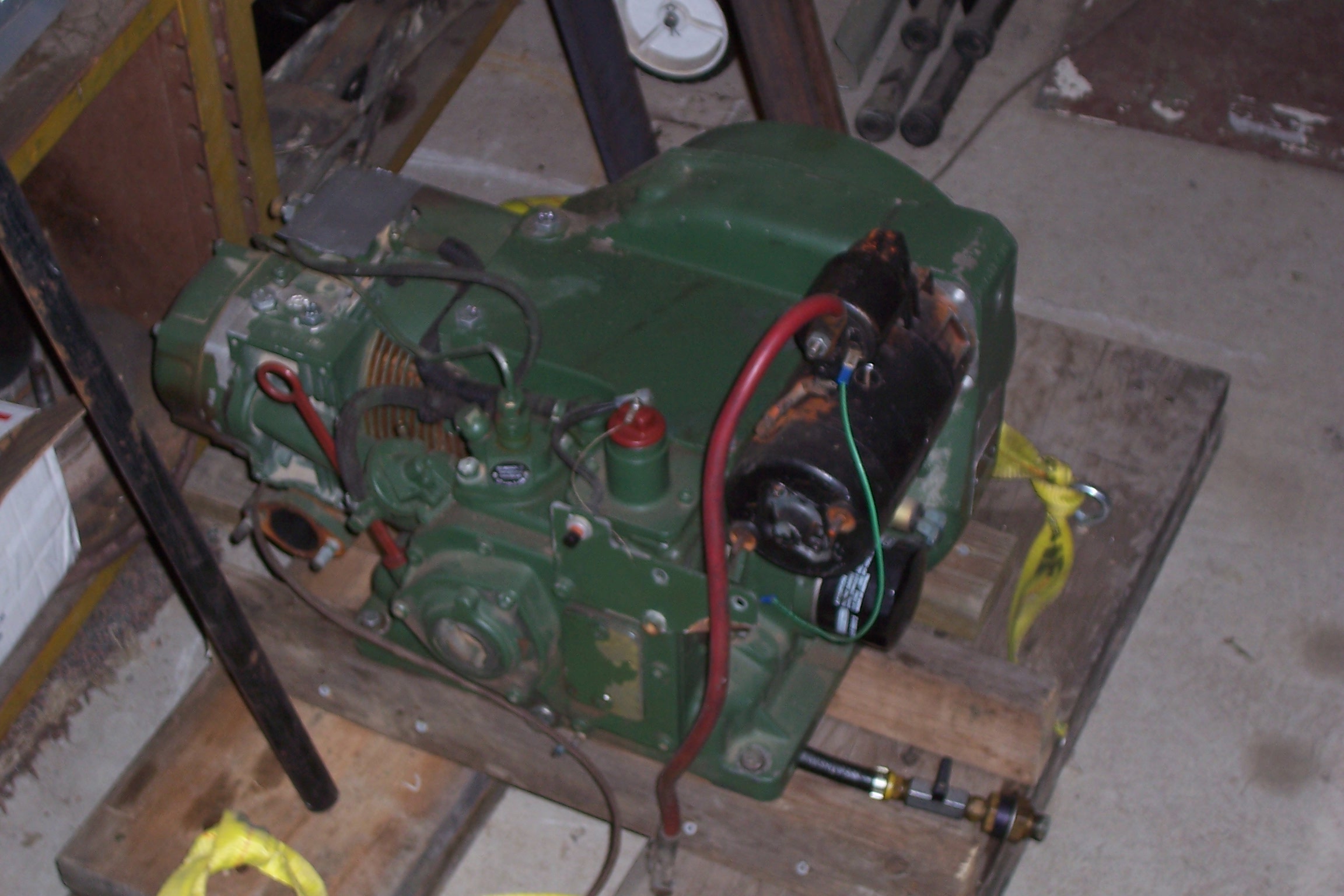

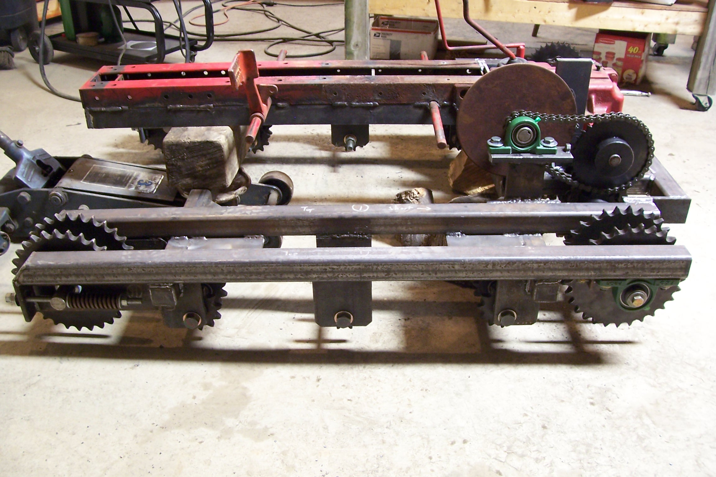

I bought plans from ubuilditplans.com for their newest plan to convert an ordinary wheelhorse tractor into a crawler tractor. I have been collecting the metal and mechanical parts over the last few months and am now finally making some headway with the build. I have one track assembly tacked together and got the undercarriage assembly all cut and tacked together. I am very pleased with the plans as they are very well written and very easy to understand. I would recommend u build it plans to anyone. The plans call for a dozer blade run by an electric winch, but I am being very ambitious with this project and I want to build a front loader for it later on. I plan on using a 15hp Farymann diesel engine I acquired to power it. Its very heavy and is much wider and longer than the stock Kohler was. I am following the plans as close as possible but I made a few changes. The plans call for the use of 3/16' square tubing, I went with 1/4". I also added an additional third idler sprocket to the undercarriage as the plans call for two per side. It uses the stock 8speed wheelhorse transmission and the crawler steers with two 10" brake disks that are chain driven on independent mounts chain driven to the transmission. I'll post more pics as work progresses. It will probably take the rest of the winter to complete. It is a very fun and interesting project.

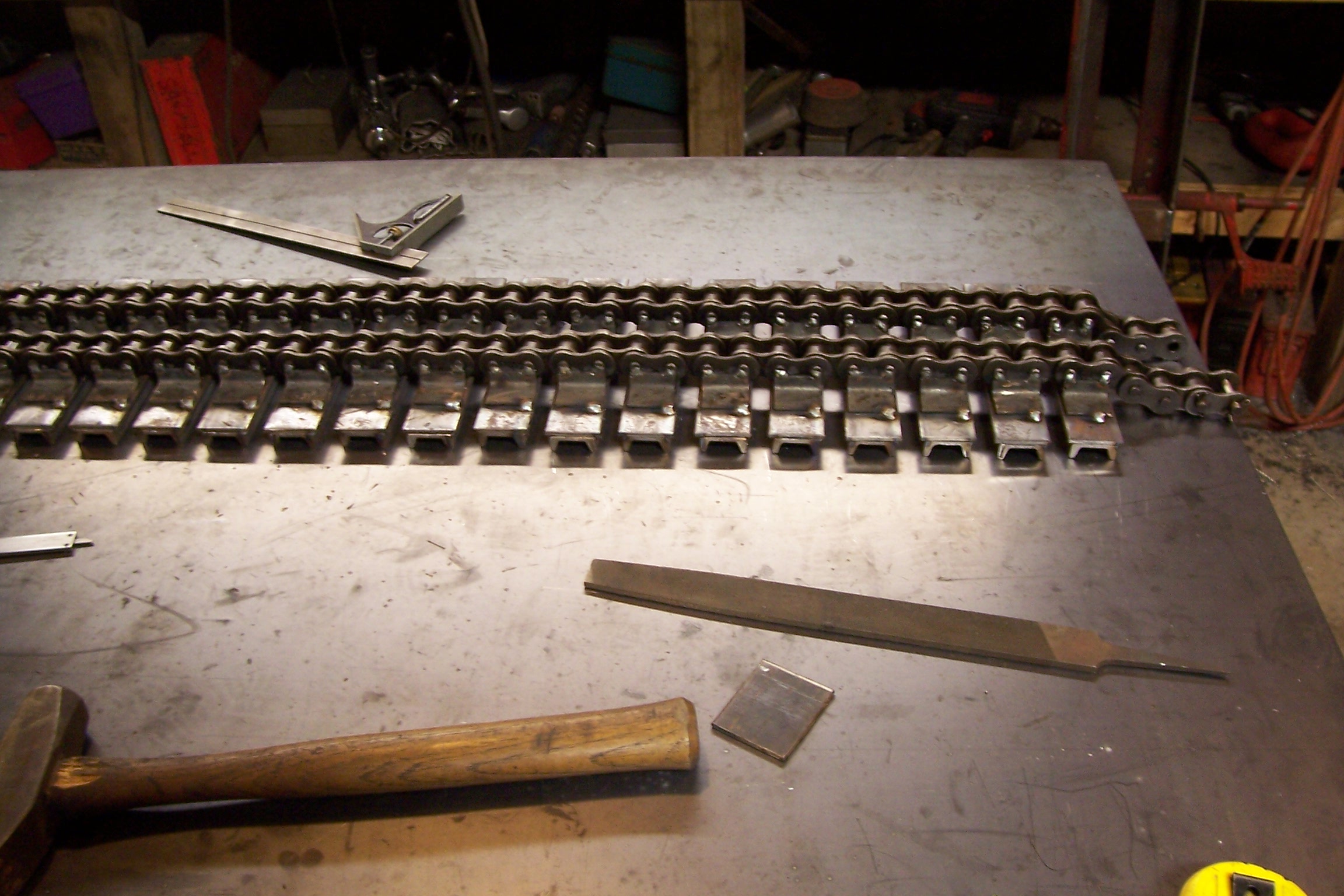

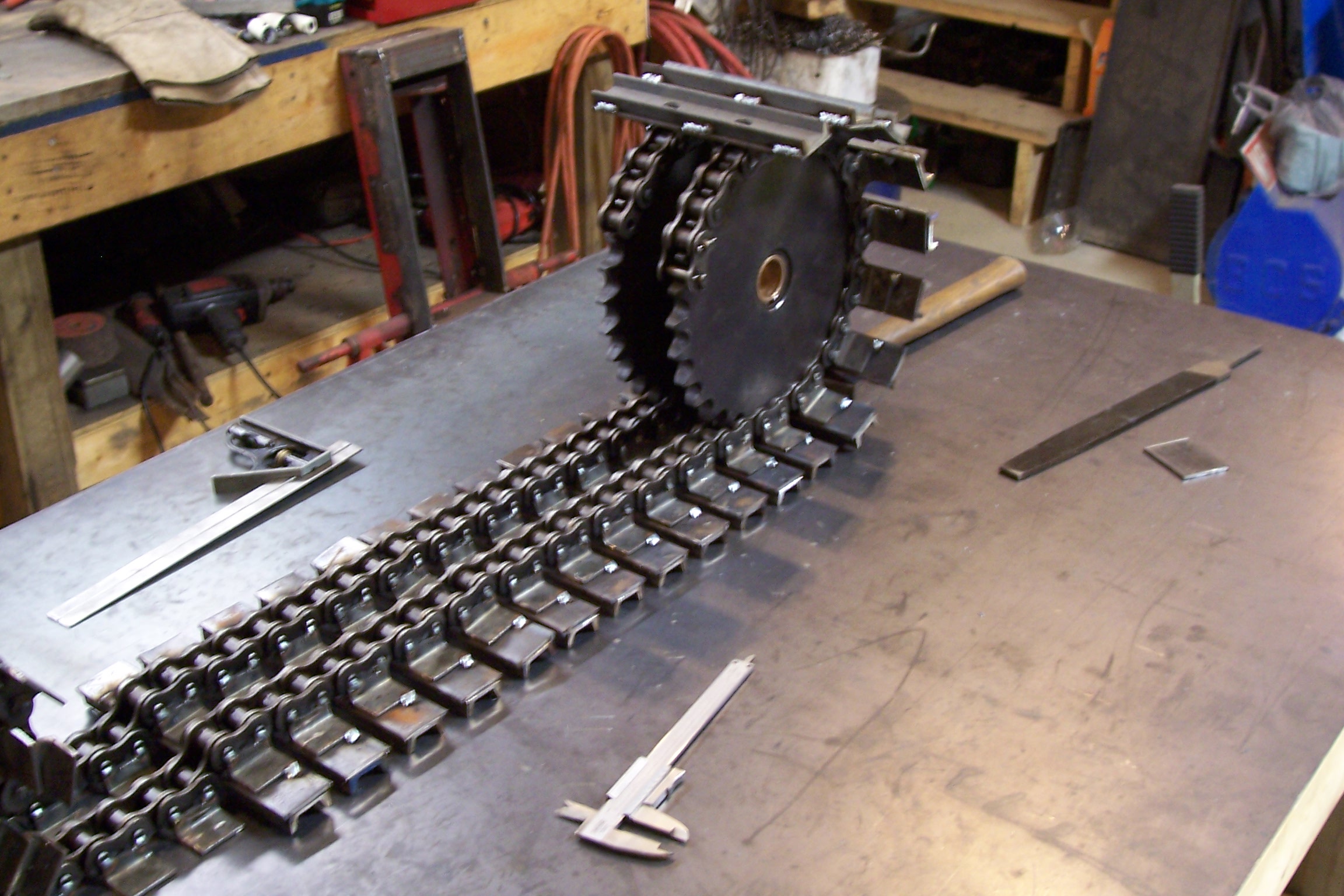

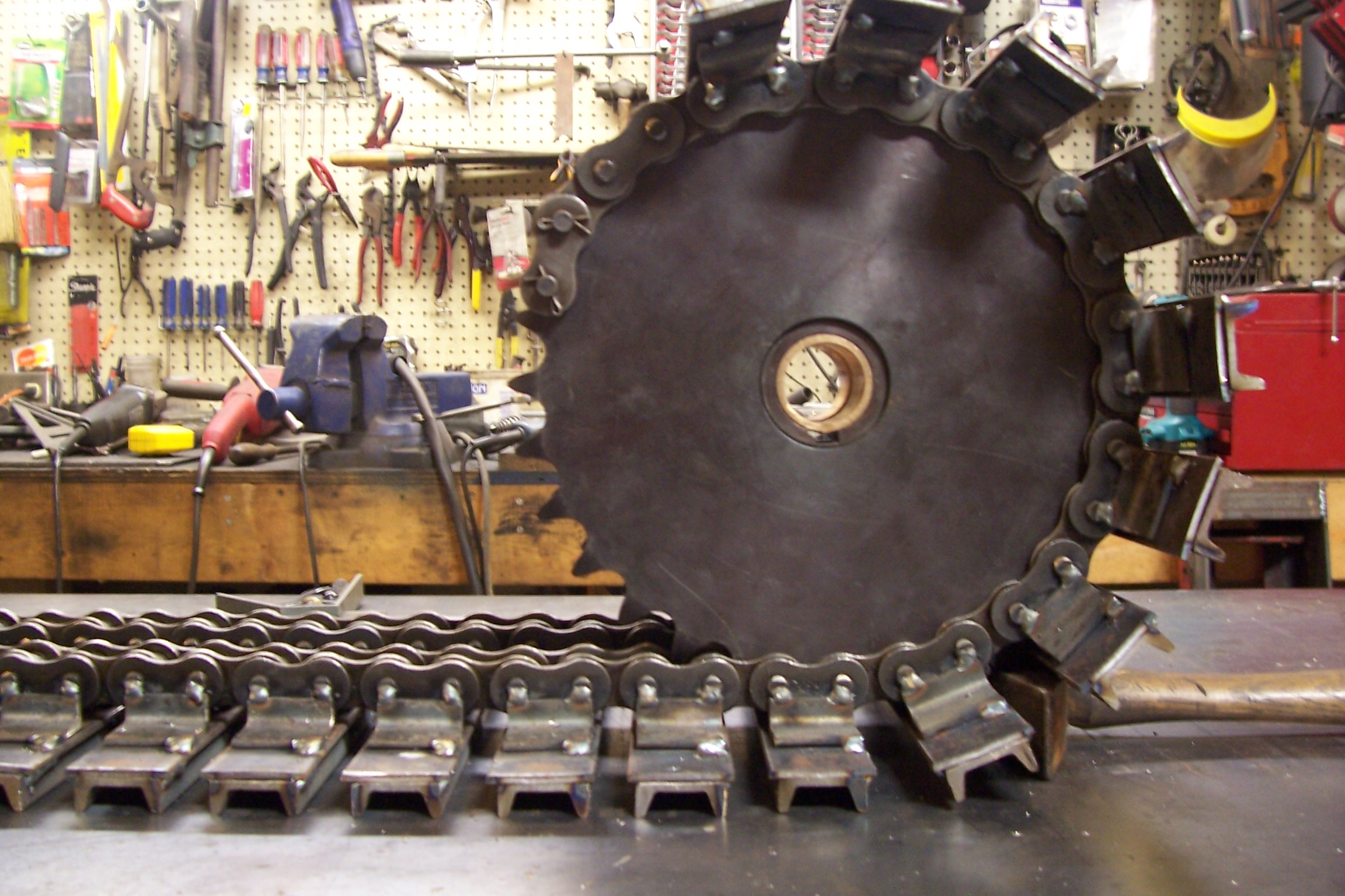

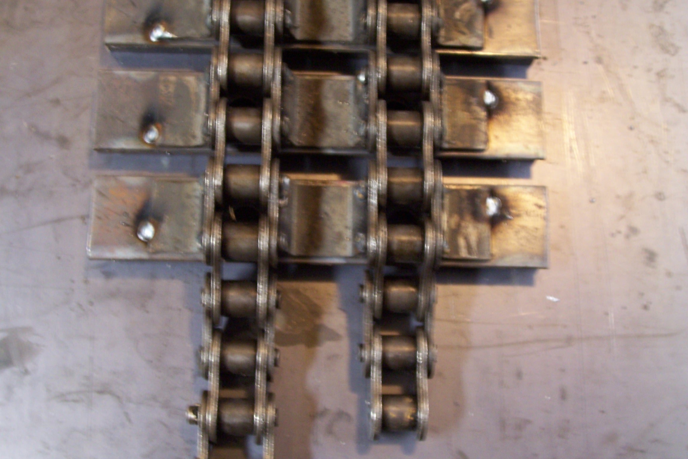

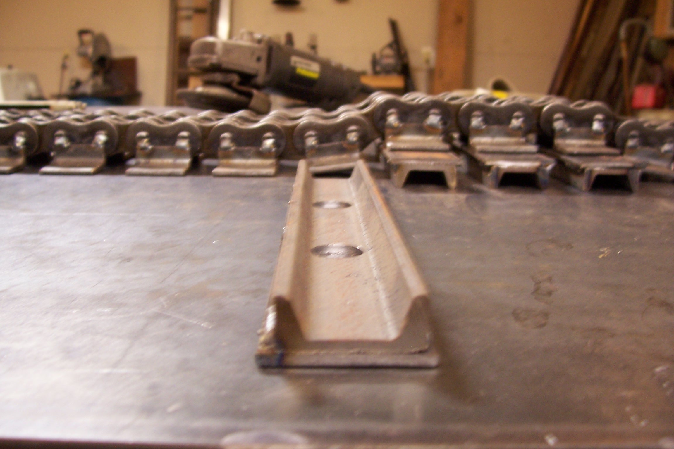

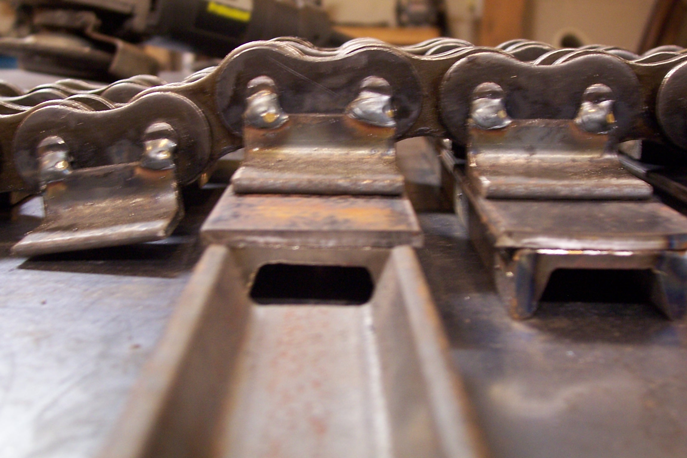

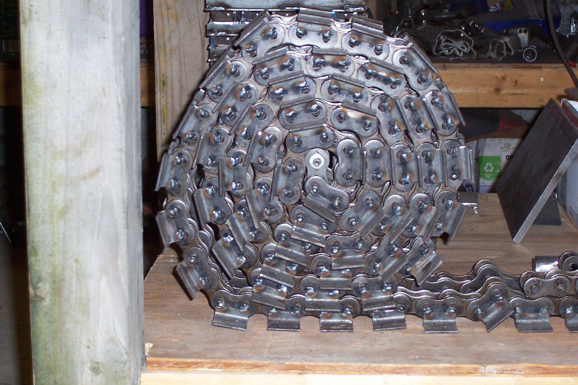

Very cool! Looks like a very fun project. Can you post some more info on the chains?
/ Wheelhorse Crawler Conversion

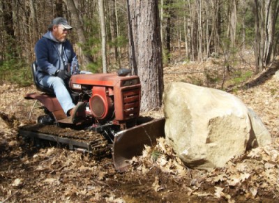

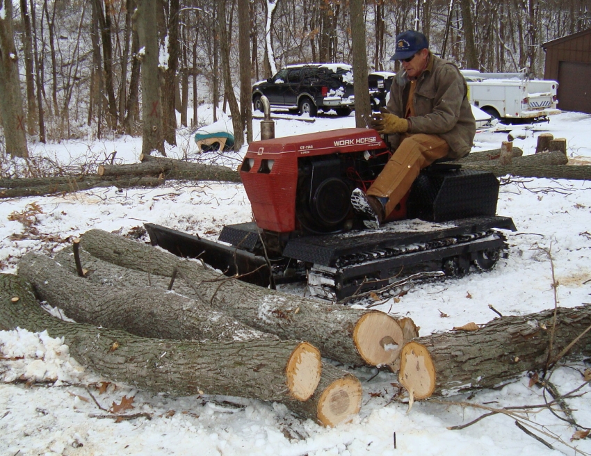

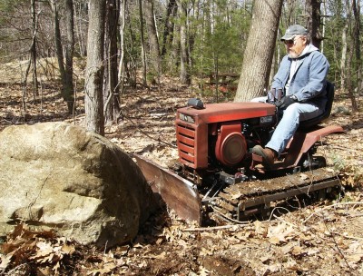

Hear is a pick of the designers prototype and an example of what one looks like. As for the tracks, they are made from 4 lengths of #80 roller chain. I got lucky and found them for $25 a piece on ebay. You have to make track brackets from 1" channel and 1-1/2" C channel. Then you make a jig to line up the three track brackets to weld to the sides of the roller chain. The tracks are by far the most tedious part of the build, but it is relatively easy with the jig. The first two pics are the prototype, the others are a customers machine.

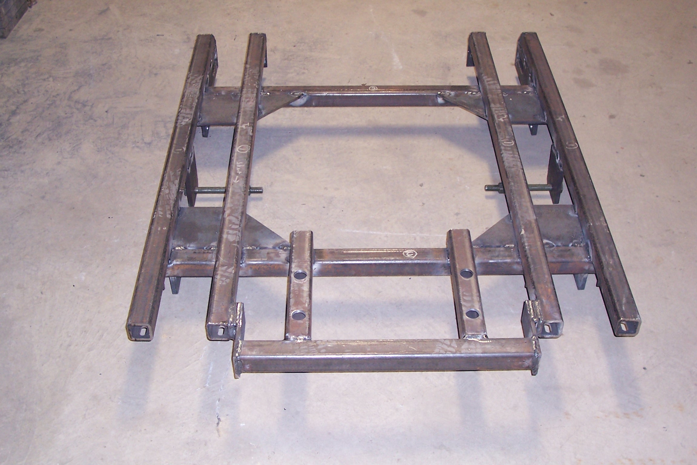

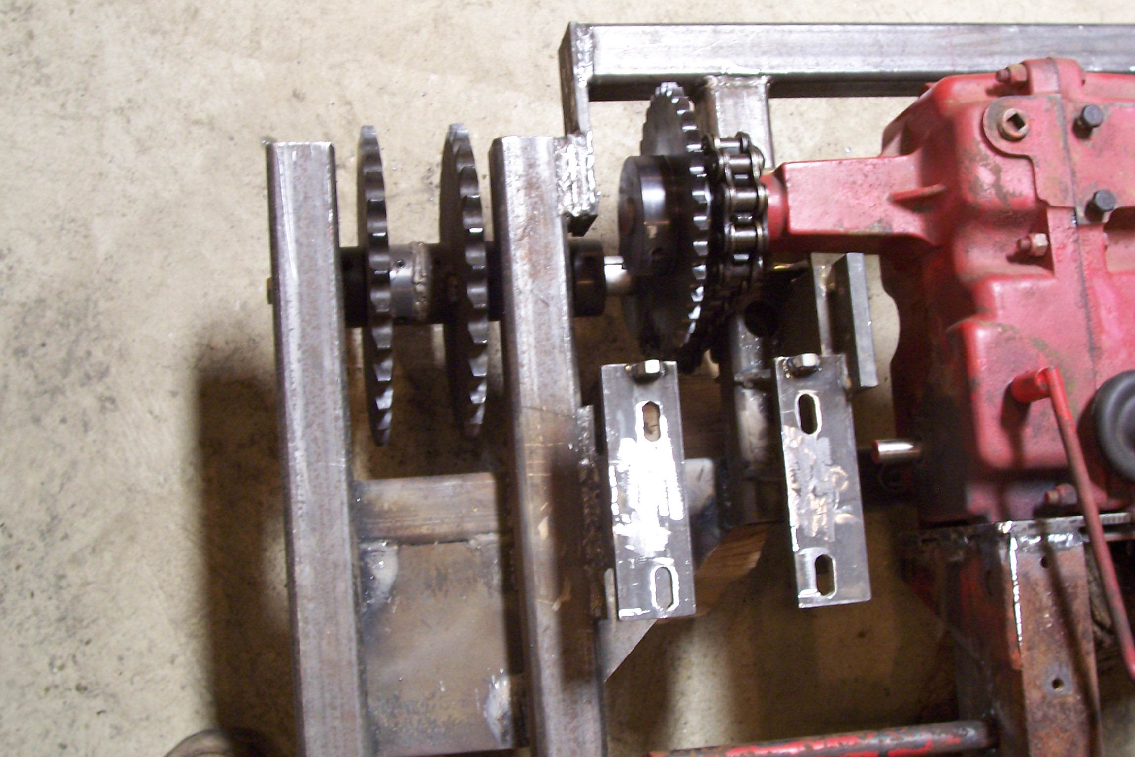

Hear is an update. I got the undercarriage all welded up, and I started back to work on the tracks. haven't had much time to work on it as the weather is so nice this week. Got started tacking the track shoes to the track bracket plates. Its a bit tricky getting everything to line up as there is a lot of little parts to work with. I am overall happy with the way things are going but im having an issue with getting the sprockets to line up with the track chains. Its got to be just right. Hear is some more pics.

/ Wheelhorse Crawler Conversion #11
My this is a interesting project. It came to my attention through the engine you have chosen. I am looking at buying one myself. Odd but interesting engine.
Can you tell us why you chose it and how you plan hooking it up and using it?
Thanks
DS
#12
Down South,
To answer your question about the engine, I acquired it when I traded another small air cooled diesel ( a Hatz 10 hp) for it. This Farymann is practically unused and in excellent condition. Another reason I am using this particular engine is because of its size. It is rated at 15hp and has 709cc displacement. It should have a lot of torque for this size engine. I done a bit of research and these Farymann engines seem to be used in very harsh and demanding applications so it ought to be very reliable. It is considerably wider than the stock kohler that came with the tractor. So I will be using a jack shaft directly behind the engine to get correct alignment for the pulleys and to power a hydraulic pump and an alternator. I will show this as the build progresses.
Ross

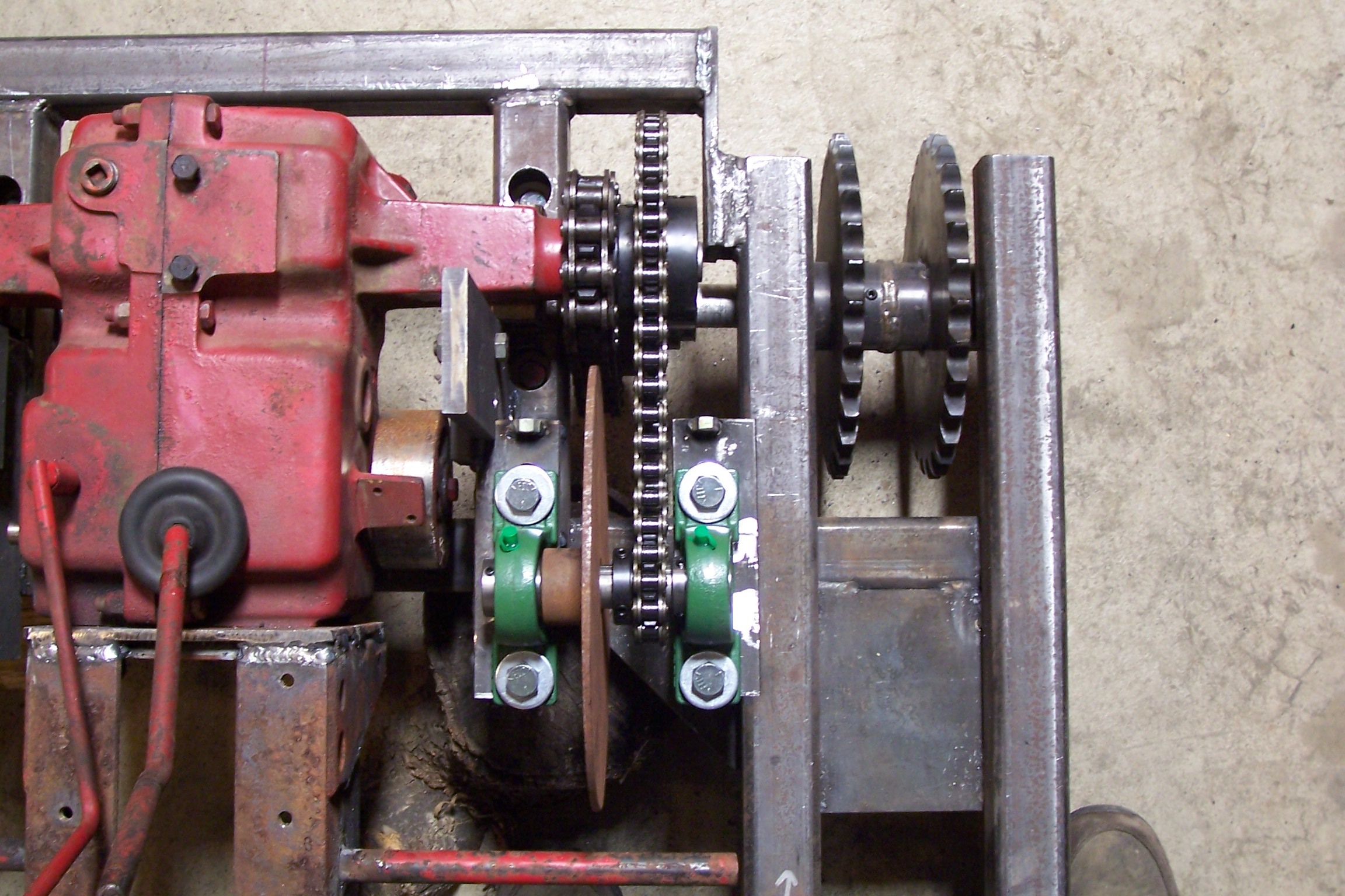

Hear is an update to the project. I finally got the tracks completely welded and I also got the upper frame modified (strengthened) to handle more of a load. I just got done fabing up the steering brake mounts and I am now working on getting the upper frame aligned to the lower track frame. There is a lot of alignment issues in order to get all the drive chains to run properly without touching any of the frame components. There is not much room for side to side adjustments. Anyway once I get the transmission all lined up with everything, I will be able to fab up all the rest of the upper frame mounts and begin work on mounting the engine and related parts. The tracks are by far the hardest part to build as there are hundreds of little pieces to cut and weld and to get it all to work perfectly with the sprockets and undercarriage parts. The next hardest as I'm now finding out is getting the transmission to connect up with the driving sprockets and steering brakes. Anyway Its been a real education for me and its something I always wanted to do.

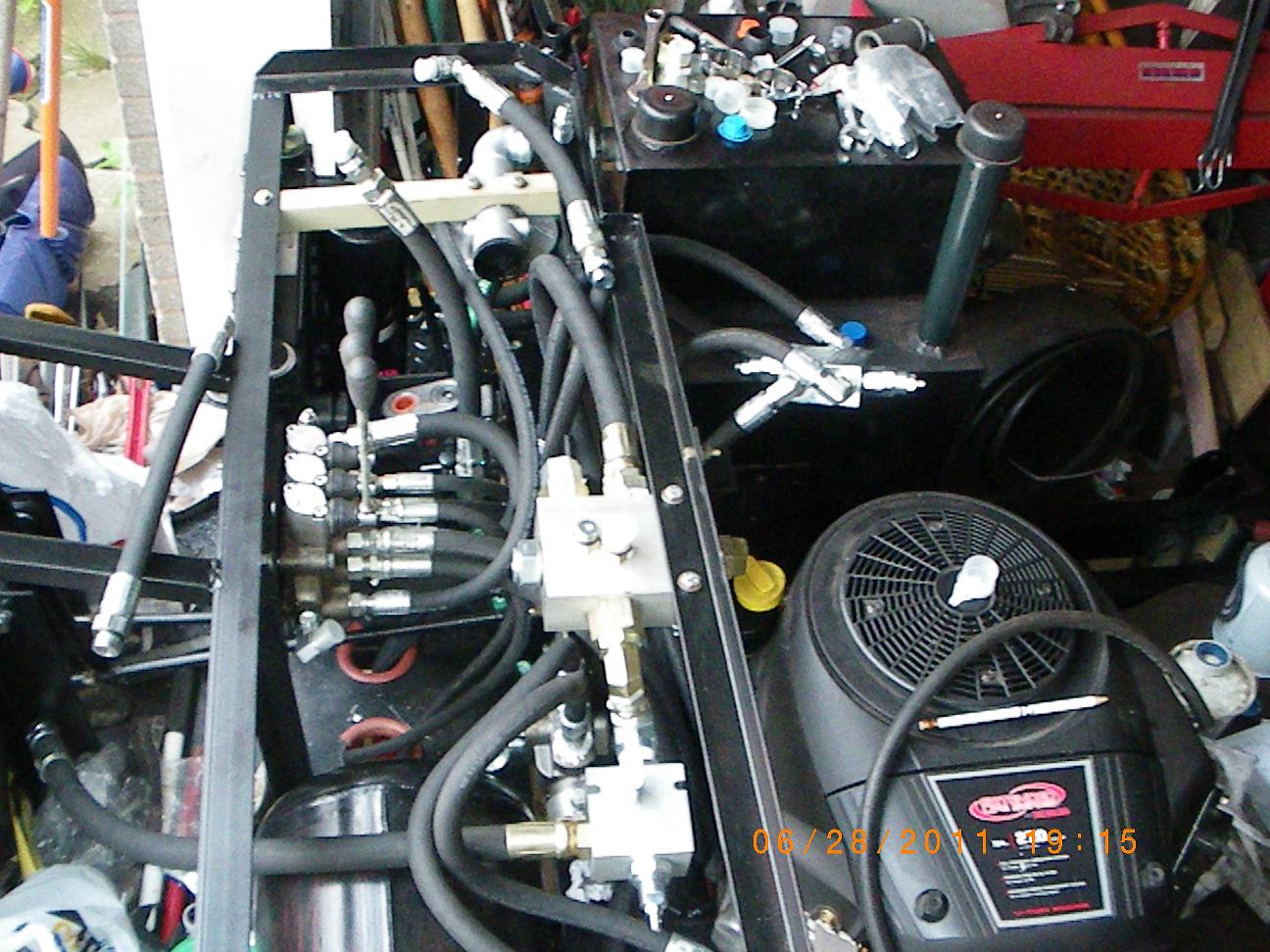

I built one with hydraulic motors. Not direct drive though, I had to go to 3:1 gear ratio via chain drive to get enough torque to drive the tracks. I wish I had gone mechanical because I put several thousand dollars into hydraulics in the end and because disillusioned with the project. Still waiting for one track to get finished. So much to think about with hydraulics, motors, pumps, cross over relief valves, hydraulic filters, oil coolers, tanks, strainers. Flow dividers unless you are running dual pumps. Need other valves to tap off to run blades, main pressure relief valves. I put in a pressure gauge as well. Probably 30 hoses. If the wife only knew.
