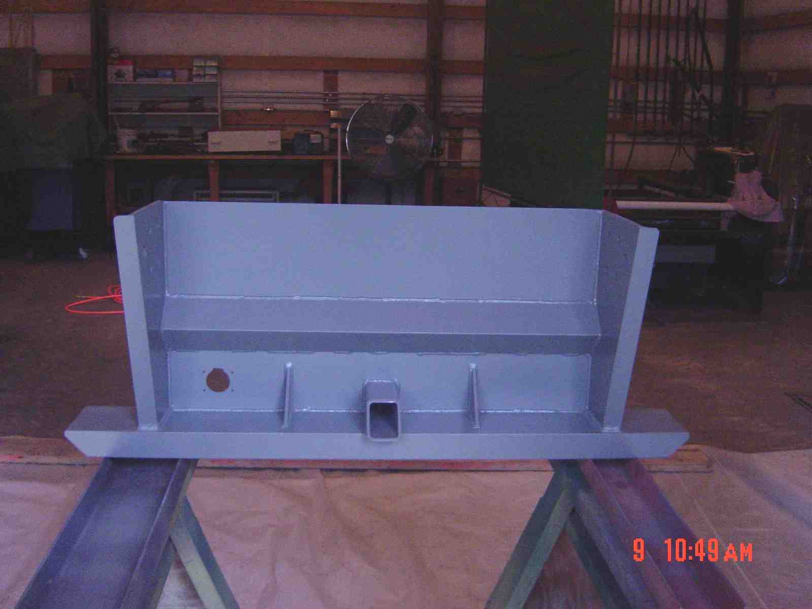

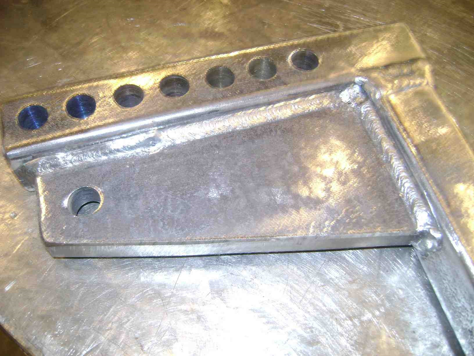

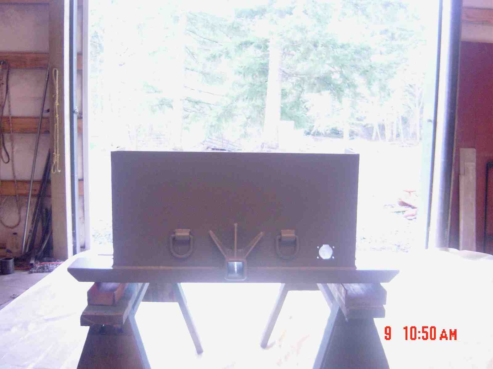

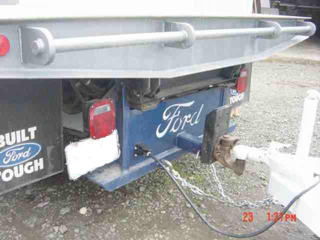

No sir now that I got 220 to my garage I'm only going to practice with the 110 Make that weld with 220.
Good man!
Hitches are well above my pay grade.;)
