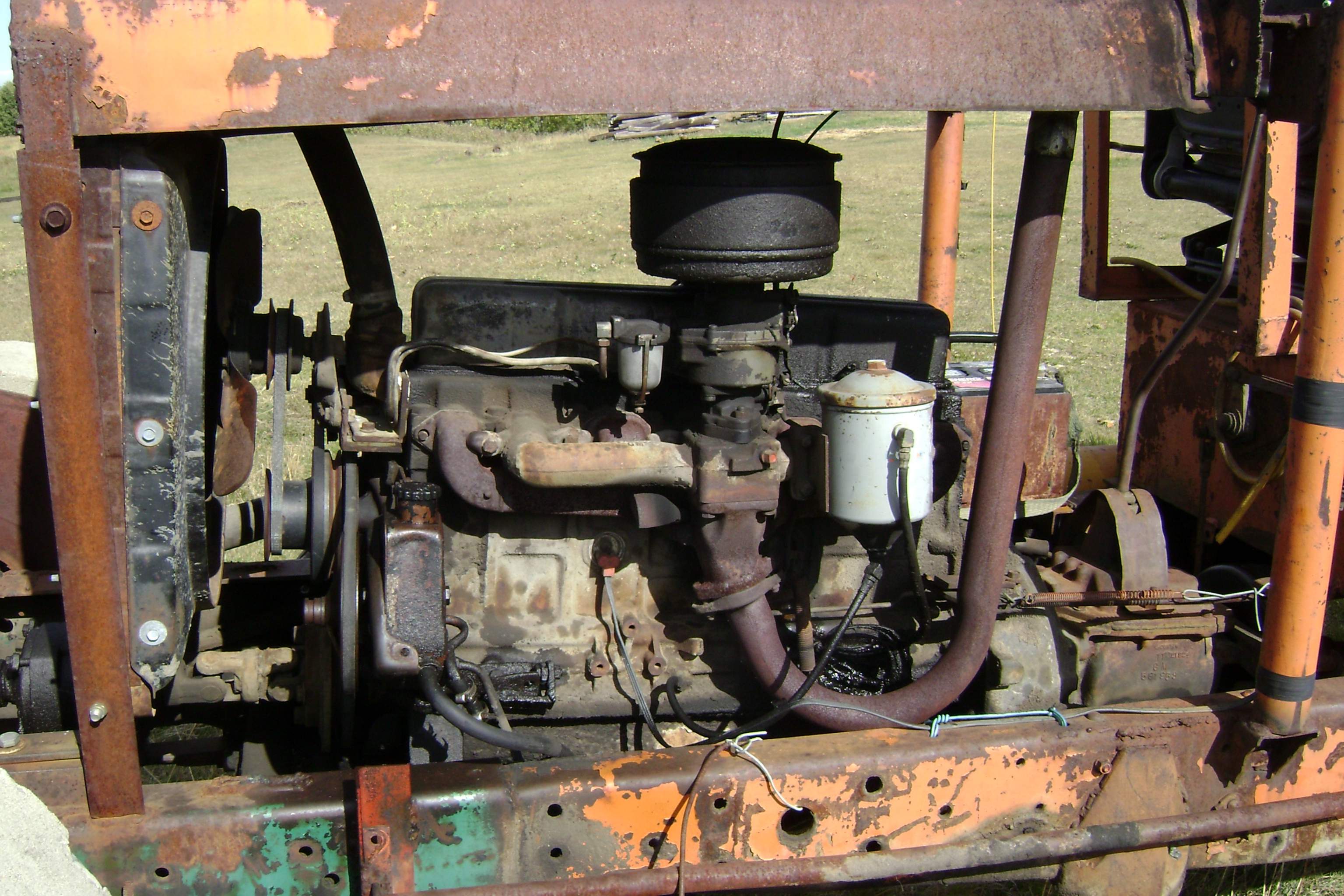

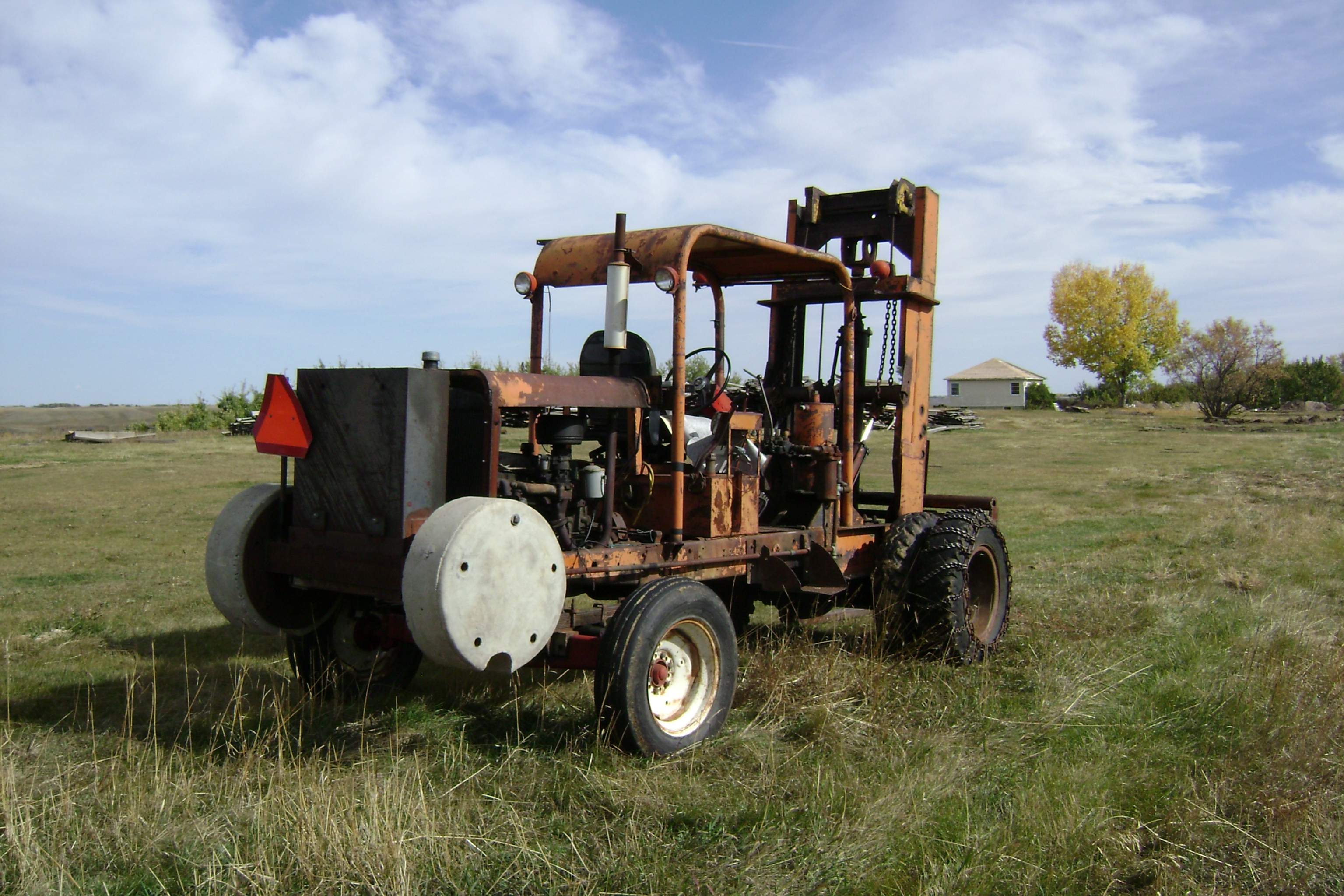

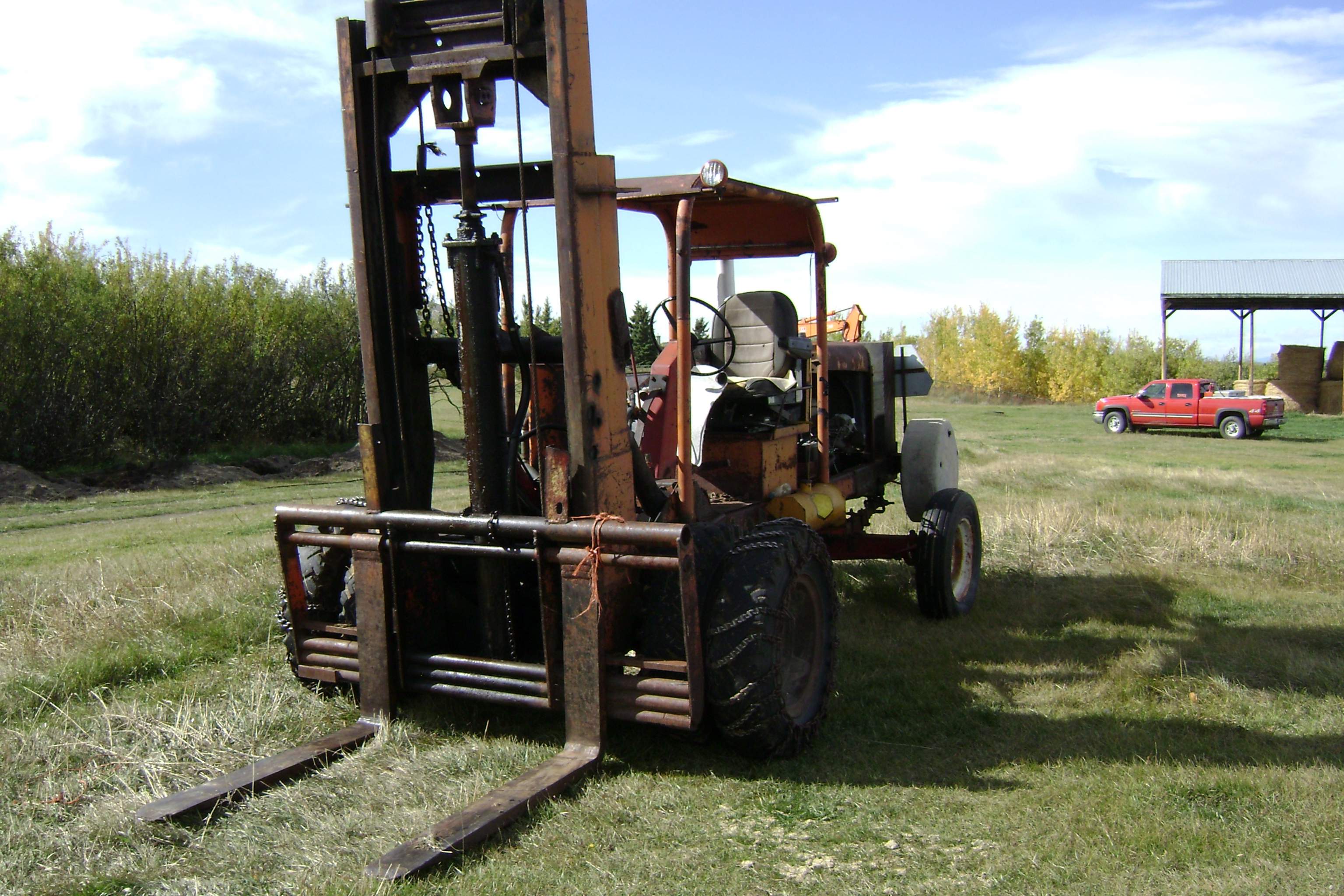

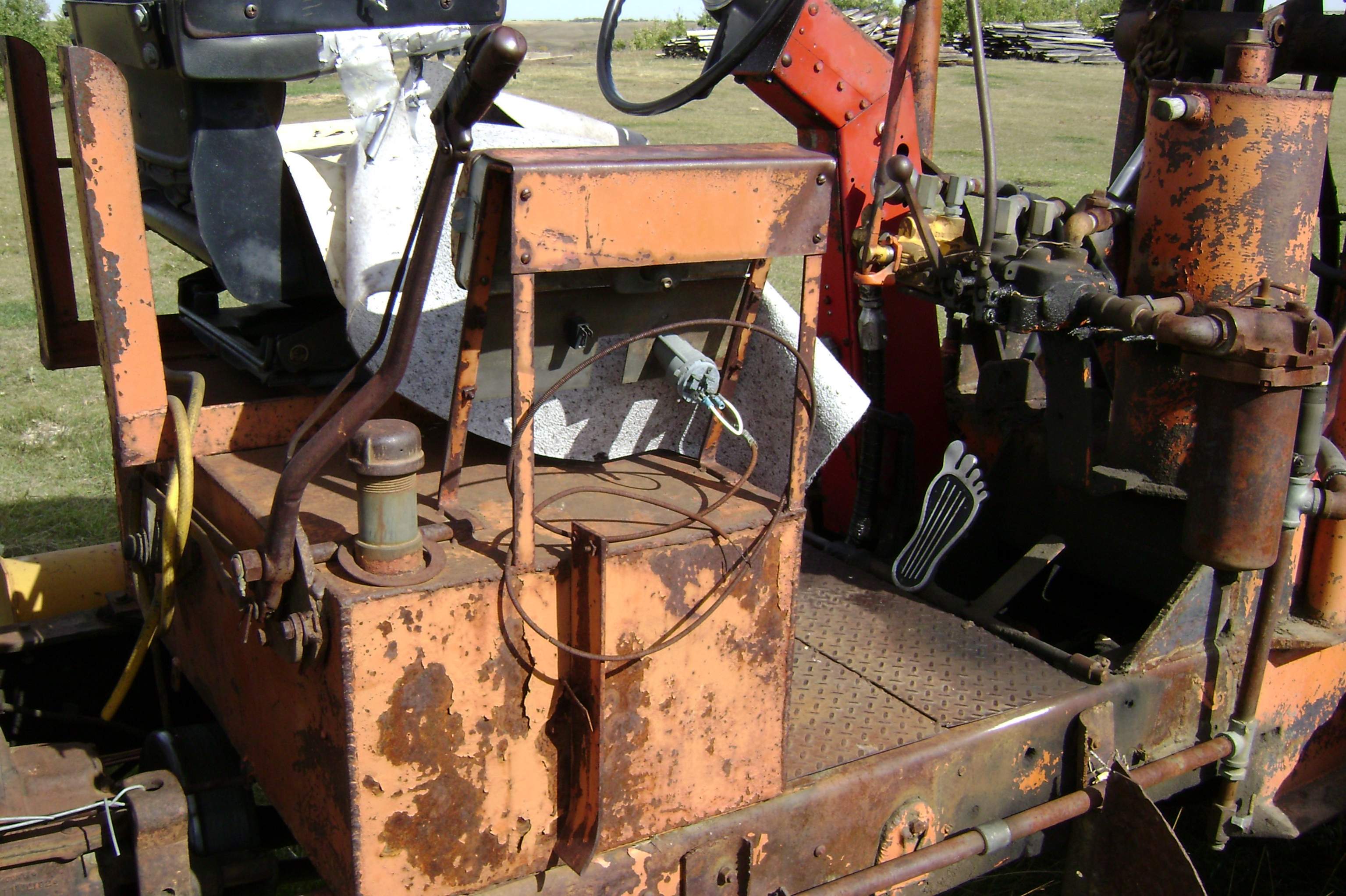

Probably not much help but heres my buddys homemade lift.
Its a beast and has lasted at least 20 years. But look out :eek:no brakes:eek:
