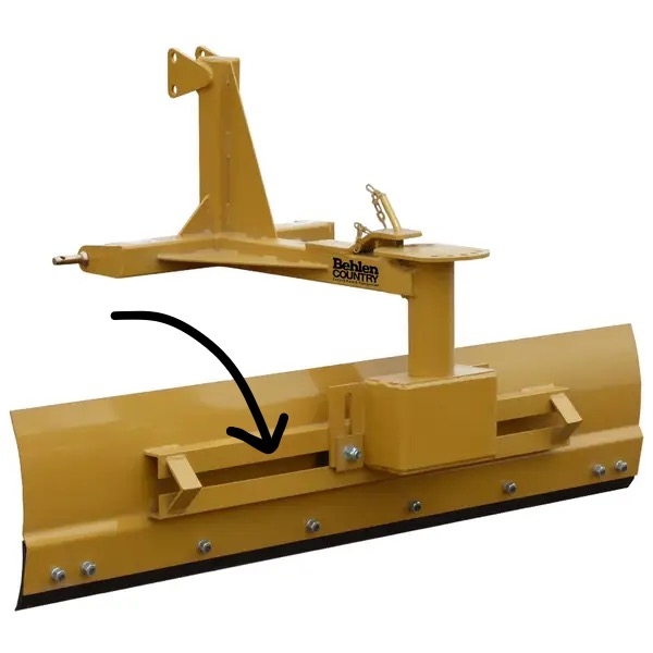

We acquired a B8200 and proceeded to impoverish ourselves trying to take care of all the deferred maintenance. All in we have almost $6000 in a litany of fixes, all new hydraulic hoses, new water pump, rebuilt loader cylinders, refurbished gas tank, new water pump, custom fabricated rear wheels and brand new tires…and last week the hydraulics quit…had it hauled into the local dealer and $806 later they said there was water in the hydraulic fluid….brought it home started it up, lifted the loader and hydraulics proceeded to quit working again. Now, we are almost $7k into a tractor and I’m voting it’s time to move on. She’s been a good girl, but She’s a very expensive date.
So, we know we need at least a marginally larger tractor as the B8200 is about 18HP and it has always been really expensive to try and find attachments suitable for that small a tractor. Our needs are fairly simple. We need to loader for cleaning my sheep barn and for moving snow, and we need to be able to disk up our pasture to rehabilitate it. We have lots of rodent damage but the lay of the land is Flat and our acreage is smaller. We would anticipate renovating 1 Acre at a time and we will not be plowing because the topsoil is shallow and we don’t want to kick up any more rocks that we have to. We would like to be able to run a rear offset grade blade not simple back blade but one with adjustable offset illustration attached but we can’t find one that is suited for a smaller tractor. A snowblower would be heaven but unlikely.
With that in mind, will a 25 HP work or will we be much happier with a 30Hp? We are only looking at geared tractors at this point. I have a personal thing against anything that wreaks of having a CVT or hydrostatic drive…Thanks for any and all feedback.

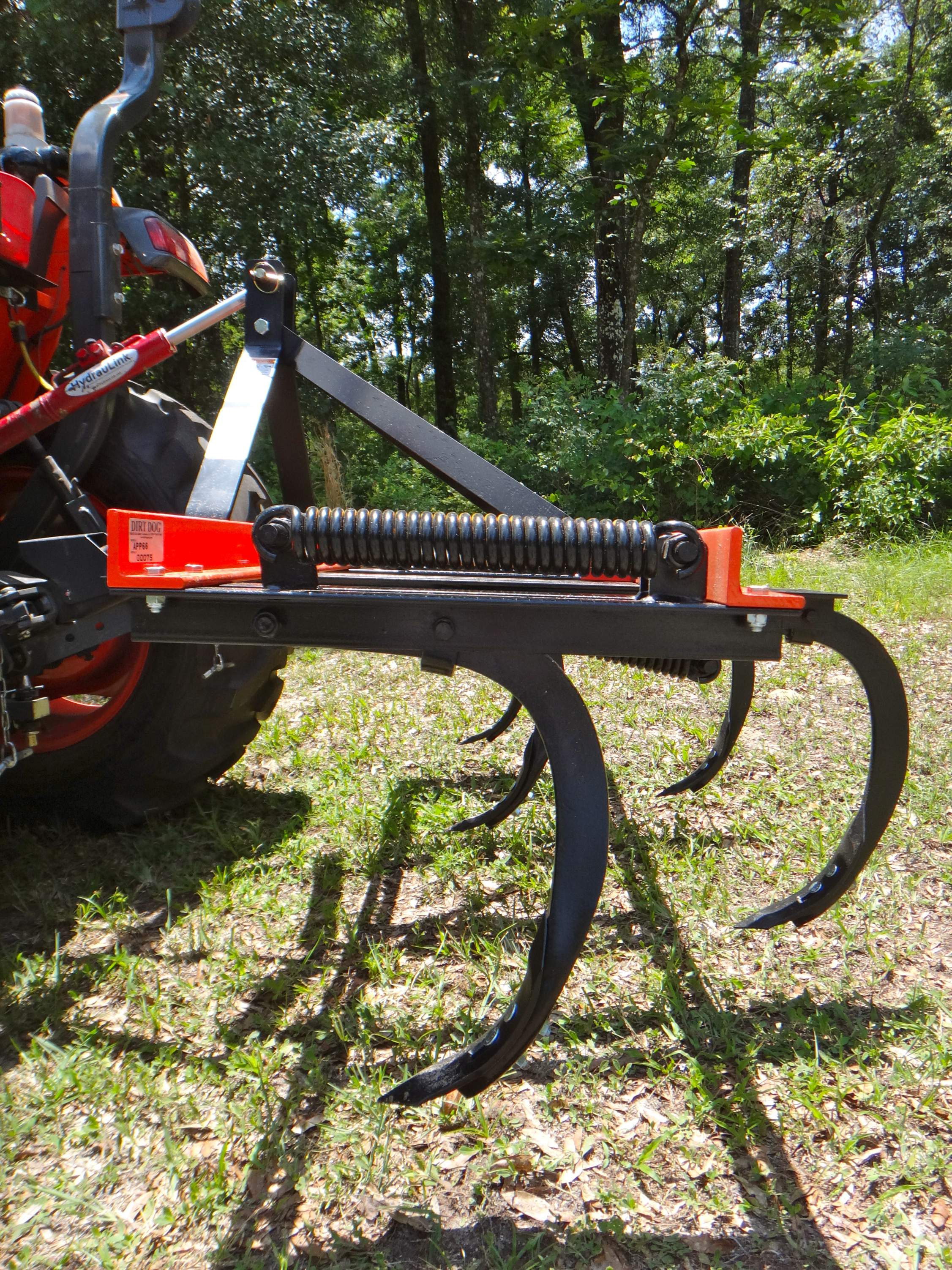

Your Kubota B8200 has a bare weight of around 1,500 pounds.
In my experience owning three compact tractors it takes a 50% increase in bare tractor weight before you can feel a significant increase in tractor capability. If you agree with this proposition your options are in the Kubota L2502/L3302/L3902 range, which weigh 2,700+ pounds. Tractors of 2,700 pounds bare weight are suitable for use on 1 to 10 flat acres.
I recommend a three shank All Purpose Plow for your pasture renovation. Dirt Dog and Bush Hog both offer three shank APPs. You will need a 2,700 pound bare weight tractor to pull a three shank APP.
There are very few 30-horsepower tractors available. After 25-horsepower engines jump to 33-35-horsepower.
