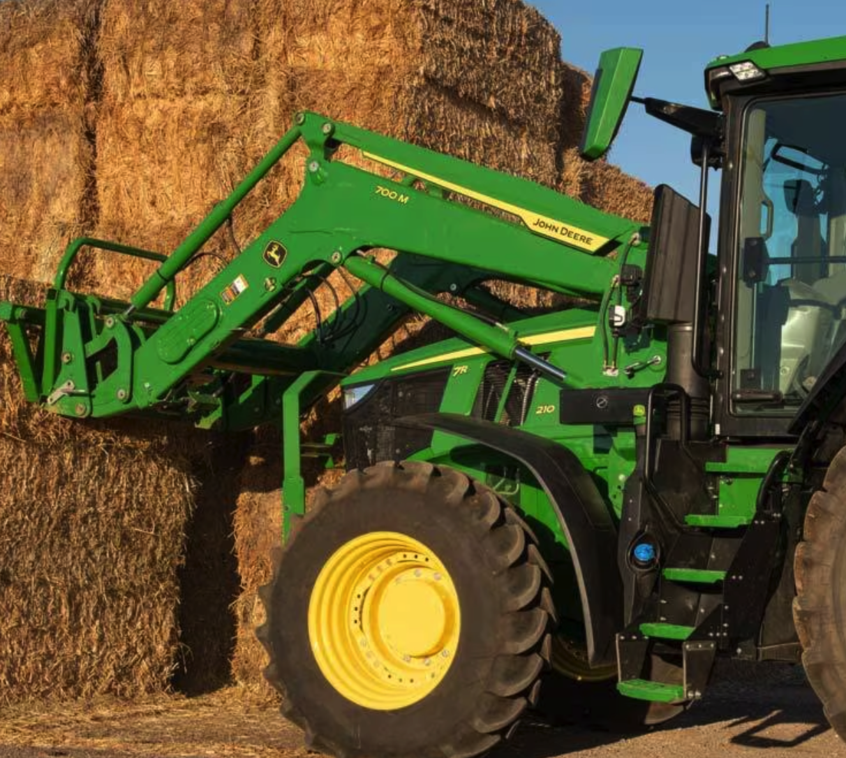

The cylinder must extend to lift. It extends by pressurizing the non-rod end. It doesn't matter if the non-rod end is up or down.
And there are loaders with the lift cylinder rod end toward the bucket and loaders with it toward the cab.
You don't often see bucket cylinders with the rod end toward the cab, as that would expose hoses and seals to more damage.
Bruce
Look at these pictures BCP posted.
It doesnt matter which way the cylinder is pointing
They are BOTH extending to raise the loader
