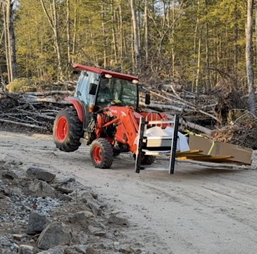

I will get around to checking pressures at some point. Need to plumb a Guage with some fittings.
I generally use my forks, as they are lighter than the grapple and bucket. Might consider building a plate to use chains and clevis hooks on.
Neither is a priority right now, as I am using grapple to clean up tree debris right now.

I used the internet to get the weight of the Toro Workman that we were loading.

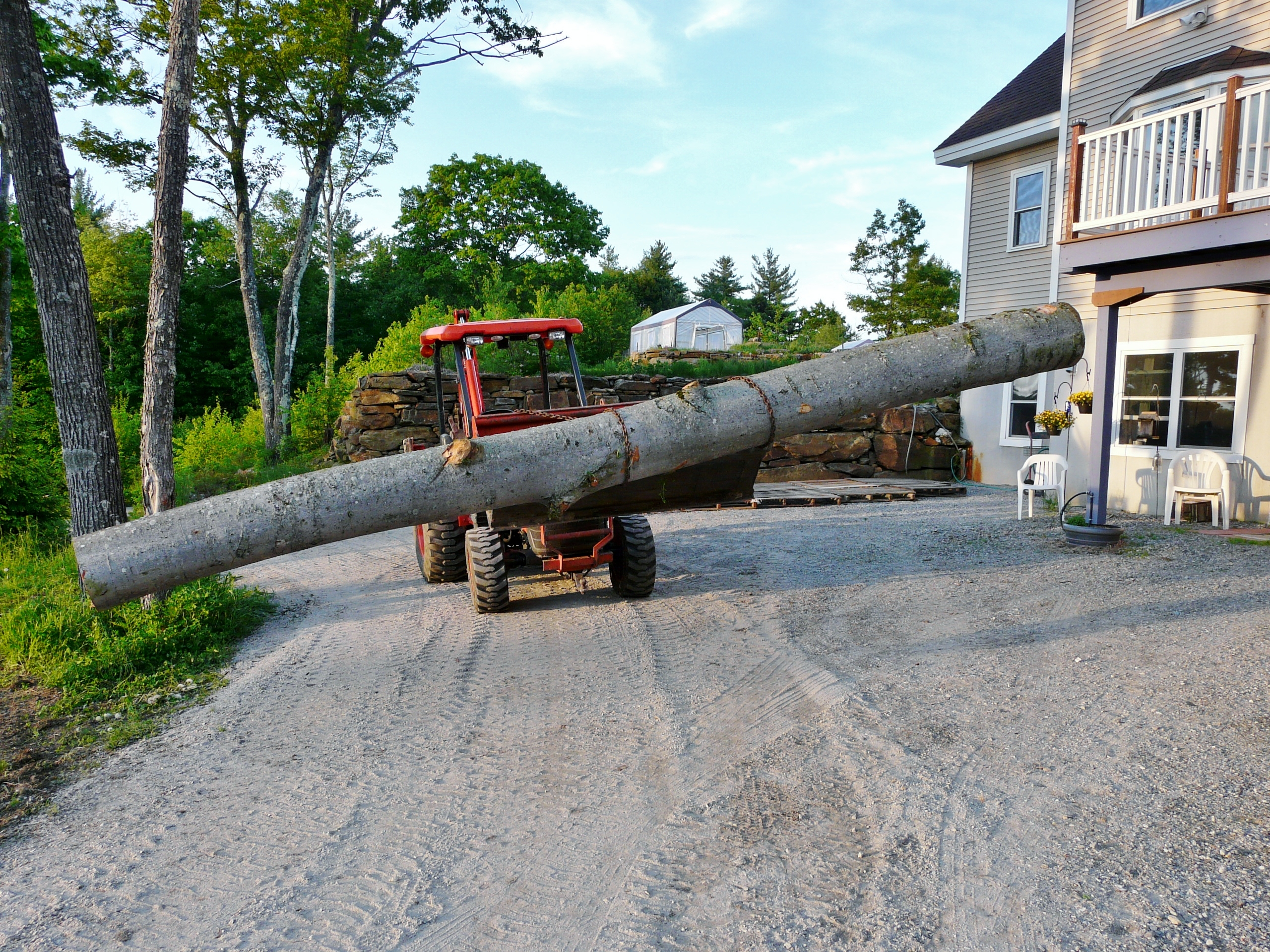

One of the several reasons for me "considering" an upgrade the size of my cylinders (or better yet check the pressure setting) is because my tractor never does what is shown in the picture. I almost never use the FEL without having some sort of implement on the rear, usually a semi-mount Bush Hog 3008, or my homemade LPGS that is pretty heavy just by itself. My rear tires are also filled 16.9x30 which make it even harder to get light in the rear end!
Wear and tear on the front axle is my biggest hesitation, still pondering this.

I have ballasted my tractor to over 8,000 lbs in order to lift about 2600-2700 Lbs at center bucket. I estimate that lift is over 3,000 lbs at pins, must be a world record for an L series tractor. That weight is hard on front axle, as I broke the casting once.
