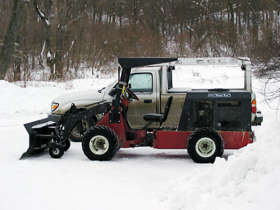

<font color=blue>when you increase the volume of the trans - you produce more torque - Right</font color=blue>
I think that volume relates to speed (and horsepower) while pressure relates to torque.

/ What is wrong with this idea #67
Ed,
You are right about more torque with a two speed motor. The lower setting provides more torque and less speed per volume of oil, while the upper setting is more speed less torque. It's the volume of oil per motor revolution. A larger volume, the greater the surface area the hydraulic pressure acts upon, the more torque developed. Think of it as two different diameter hydraulic cylinders with the same stroke length. A smaller dia. cyl. will stroke much faster per volume of oil, but produce less force. A larger cyl. will stroke slower per volume of oil, but produce greater force.
Ed, ask PT to give you the max. output torque (in-lbs) per lb vehicle weight for the 425, 1430 and the 1845. They should be able to do this pretty easily, and they would not have to worry about giving out business sensitive component information. My concern for you is that although the larger units put out more wheel torque, it will not help your hill climbing ability due to the increased vehicle weights. It's like lifting weights, a 150 lb person does not have to lift as much as a 200 person to actually be stronger on a body lb per lb basis.
Good luck, wish I could help more
Duane

/ What is wrong with this idea #70
<font color=blue>You are right about more torque with a two speed motor. The lower setting provides more torque and less speed per volume of oil, while the upper setting is more speed less torque.</font color=blue>
It is correct that the low speed on a two speed hydralic motor will produce more torque than the high speed--assuming the same pump.
However, this does not necessarily mean that a two speed moter will have more torque than a single speed motor. This will only be true if the two speed motor is selected to give this result. Alternatively, the two speed motor could be selected to give a higher top speed in the high setting than the single speed motor.
