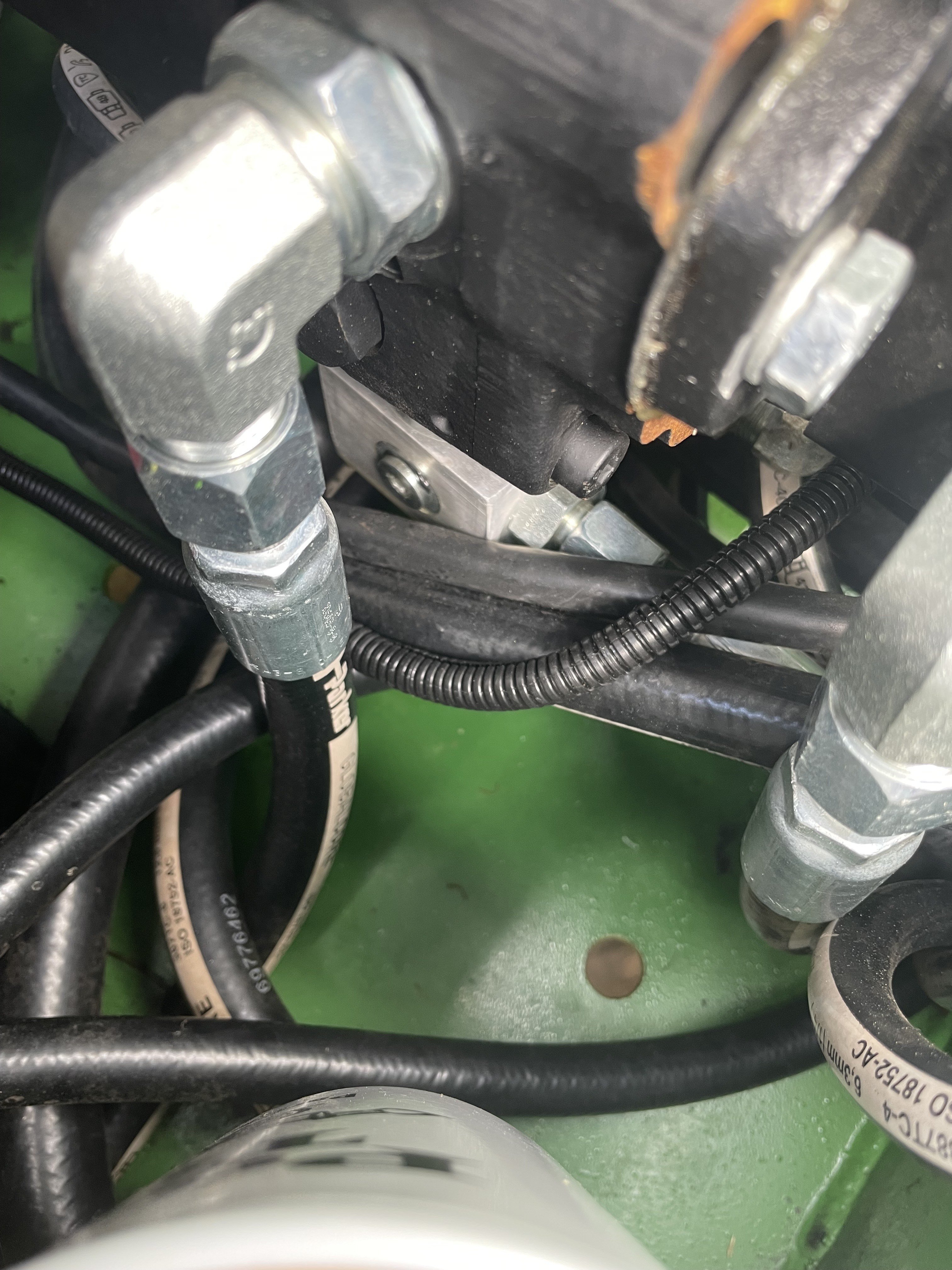

All tractors, and all machines of any kind, will eventually break something. This is my personal experience. As my pt422 is my first experience with power-trac, some problems I've recently had were hydraulic leaks from 2 loose ports underneath the variable volume pump. Both just needed to be tightened with an Allen wrench, with some Permatex Green applied after tightening. But the secondary problem was the amount of fluid that leaked everywhere. Can't be good environmentally. I now park the machine on pieces of cardboard that will soak up any leaked oil, or put pieces of cardboard next to the rear wheels where remaining oil from the body flows out.
Other than that, I love that the machine has a low center of gravity, making it somewhat safer on hills. I do use the seatbelt, and you do need to take extra care always when you're sitting on any powerful machine.
