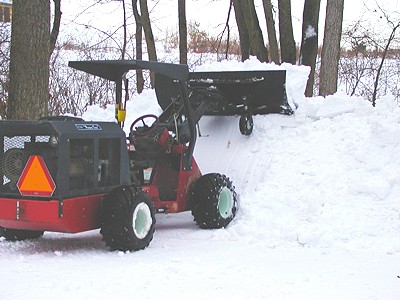

Wow I'm really surprised that even the 1845 rear end would come up - that machine is 3200 lbs - but i guess when you articulate - you really change the center of gravity as well as shorten the machine - you lose your leverage of having the
engine straight back opposite the load in the bucket
how does it do with the 18cu bucket - because that is the one I want - I am not opposed to adding weight - funny how the PT boys advise against adding weight - I was looking at their video the other day and - there was one of their machines with weights on the back moving soil around
as for the attachments - I will mostly go for new ones but a few I will keep and use on the new machine - instead of changing out the plates - I was going to use a simple plate adaptor for the ones I am keeping and do not use very often
- this way they can still be used on the small machine - wonder why they didn't make the plates universal - oh well
thanks very much for the input on the seat - I really thought that it would make it much more confortable for all the mowing - I sort of find myself hanging off my 425 opposite the slope while I am mowing - again was going to adapt to fit the 1430

edambrose: <font color=green> Wow I'm really surprised that even the 1845 rear end would come up - that machine is 3200 lbs - but i guess when you articulate - you really change the center of gravity as well as shorten the machine - you lose your leverage of having the
engine straight back opposite the load in the bucket</font color=green>
Sure surprised me! The articulated deal I've done several times now but the straight on lift with the hoe sure took me by surprise.
<font color=green>how does it do with the 18cu bucket - because that is the one I want</font color=green>
I don't know, I don't have one. A heaping full 9 cu ft bucket of wet dirt is about all I'd want to carry and has to weigh at least the rated 1200 lbs.
<font color=green>- I am not opposed to adding weight - funny how the PT boys advise against adding weight - I was looking at their video the other day and - there was one of their machines with weights on the back moving soil around</font color=green>
Very interesting - they are quite set on not adding weight, at least not to the wheel assemblies, and someone made reference (Hans?) to the fact that adding counterweight to the back would increase the loads on the very expensive articulaion assembly.
I'm beginning to think our attempts to stretch the limits of these (and any) machines is a bit risky. As in "don't force it - get a bigger hammer" (er, tractor). Yeah I know, Hans, its the 48inch gates, stupid.
Or then we could just take on those jobs that need a bigger machine by taking smaller bites.
