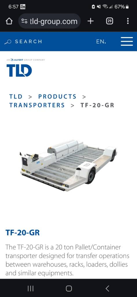

We sold an old catering truck to a roofing company once. They loved it to get bundles and supplies up on the roof.
Their are a few auction sites for GSE equipment
   / What is the oddest machine you have worked on or operated
#87
What you laughing at? :unsure:
I did something similar using my steiner for moving my camper around. Sitting on the prim-mover makes it easier to steer into very tight slpaces.
