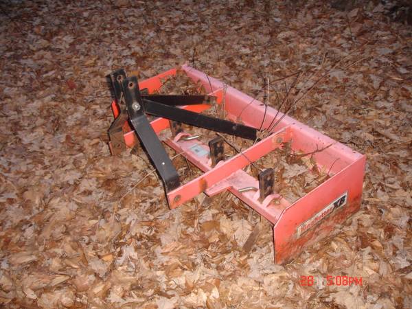

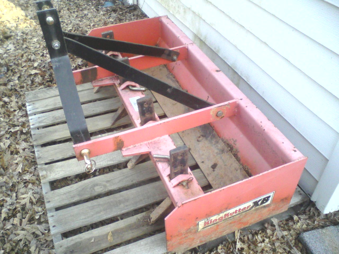

Thanks Pappy. I've been thinking the same thing - it's good to know I'm not alone. I've been checking CL many times daily and think I may have found a decent one. It's a King Kutter XB 48X0-0, orange even. Was listed for $350 and he said he'd take $300 with no prompting when I called him so maybe when I go see it he'll go even lower. From the pic it looks in good shape, nothing seems to be bent, broken or missing but it doesn't have the connection pins. He said he bought it new in '04 and only used it a few times backfilling while building his home on his BX 23. Been stored outside so has a little rust. Raining cats, dogs and horses here today so I plan on going to check it out tomorrow or Tues. Only about 30min from me. Anything special I should look for???
/ What box blade to consider?? #4
Destroyed paint is of minimal concern, nature of how they get used. That leads to light rust that polishes off in the dirt. Make sure nothing is bent or cracked. The wear edges on the back might be worn, but they are usually designed to be replaceable. They are pretty simple chunks of steel.
/ What box blade to consider?? #5
Yep, what Fallon said. Also, check the rippers and their mounting slots to make sure one or more of them isn't bent, cracked or otherwise boogered up, which could be an indication that it got hung up on a rock or root and is sprung. Same thing on the 3 point hitch mounting points.
Northern Tool sells that 4' King Kutter box blade for $549. Tractor Supply sells their 4 footer for $549 also. So $300 is a fair price if it's in good shape. $275 would be exactly 1/2 of retail.

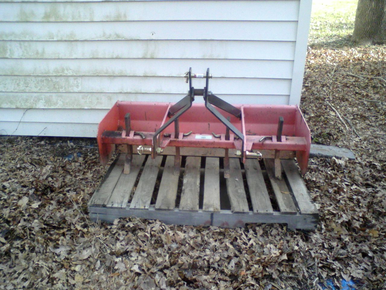

Just bought the box blade! Is in great shape - like new - just weathered from being stored outside. Got it for $280. All I need is the hitch pins top and bottom. The top hitch end is 3/4" id and bottom hitch ends are 7/8" id. Which hitch pins do I get?

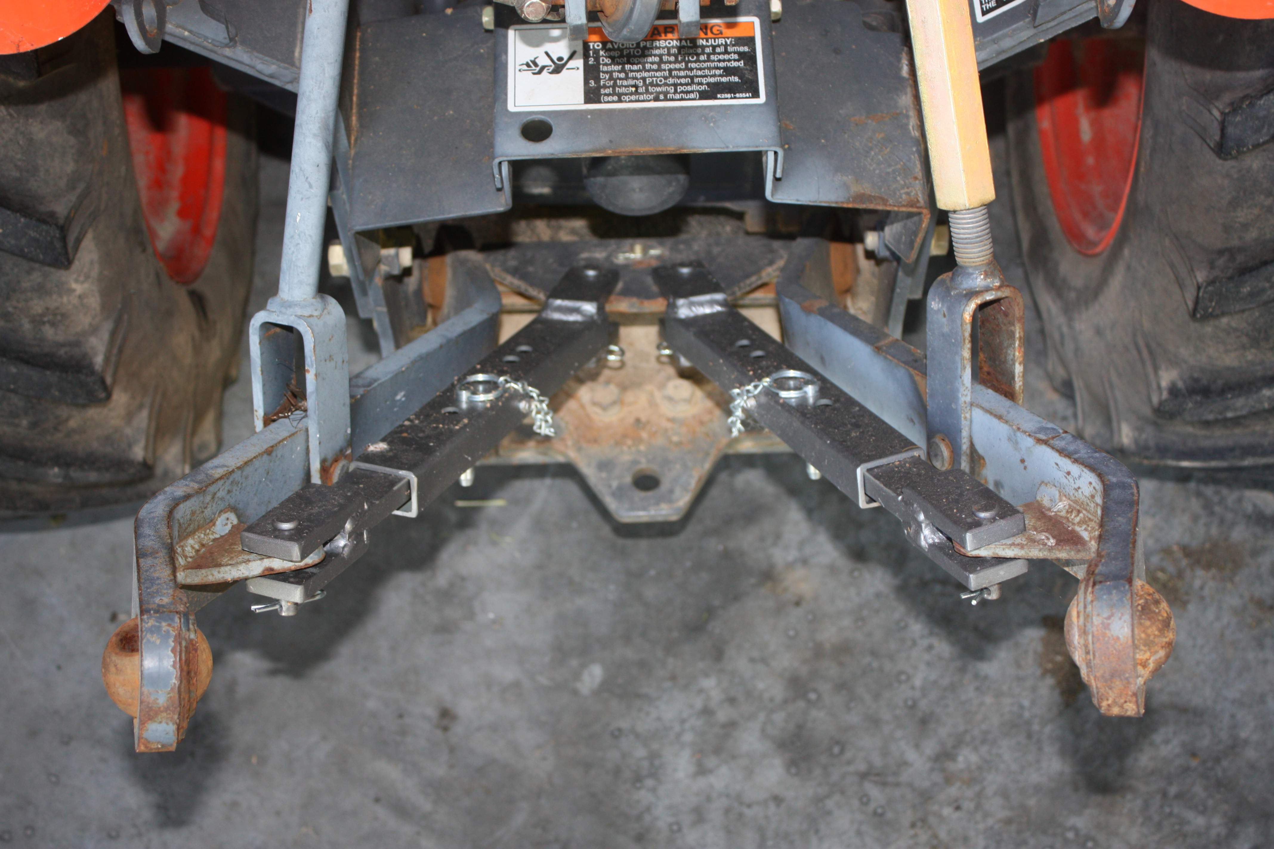

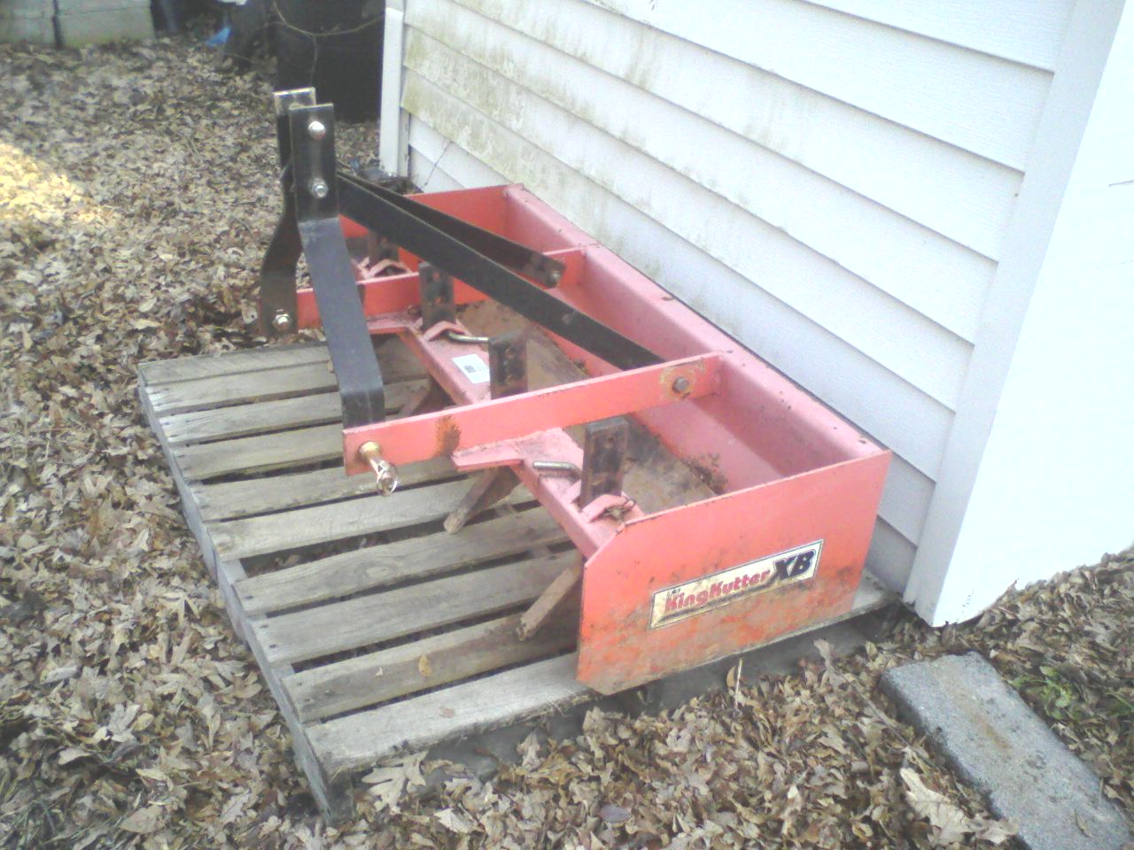

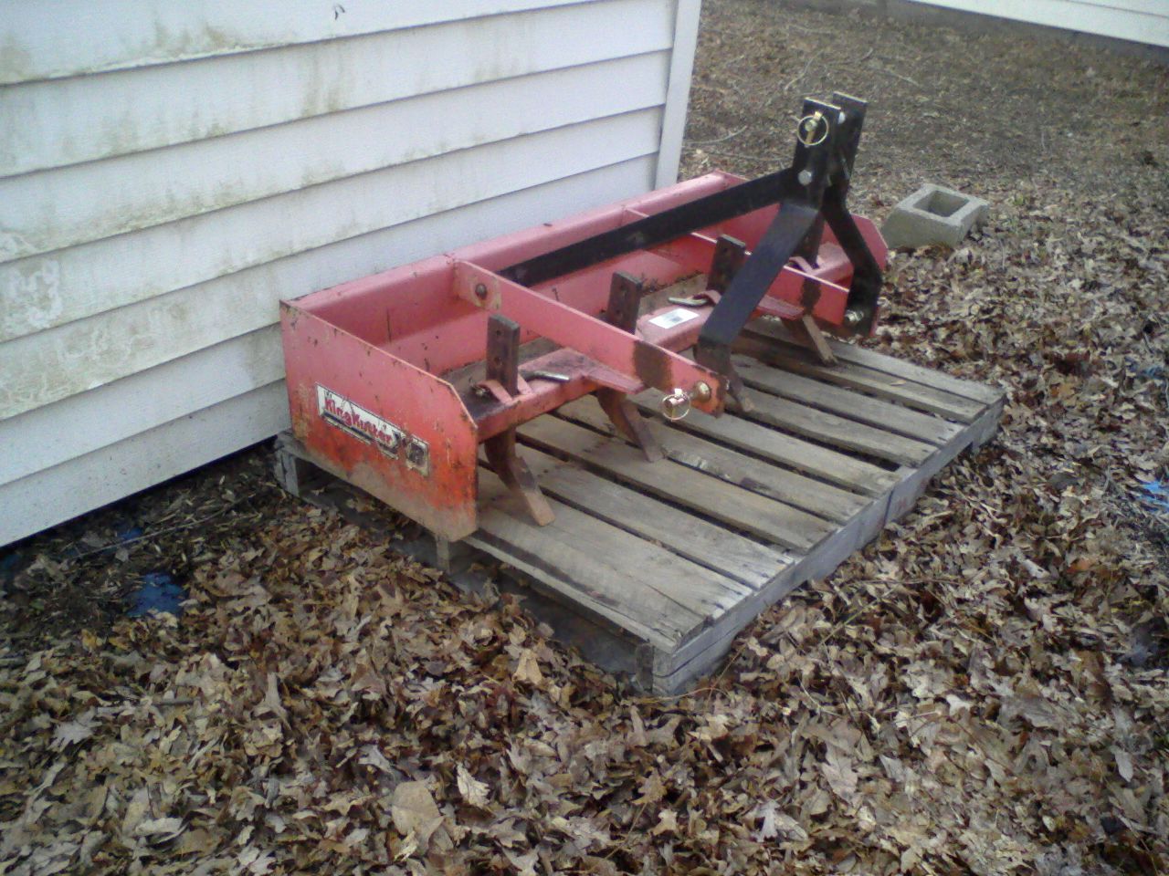

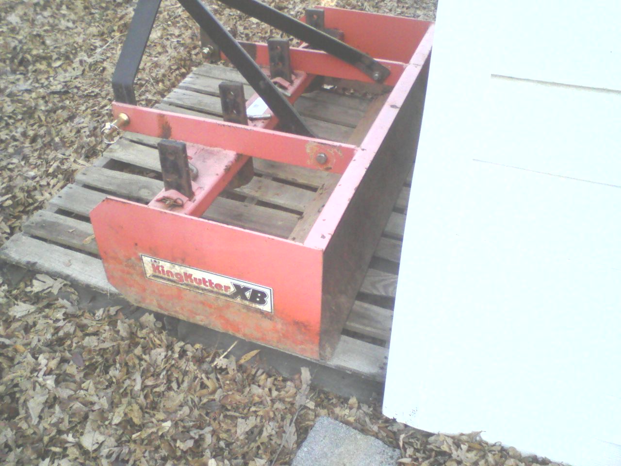

Got all my pins and hardware yesterday @ TSC. Tried on the box today, still way too muddy to try it, fit fine but was very sloppy side-to-side. Guess I have to adjust my stabilizer turnbuckles to alleviate the slop. Here's a few pics..
/ What box blade to consider?? #19
The turnbuckles & side supports should be tight when using anything but plows (lets them wander around rocks & obstacles a bit & avoid hanging things up). That and loosen them up for when you are hitching things up obviously, unless you have a quick hitch (which I'm pretty sure you don't have yet).
I found these far superior to the OEM turnbuckles, from Stabilworks: StabilWorks
