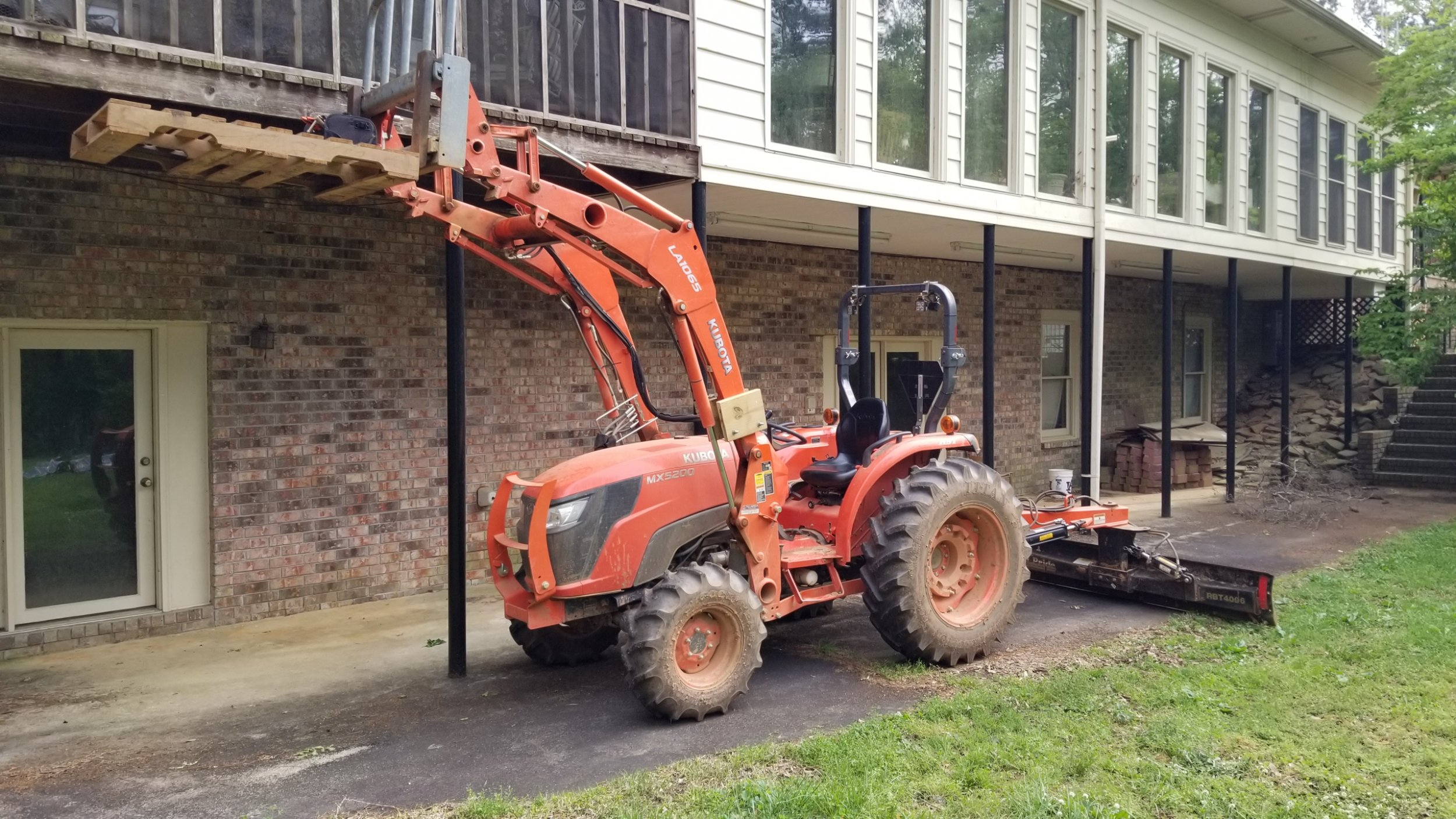

I've constructed pathways with a bunch of hauled-in material. Had to move a LOT of material. My box blade worked well for moving that material. And what I've found is that pushing is the ONLY real way to get something smooth, especially if you start out with a rough/un-even surface (such as I was doing).
NOTE: Don't need a crown. Not the finish, but close.

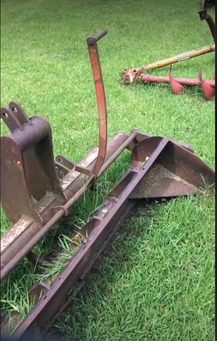

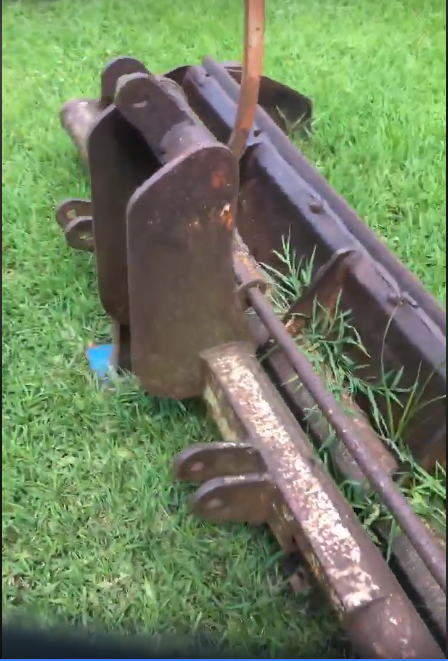

Well, I want to thank everyone for all the comments. I'm learning a lot reading them. In the last week, I've been searching for a box blade, because I do have other needs for it besides the potential use on the driveway. So, today I've had a very good (I think) development; I found a 72" rollover box blade an hour and a half away from me for $575. I'm taking the plunge and picking it up tomorrow and I'm guessing it's either a Gannon or Gill, but the current owner doesn't know. I've attached a couple of photos. It is definitely category 1. After everything that has been said in this thread, I think I'm going to end up getting a back blade and a land plane, and then I should have all my needs covered. Getting the box blade at a good price makes that possible.

Sorry I could tell from the pic's, is the handle to raise/lower scarifiers? Make sure the blade is pure straight like a metal ruler straight, it is amazing how a kink or twist will make'm almost useless. Enjoy, new toys are fun:)
Thank you. The handle is to release the whole guts of the unit so it rolls over to engage the different parts of the attachment. The scarifiers are used separately from the box blade itself. I'll get instructed tomorrow, but I believe you raise the attachment.....pull the lever to release the rotating parts.....put the attachment on the ground, and then roll the tractor forward. When you move the tractor forward, the rotating part rolls over and the next part of the attachment becomes engaged and locks into place. So, you roll it over until the scarifiers are active...... pull the unit around to churn up the ground/gravel....then lift the unit, pull the lever, and repeat and now the box blade portion of the attachment rolls into engagement and you pull it around to do your grading. You can repeat one more time and engage the blade for pushing backward as a dozer. I'm pretty sure that's how it works.....3 different functions.

It looks identical to the 66" Gannon FD-100 I had, hard to tell from the pictures but appears the rear facing cutting edge might be broken, shouldn't be a big deal to replace but just make sure the mounting area is straight or else you won't get the new adge on.
They work well, I liked mine but it was a little heavy for my tractor at the time and lack of position control made it difficult to grade, ended up selling it and keeping my 60in box blade so I could use the rear cutting edge as a gauge.
