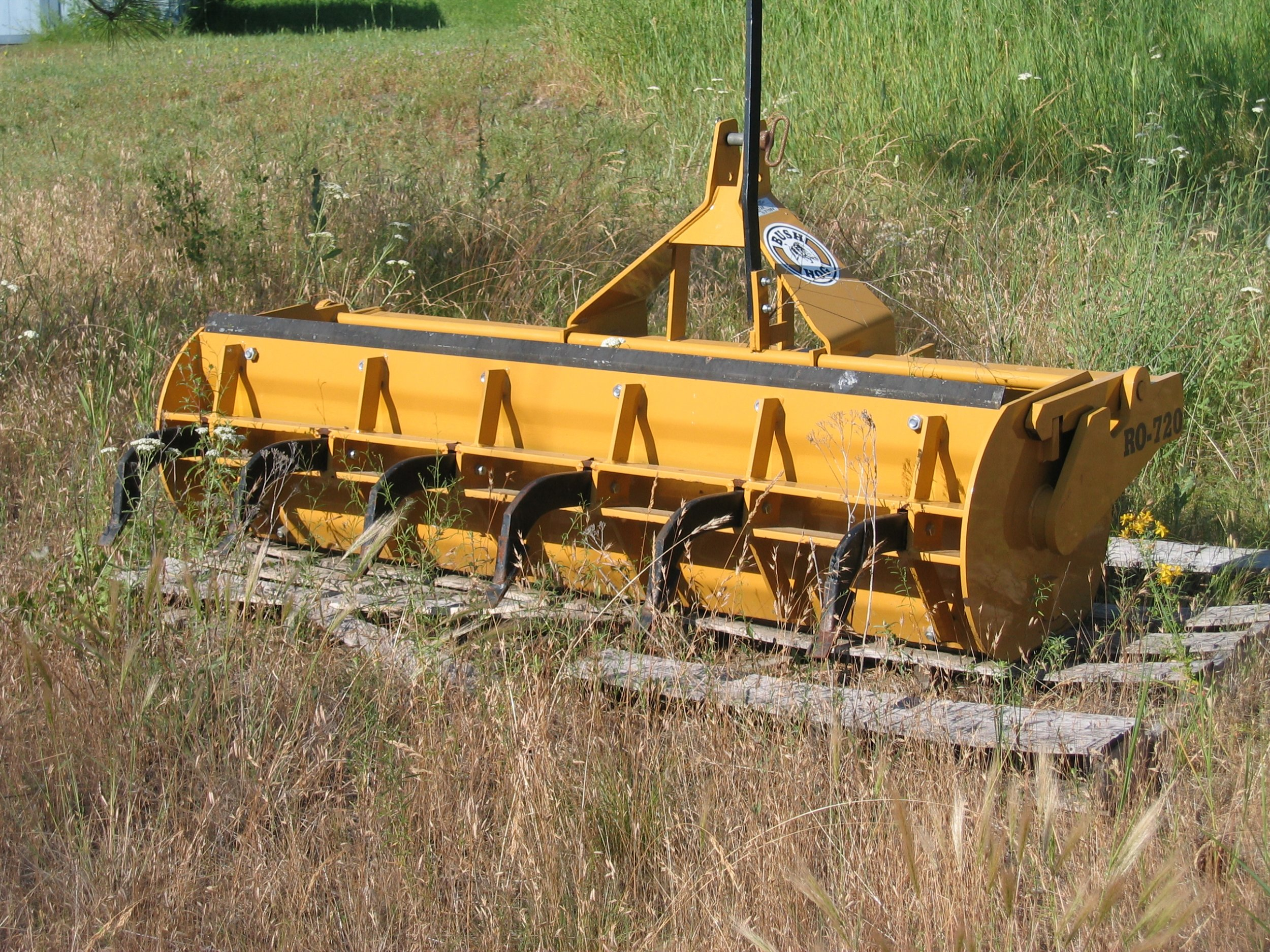

I have a Bush Hog roll over box blade( ROBB ). 72" wide - 730#. Outside to outside on my tractor rear tires - 80". I find it to be NO disadvantage to have the ROBB narrower than the rear tires. It still does everything it's supposed to - just fine. There is a definite advantage to having scarifiers on the box blade. Loosen the top soil - easier to scoop up with the box blade.
I've seen references to these....how do they work? What is the advantage over a regular (fixed?) blade? I gather they're pricey so may not be in my budget anyway.

ROBBs have three latch positions.
1) to pull soil
2) scarifiers only (this differs from a standard BB which can rip and pull soil at the same time)
3) smooth soil (and) push/bulldoze soil if TPH has strong, rigid stabilizers.
ROBB advantage is weight and less need for adjustment if towing tractor does not have hydraulic Top Link and hydraulic Lifting Rod adjustments.
You have to pay for the weight, usually ~~120 pounds per foot of width.
