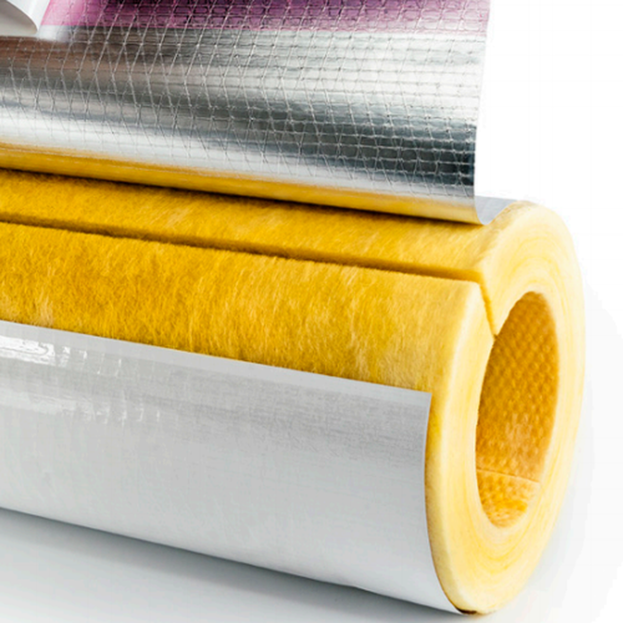

Would Pipe insulation be enough if it was used by itself? I am guessing not. I don't want to leave it run all winter as It'll just add to my ground water here and waste my well.

The upside to insulation is that it is passive. A power outage or a rodent isn't going to cause it to fail. How much insulation you need is a function of how exposed it is, how the wind blows through your porch, and of course, how cold it gets. Tough to forecast.
I would suggest bringing the pipe down the foundation wall, and under grounding it by at least a few inches, so you can put four inch thick foam boards 12" across on top of it, and against the wall. That will help actively add waste heat from the house in the pipe and geothermal heat from the ground, which will be better than wrapping the pipe with insulation which does not have a lot of R value. If that is too much work, you could even just put the pipe on the ground, add the foam boards on top, and put cement tiles on top to hold it in place.
I don't recommend fiberglass pipe insulation for cold water; it tends to accumulate water and then it has very little insulation value. It is generally recommended only for hot water and steam. Closed cell foam is more reliable.
