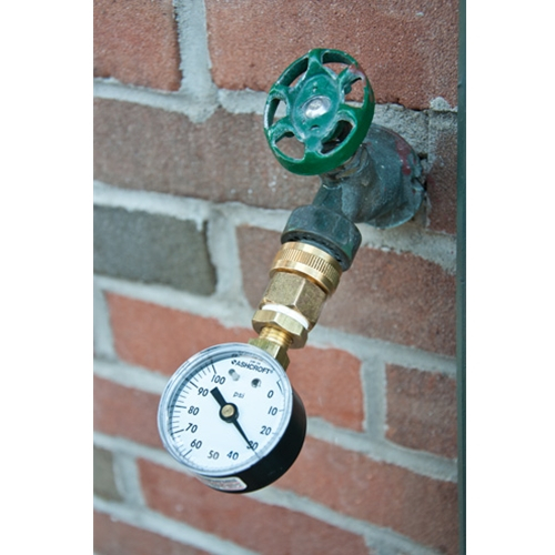

Thanks for all the advice, I decided to call local plumber, but now with advice here at TBN I am less likely to be led astray by any mischievous tradesman. At minimum I will have focus on him replace small piping with brass to new gauge and pressure switch and I have a new spare pressure switch already. Hopefully they return my voicemail this week with an appointment. I am going to see if I can find a pressure gauge tool that screws on to hosebib to give me a accurate read to calm my nerves in future. Meanwhile everytime I walk by pressure gauge in mechanical room and see it at 75 or 80 psi , I turn laundry tap on to relieve some pressure. ( but I swear it doesn't seem like 80 psi in faucets)

You can make one easily enough. Just use a hose bib to NPT adapter and a bushing with the gauge screwed into it.
