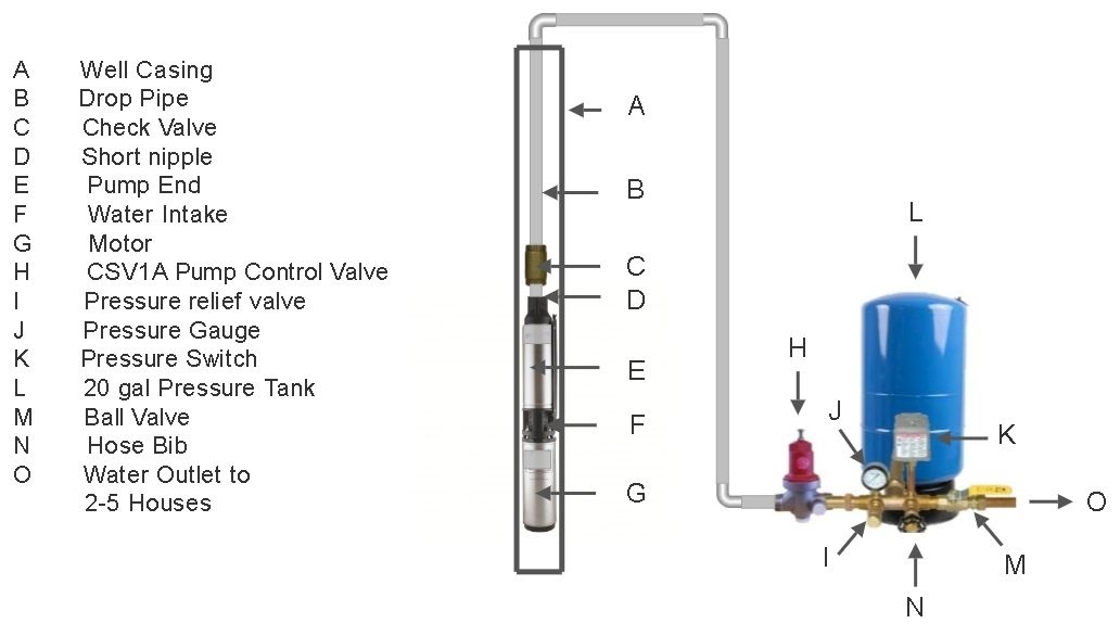

Any faucet in the system will drain the tank. Just want the pressure gauge on the tank to read zero when checking the air at the top of the tank with a tire pressure gauge. Those two gauges usually read a couple pounds differently. But if not the pressure at the top of the tank should be the same as the water pressure gauge when the pump is on. I usually use a little less air like 5 PSI less than pump start, because it is not good to have a little too much air in the tank. The faucet would run out of water for a second or two before the pump starts if there is too much air in the tank.
Glad you doing it yourself and doing the research. Now you can research even further to figure out what causes the bladder in the tank to tear and the air to get lost in the water. If you stop the cause of the problem, you should never lose air from the tank. I have one that hasn't needed any air since I installed it in 1984. Only air it loses is from me checking it, so I only check every 10 years or so. But I also have a device that tells me my pump is cycling too rapidly, which is what happens when you lose the air charge. What some people call "normal" pump cycling will still flex the diaphragm in a tank up and down until it breaks like bending a piece of wire over and over. Reducing or eliminating pump cycling will not only make your tank last longer, but will make the pump and everything else last longer as well. To stop the cycling you need constant pressure, which also makes for much stronger shower pressure.
   / How to set pressure on Well Tank? #20
The tank needs to be empty of water to properly check the air charge. Period. The air charge should be 2 pounds less than where the pump turns on. Less air means more cycling. Too much air, as valveman stated will cause the pump to hesitate before the pump turns on.
Cycling is bad for every part of your system, that's why the proper air charge is important.
If you cannot drain all the water out of the tank, there is something wrong with the tank. At some point the diaphram inside will fail.
Valvemans valve helps limit the number of cycles. (Valveman will be proud, we just installed one today.)
