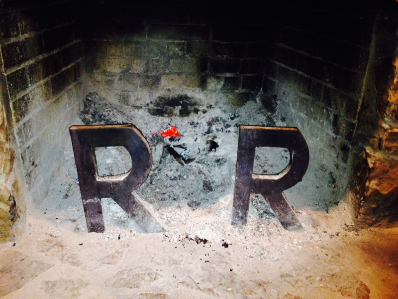

Fire dogs I made 5 years ago. I'm surprised how well they look. These folks use fireplace as sole heat and they keep it rolling.
It's all 1", torch cut. 7018 welds.

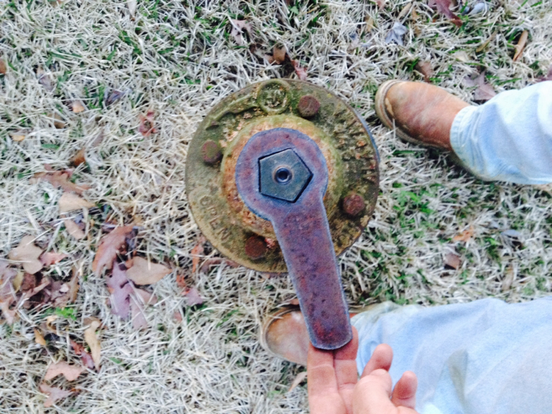

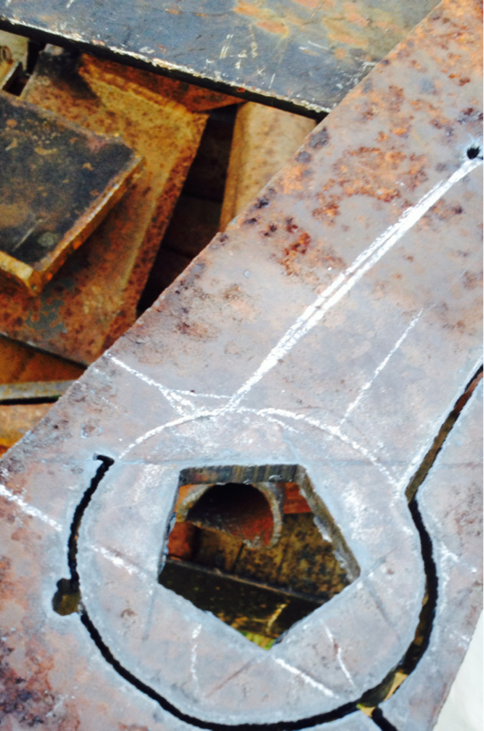

Made a fire hydrant wrench today. image-1128884200.jpg Just scrap 1/4" Victor torch No grinding done Pentagons are more difficult to layout than I expected???
