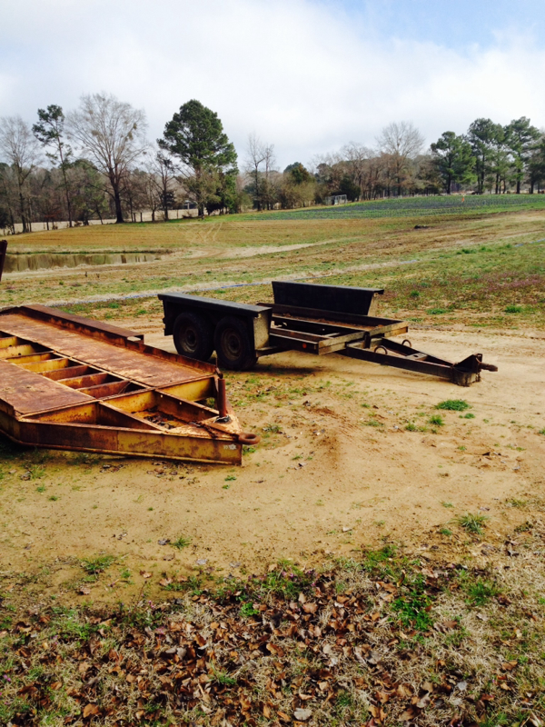

The trailer in question is the black one.
Paid and gone. Yep that's an f150. No, that's not the heaviest thing he hauls.

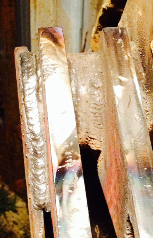

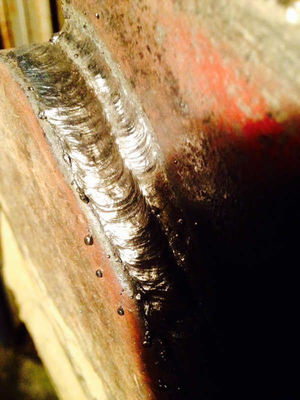

Finger nailing is when the coating burns off uneven. Sometimes it's because of bad rods. I made a scarifier out of a heavy 12" H beam. I beveled the beam (like a cutting edge) and then welded backhoe teeth shanks on. I welded all around the shanks with 3/16" 7018. To weld the back of the adapters inside the H beam was a little tricky. I had to bend the rod to fit between the 2 flanges and then had to have the rod almost vertical down because the web was in the way at the back. I struck an arc and then transferred the arc to the shank and kind of let gravity pull the weld down to the beam. It was a blind weld as I couldn't see the puddle. Experience gave me a good idea on how the weld was progressing. It's hard to explain it but you basically get the flux to burn off on an angle. If you just had the arc on the beam, you wouldn't get much weld on the shank. It's easy enough to practice this type of weld though. Put a small piece of plate on top of another plate and see if you can get a nice fillet weld with the rod almost vertical.

Thank you ArcWeld.

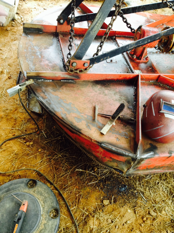

See what I mean about walking puddle over to bucket. The quarters were tight and the blind beads were not the best looking. So...
There better not have been any undercut! ;)
Next victim... Patch it up and back to thicket. Overhaul later after he does all the damage.
This guy has been a good customer over the past few years. He is rough on his stuff but believes in servicing.
