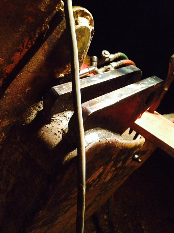

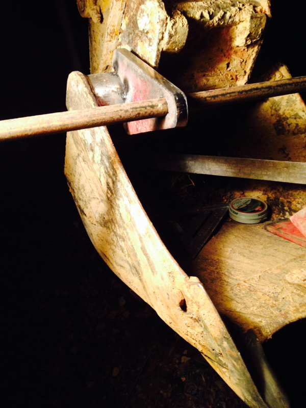

Guy wants to add a subsoiler shank to a little hoe bucket. Had really no idea how to do it. Hope it works.

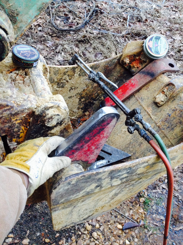

3/4" plate cut with torch
Fits pretty good. More to follow.

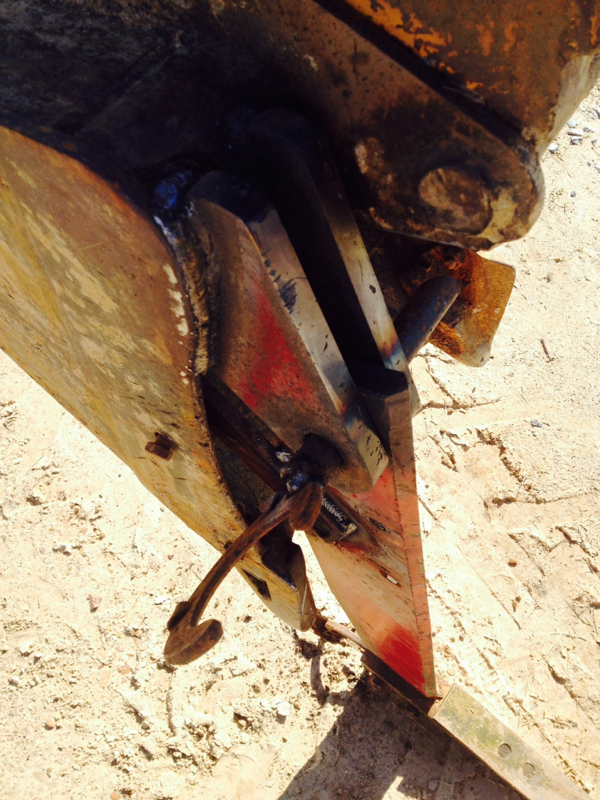

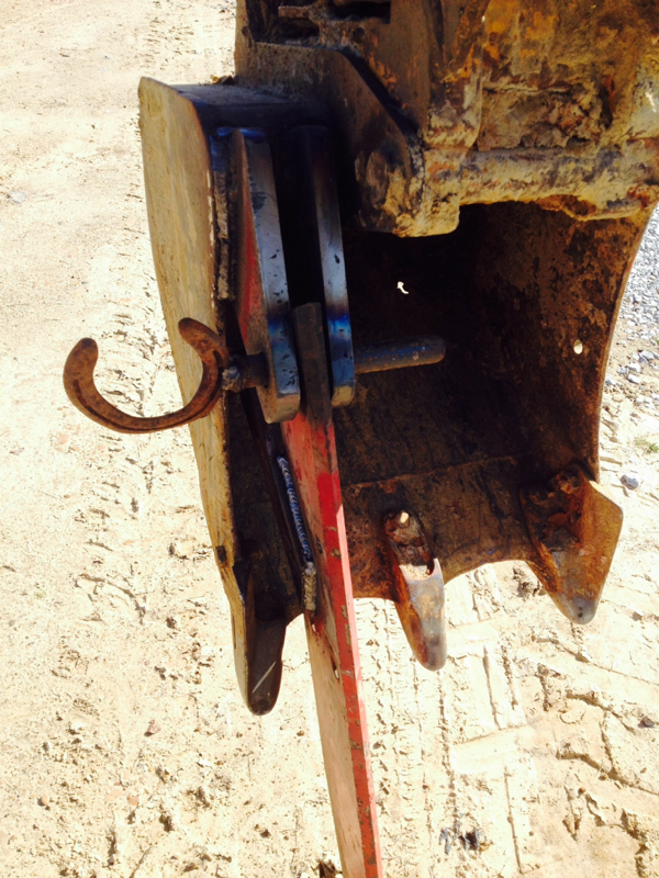

Well... The idea is do rip a narrow trench to run water hook ups across our county roads. The roads are mostly slag paved. County will let him dig them up but he is trying to minimize the ditch. I finished this morning. It has a ring at bottom to hook pipe to pull in trench. I did not have a grade 8 bolt to mount the brace to the bucket. I hope it works.

OK, now I get it. This is why my 7" bucket is so handy, even though it does gum up a bit if the soil is wet, it makes a narrow enough trench that is easy to backfill and compact.

All the welds were done with 225 ac Lincoln, 6011 and 6013. I enjoyed the project. The machine was a rental unit. I used it this past summer when he bought it. Bucket and machine look rough but hydraulics are smooth and strong. The trailer that hauls it might pay my light bill this month! :) it is in sad shape.

6013? It looks like you got lots of weld on the bucket but not as much on the mounts.

Arc weld- I used 6011 and 6013. I might have more on the bucket. It was tight quarters trying to get the rod in position and I walked the puddle over to that side. It was a good 5/16" gap from tab to bucket.

I like the horseshoe on the pin, I bet that makes it easy to pull it out :)

Yep the horseshoe is a pretty handy to weld on stuff- handles, hooks, gate latches... It's not just for ponies anymore!

That's where experience comes in. I never use 6013, especially for something under stress but with 7018 you can purposely get the rod to fingernail when it's not possible to have the normal rod angle. This still lets you get an equal size fillet. It takes some practice to do but there are lots of times when welds are in tight quarters where you have to think outside the box. It looks like you might have some undercut on the brackets too where a crack could start.

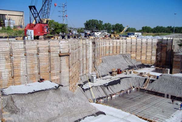

For about 5-years I worked building tie back systems. Some of the walls we had to weld bolts / all thread / coil rod to the soldier piles to secure the wood lagging. When the carpenter types would tighten the nuts down sometimes the bolts would break off. Well they weren't going to remove the lagging so a weldor could reach in and re-weld the bolt.
