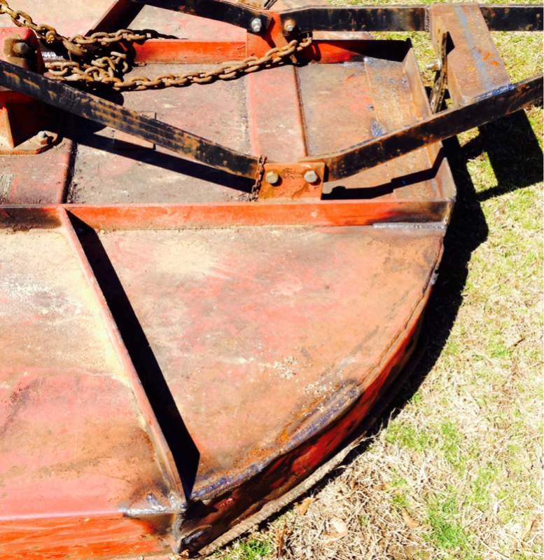

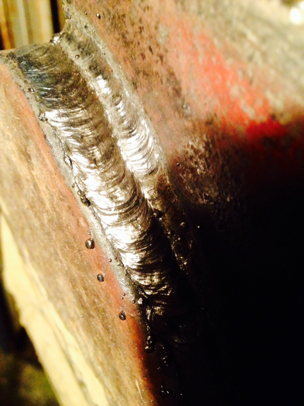

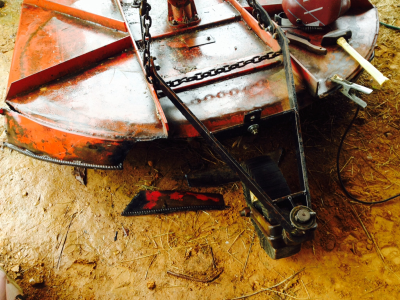

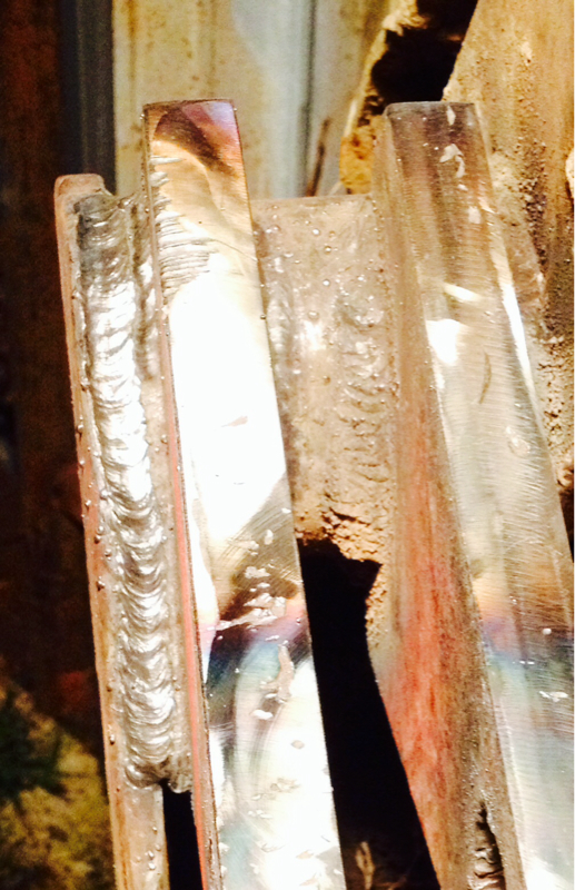

See what I mean about walking puddle over to bucket. The quarters were tight and the blind beads were not the best looking. So...
There better not have been any undercut! ;)
Next victim... Patch it up and back to thicket. Overhaul later after he does all the damage.
This guy has been a good customer over the past few years. He is rough on his stuff but believes in servicing.
