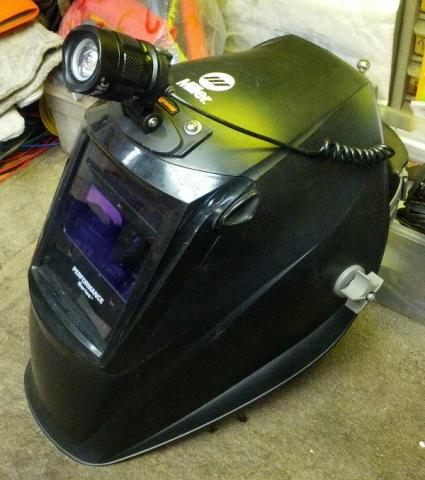

Flood a lot of ambient light on area to weld, actually putting headlight on helmet helps....
