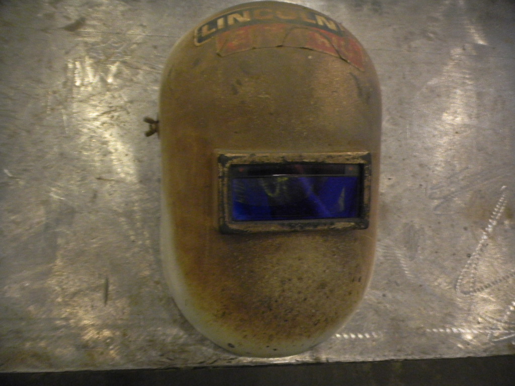

I gotta learn to keep my face out of the smoke! :laughing:
