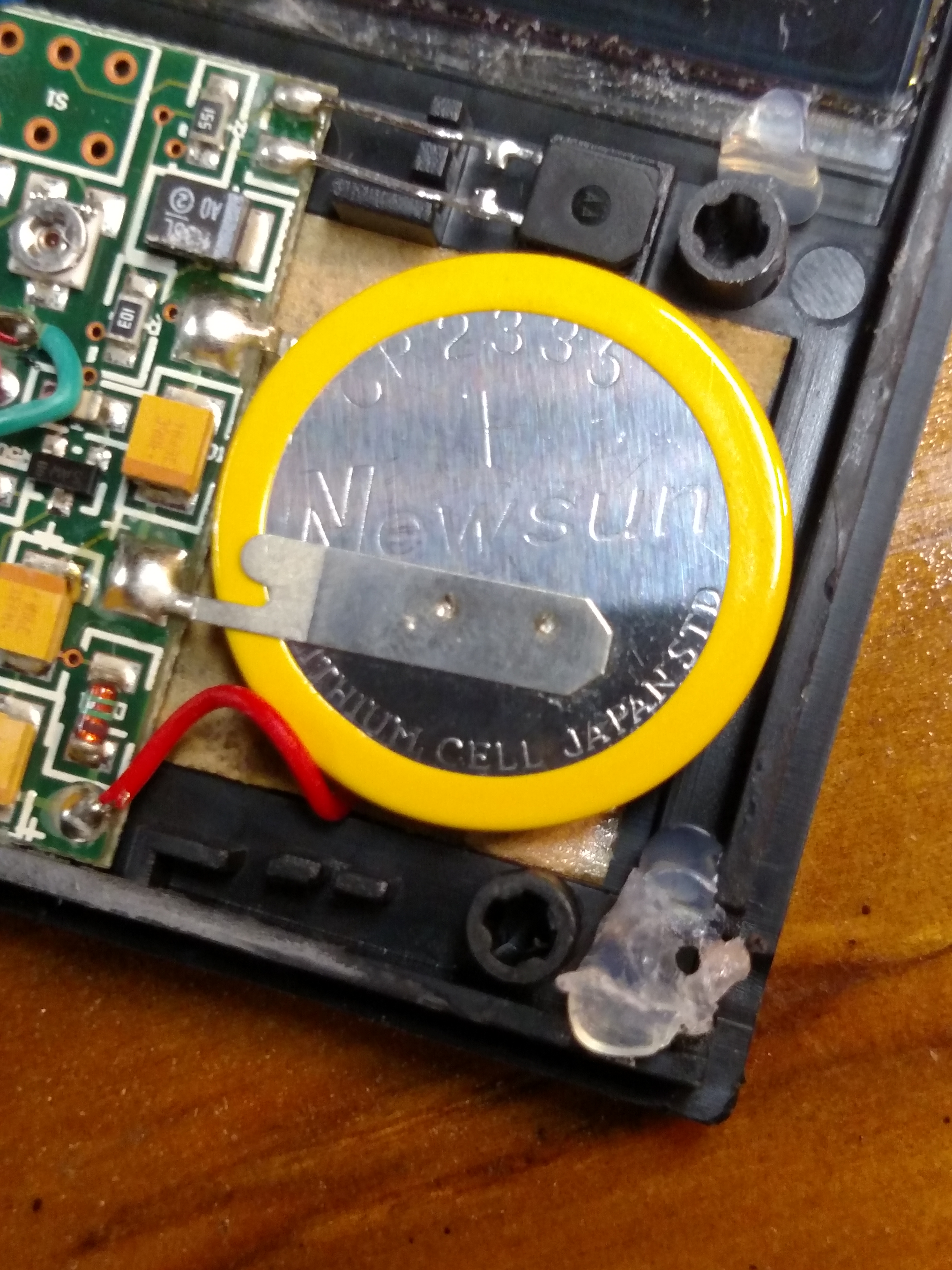

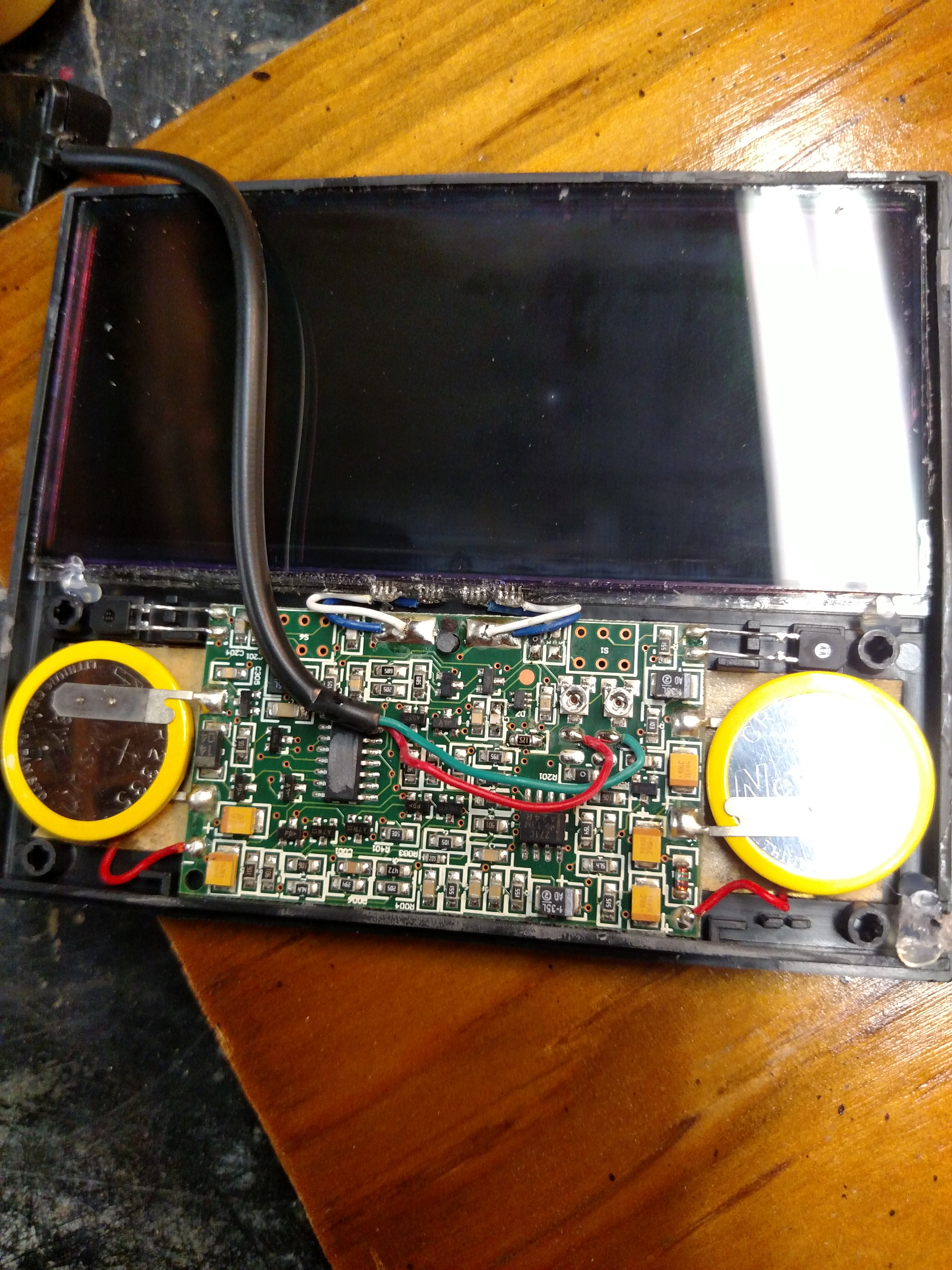

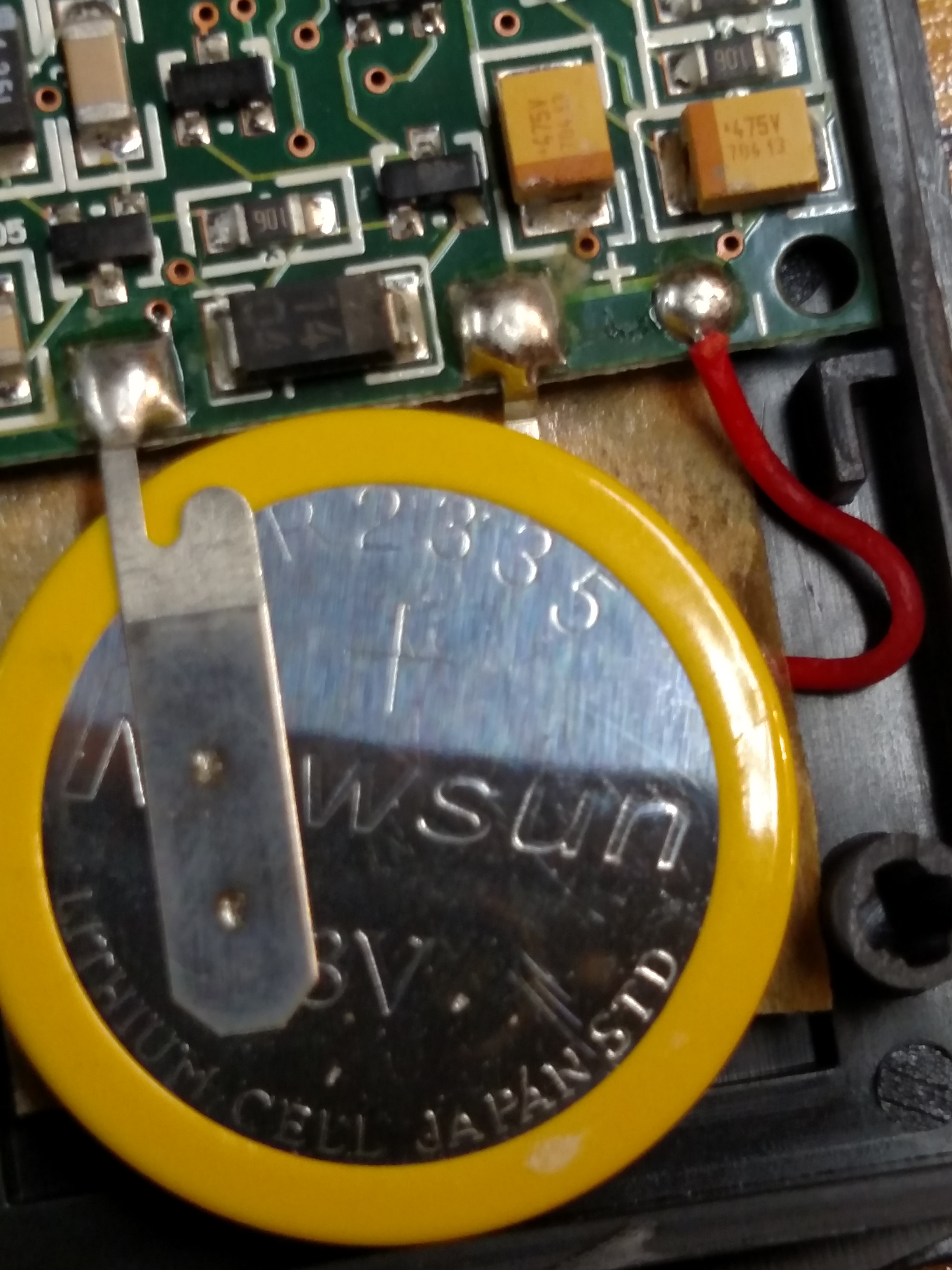

My Northern tool welding helmet has not been used in over a year and stored in the dark. So I take it out to use it and guess what? It doesnt darken any longer. No amount of leaving it in the sun is going to fix it as the solar assist is just that an assist to make the life of the two CR2335 lithium button cells last longer.. After I got the module out of the helmet and pried apart with my Spyderco knife (no easy task), Naturally they are solder in (not that I can't handle that, but really now much would it have cost to put in some simple holders and a couple of CR2032 which are available everywhere?.. Don't you just love engineers and bean counters?... " fix it so we can save 3 yen on every helmet Mr. Miyagi" jeez.. Now I have to hunt for the batteries and install them.. More to follow.

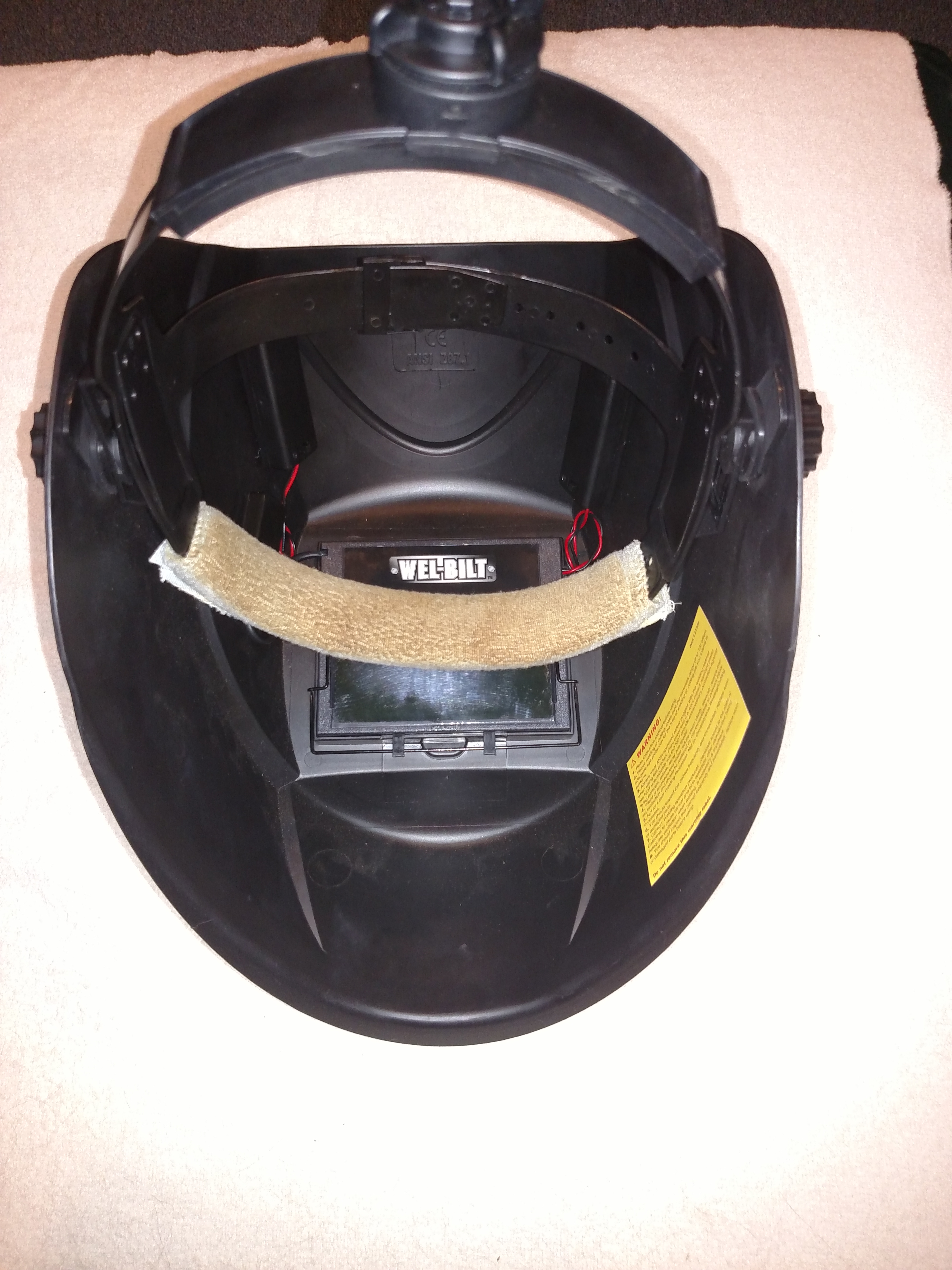

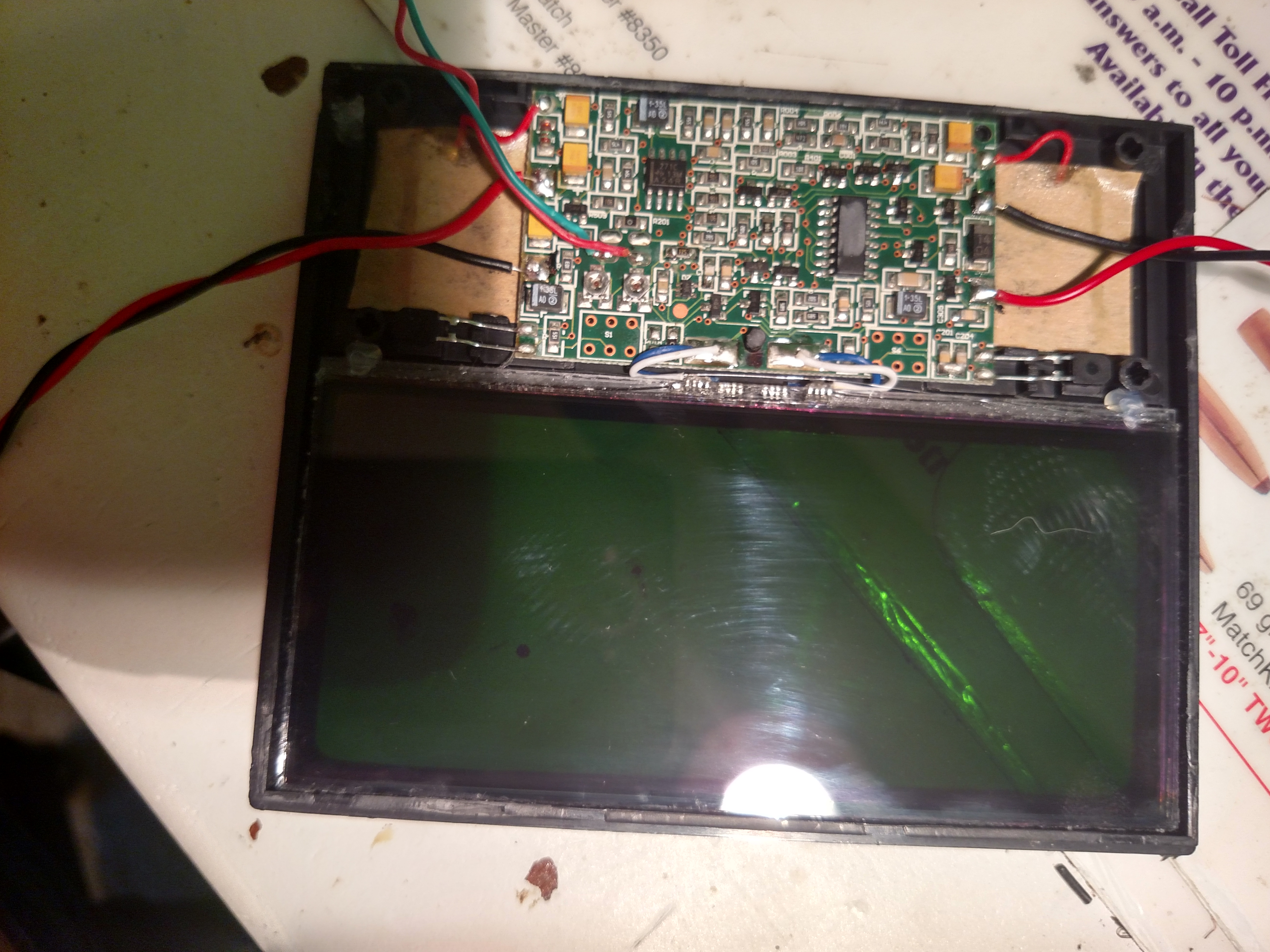

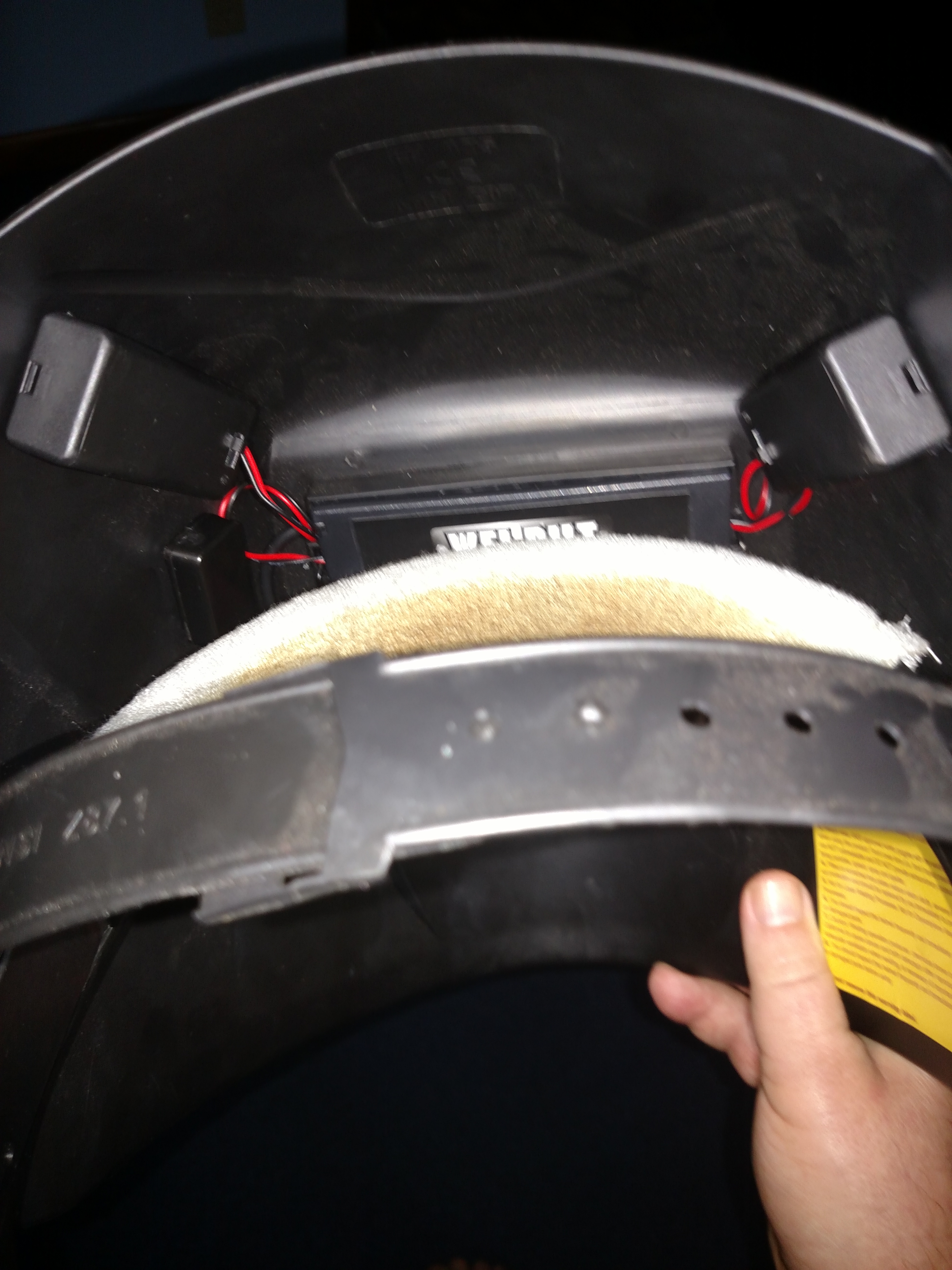

Okay Dokey, it is repaired. The two coin cells were dead. I installed two of the above twin AAA holders (with switches) into the helmet. The supplied tail wires were soldered in place of the coin cells, and notches made into the sides of the module to pass thru the wires. Four little tacks with the hot soldering iron in the corners to hold the module shut. Then install the module back into the helmet body and hot glued the AAA holders into the helmet body after roughing up the plastic on both pieces. Here are pics. Total cost to repair about $7 and I still have 3 of the battery holders left over. So I could repair 1 1/2 more helmets!:laughing: Total time about 30 minutes.

Thanks. It was very easy to do. And now it uses AAA batteries you can buy anywhere, and replace them in seconds.

I bet you could connect the button battery holders together in parallel and feed them both with one battery pack. The unit draws very little power considering it had button cells and the AAA batts have much more capacity than the button cells. Less weight and less clutter in the helmet.
