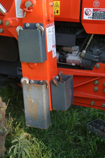

Where's that photo JRP? I'm tired of carrying my chain in a plastic bucket by my left foot. /forums/images/graemlins/smile.gif
   / welding chain links on bucket and loader arms #22
Sorry /forums/images/graemlins/mad.gifHere is the pic. The computer hung up before I finished typing.
To mount these I drilled and tapped the FEL frame and used fine thread bolts that don't stick through.
   / welding chain links on bucket and loader arms #23
Thanks JRP. Never thought of mounting a box there! Probably the best place on my tractor as well.

I haven't tried it, but seems anything bulky(engine block, stump etc) would be impossible to raise if you could even get the object off the ground withou it hanging up under tractor. My arms end about a foot from front end. I just can't picture hooks on loader arms being much use.
