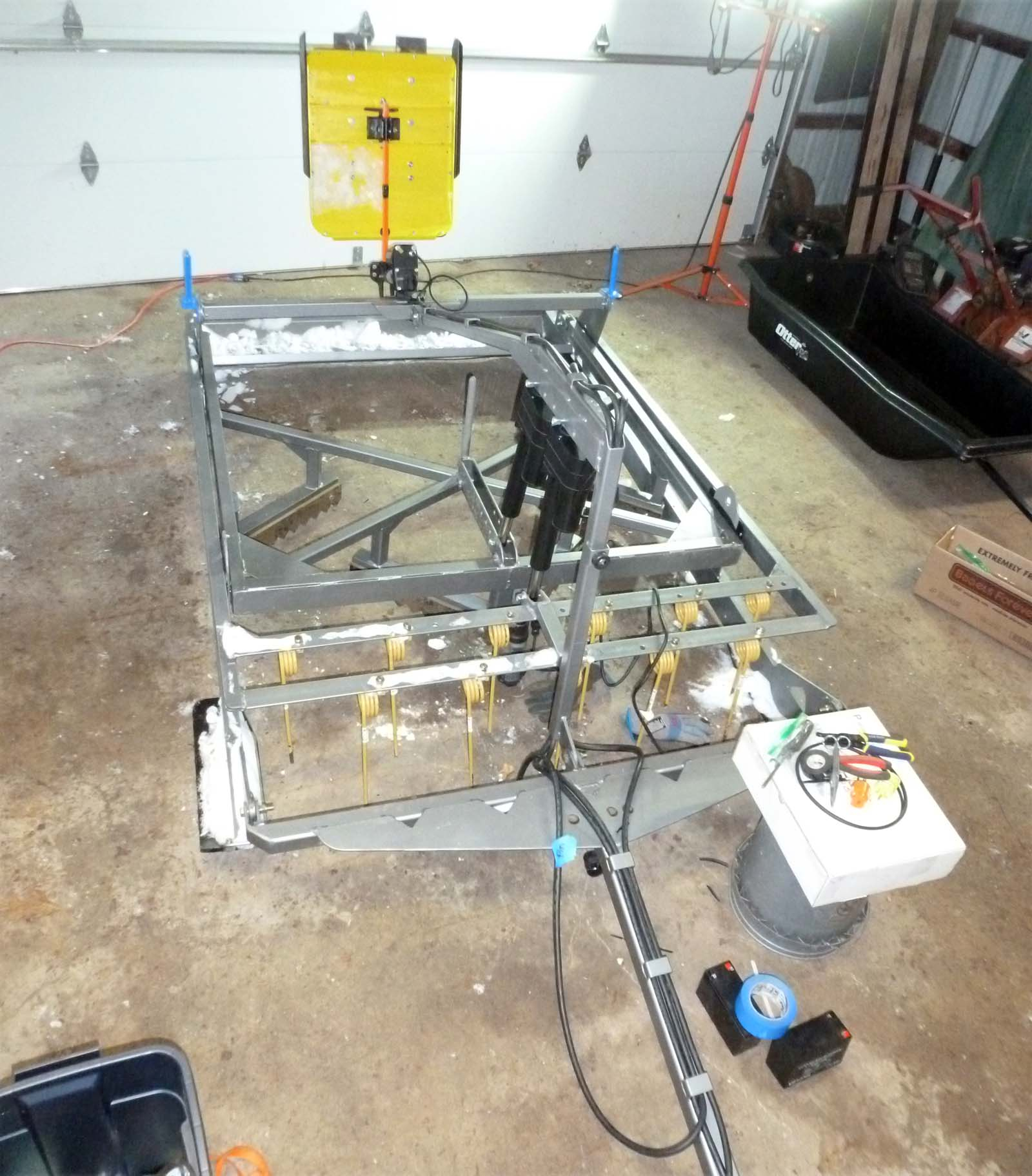

I'll add a hook of sorts to hang it on the garage wall when not in use. Garage shop is only used in summer. Seem PVC coating should would fine in this application. I do use and love SOOW wire on my snow implements. Seen here is a box of it.
Hey Arly, I dint read this whole thread, so apologize if you already said it, but....what is that thing? I see dethatcher tines, but pretty sure that ain't a dethatcher.
/ welding carts #177
guess you could cut it up !!! and make a welding cart out of that thing
then take some wires out if a mobile home from a trailer park and run
some 110/220 off of the cart with the mobile home wires ,, then you welding
cart could be complete
