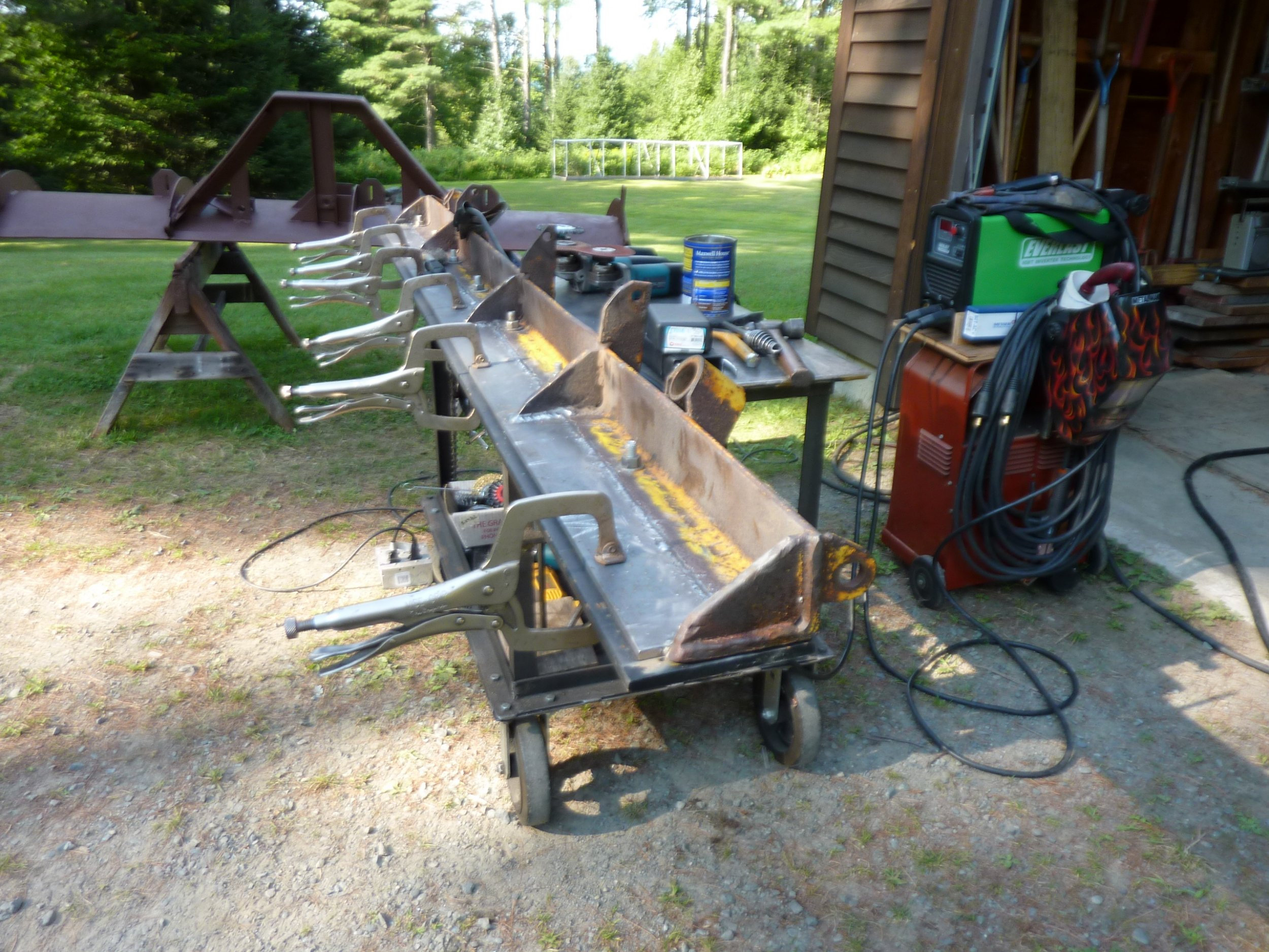

What are you making there?
I got an old snow plow. The guy said I could have it if I took it off an F150 he wanted to restore. It was kind of bent up and worn. First I straightened the mold board.
This is the trip edge.
I managed to straighten it out too.
The cutting edge was worn down all the way down to the gussets so I cut some more off so I could weld in a new piece with the gussets across the joint.
Turned it into this
Probably more than you wanted to know :)
gg
/ welding carts #183
Besides the yellow tracked portable straighening rig, I see a red welding cart with pneumatic tires and plywood base.
